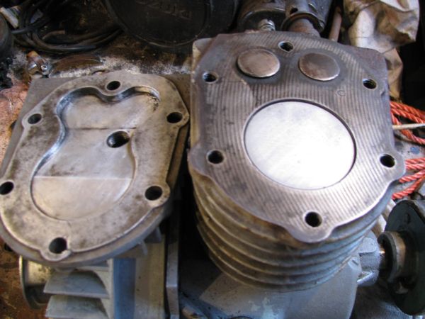

I've taken the head off the engine and cleaned up with degreaser and fine wet and dry...

thats true and some of these engines you have to grind the valve stem to get clearance after re lapping seatsIf the valves are leaking will that cause the pooofs.
I think it might be valves. Just need to search you tube for how to split the engine to remove and lap valves then how to measure clearances.I ended up fitting an external condensor, that perked the spark up no end.
Also stripping and cleaning the carb. I noteiced with my thumb over the plug hole there didn't fell like there was much compresstion so I lapped the valves and and checked the clearances. After that it runs sweetly.

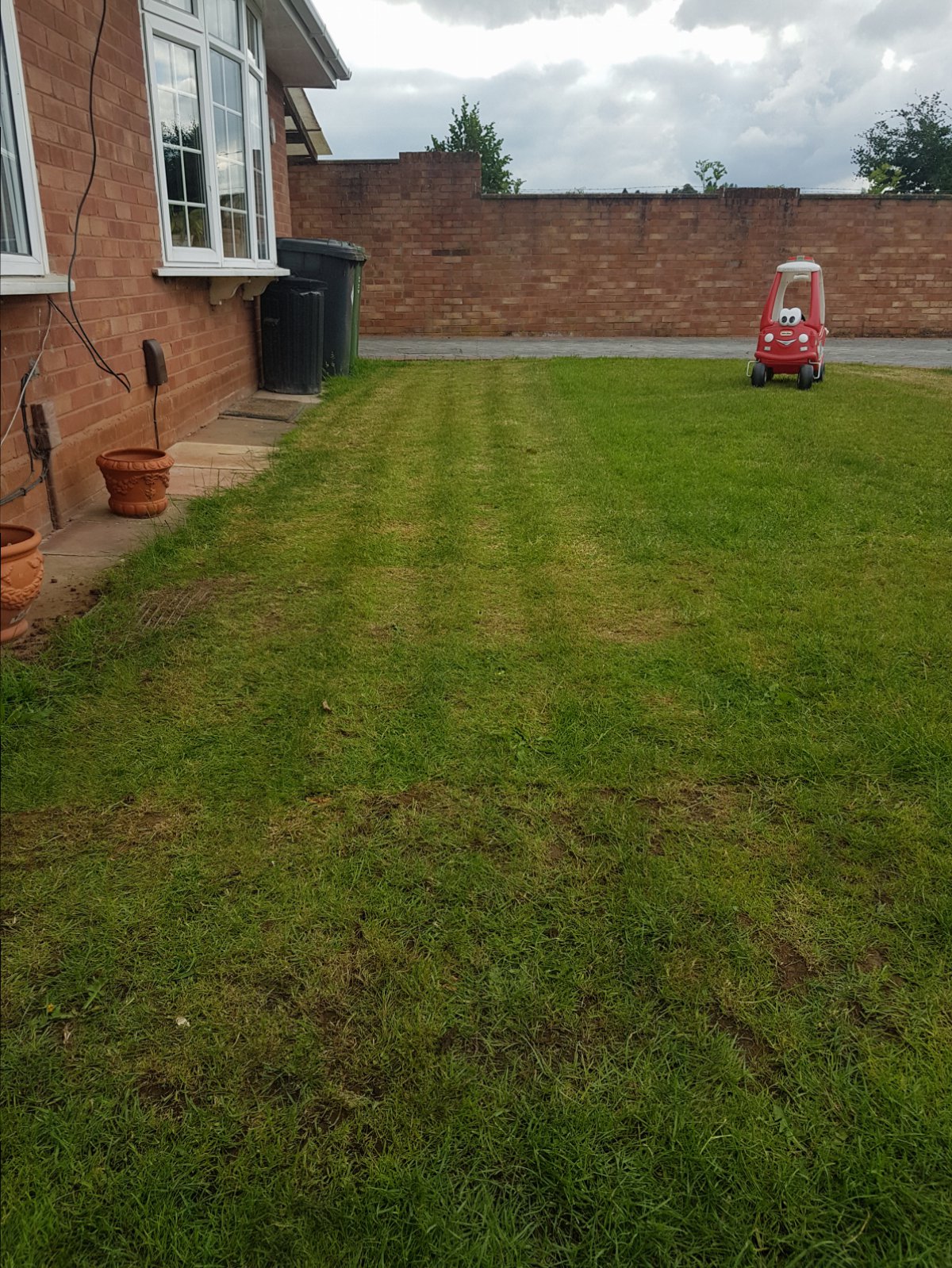

It seems to cut both sides but not in the middle.
Or the bottom blade is bent from having a stick/stone caught at some point.
