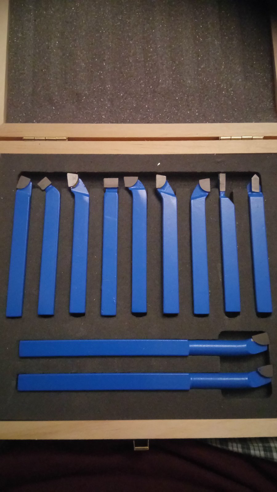

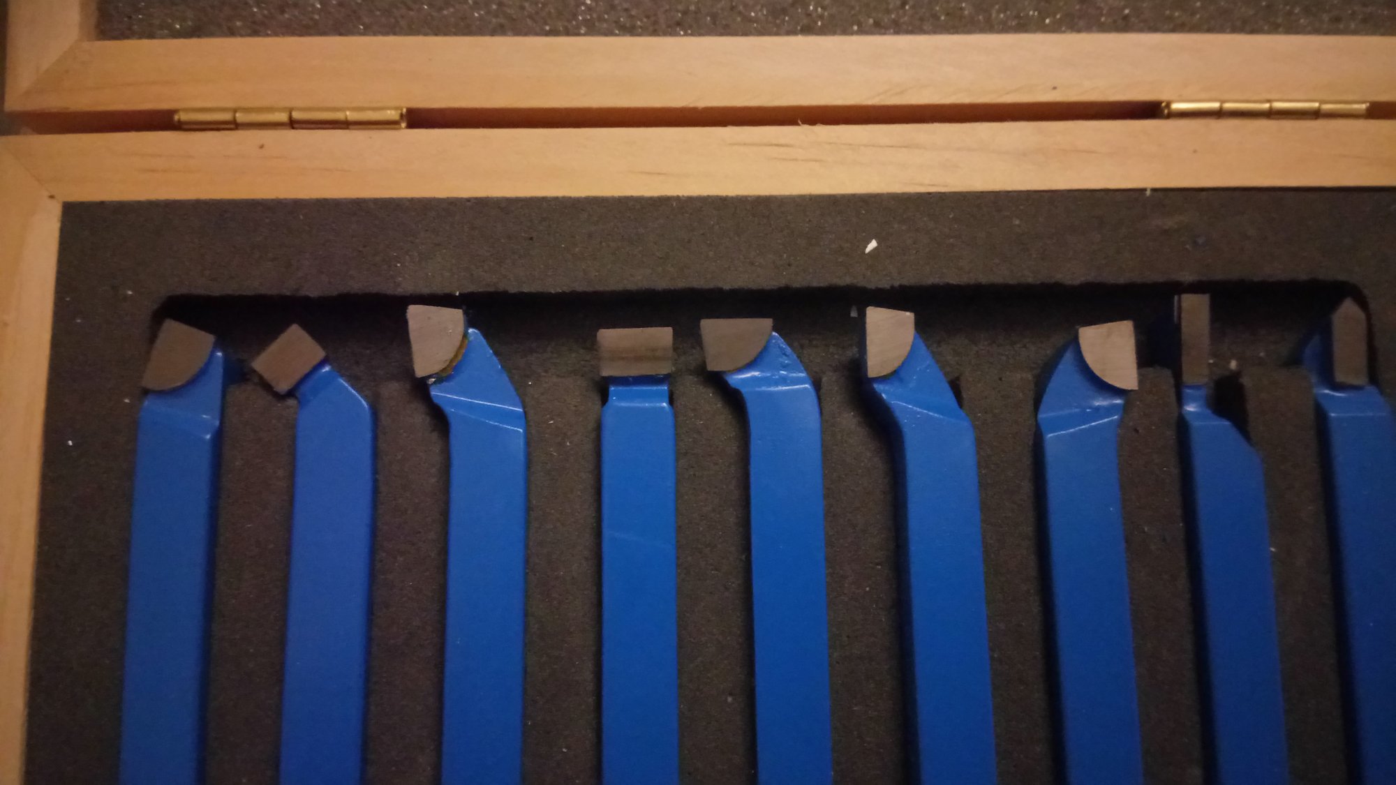

Looking at the one on the far right I am thinking it may not be a threading tool after all as it seems to be closer to 90 degrees rather than 60 (or 55 for Whit threadforms).

i have to agree with Screwdriver the brazed tipped carbide tools are rubbish on mini lathes.
The normal stone for grinding carbide is silicon carbide, the green wheels.Its more that the grind on the brazed tips are rubbish, and not many people have/want to use a cheap diamond wheel to sharpen them.
