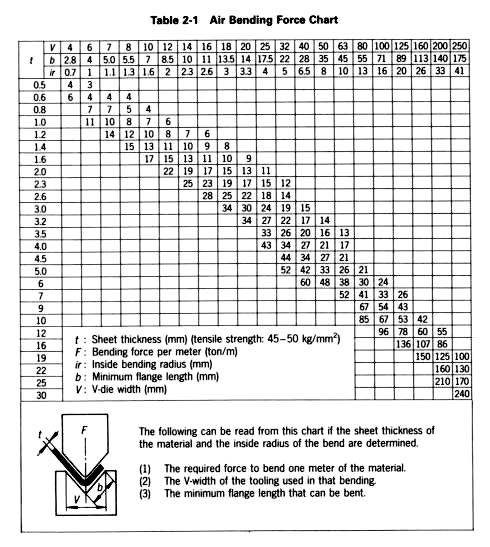

I feel the need for a hydraulic press, my needs are to press the odd wheel bearing and to bend the odd bit of 15mm thick flat bar up to 100mm wide. As this is not something I have any experience of can anyone point me in the right direction as to what tonnage I require and what to look out for.
