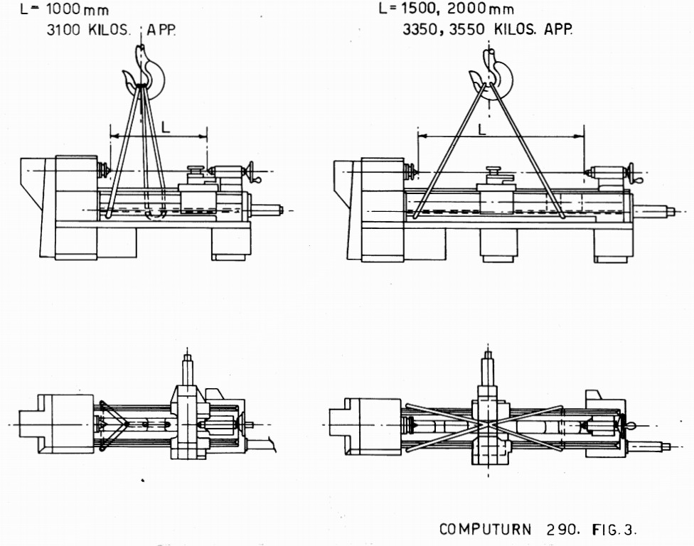

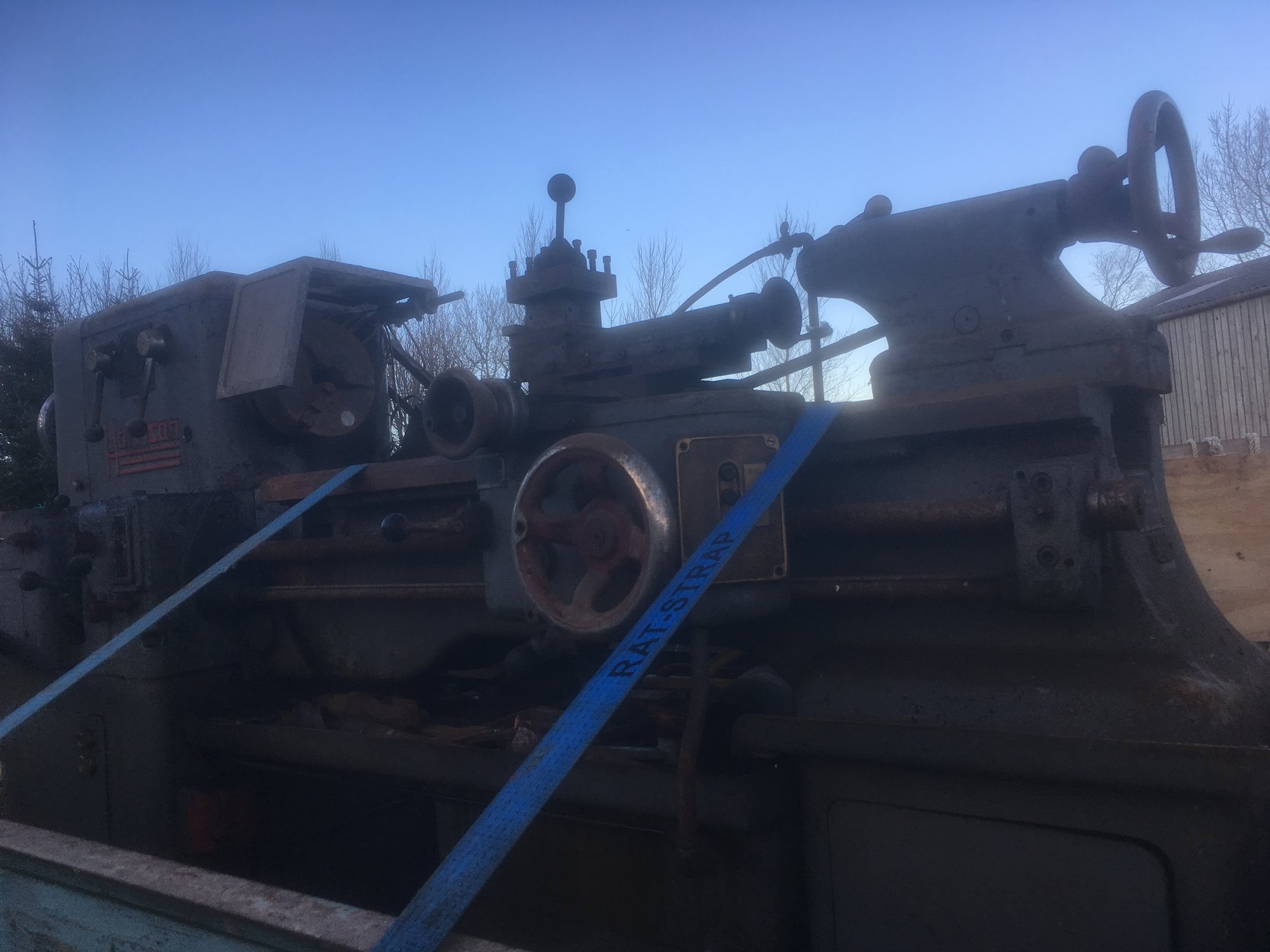

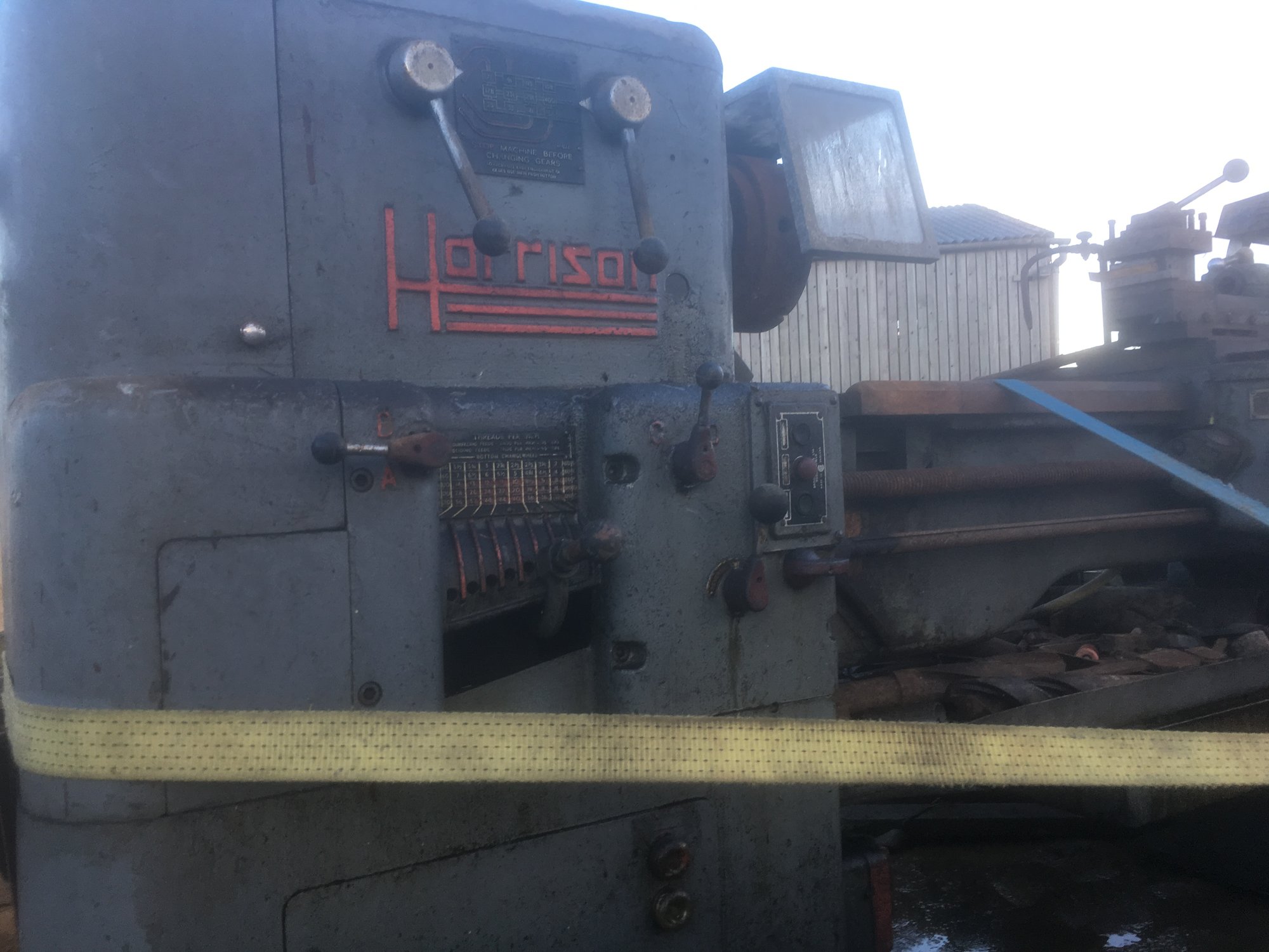

Well another thread from me as a task may be on the horizon, I may have to lift one of these:
Now, as I have an L5 I know about the two holes in the cabinet to pass bars through but this bigger 16" beast doesn't appear to have anything like it, and is basically a very different construction.
According to the lathes website it will weigh a minimum of 1.5t (if it's the longer bed model which I suspect it could be then it'll naturally be more), I'm thinking a strap under the bed at each end?
Not a job I look forward to, and not one I wish to mess up...
