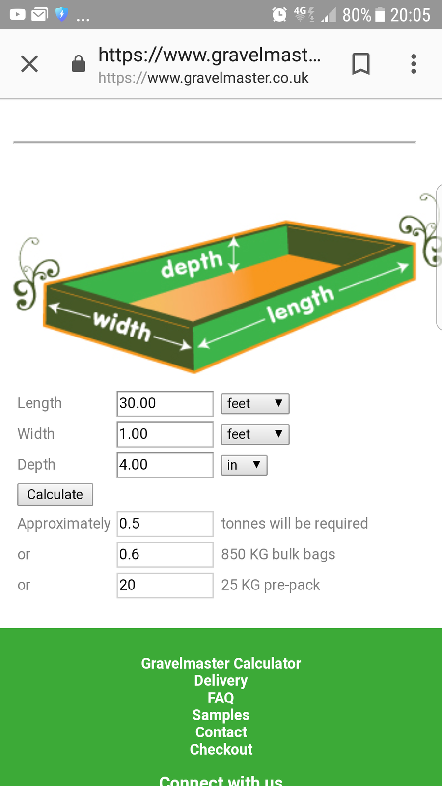

That sounds like a half bag....a full size cube bag is just under a cubic metre where i live and they weigh just short of a ton..ask my Cabstars rear springsA dumpy bag holds .42 cubic metres,
they are 750mm cubed, I did this by measuring, the bags that came from the local builders merchants
they maybe were 900mm cubed at one time though, not any more though.
I recall from a long time ago, a yard of gravel is about 25 cwt, a cubic metre would be quite a bit more. No wonder the springs protest ...... or perhaps gravels got lighter!That sounds like a half bag....a full size cube bag is just under a cubic metre where i live and they weigh just short of a ton..ask my Cabstars rear springs
