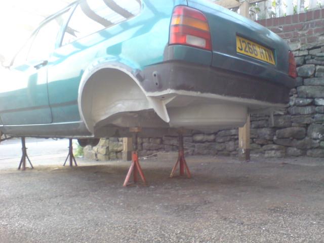

I do appreciate this is a bit of "how long is a piece of string question" just wanted to see how others had found the product several years down the line.
Sadly I haven't had access to blast cleaning and as such it's mechanical abrasion combined with citric acid to the underside of the car. I've done my best to remove as much rust from as possible, it looks clean but I can't guarantee I've managed to remove 100% from the pits.
Jotun 87 was applied when the steel was in a good clean state to the naked eye. Plan is to overcoat the Jotun with top coat, possibly Raptor. Car is stored outside, only driven in the dry.
Anybody car to comment?
