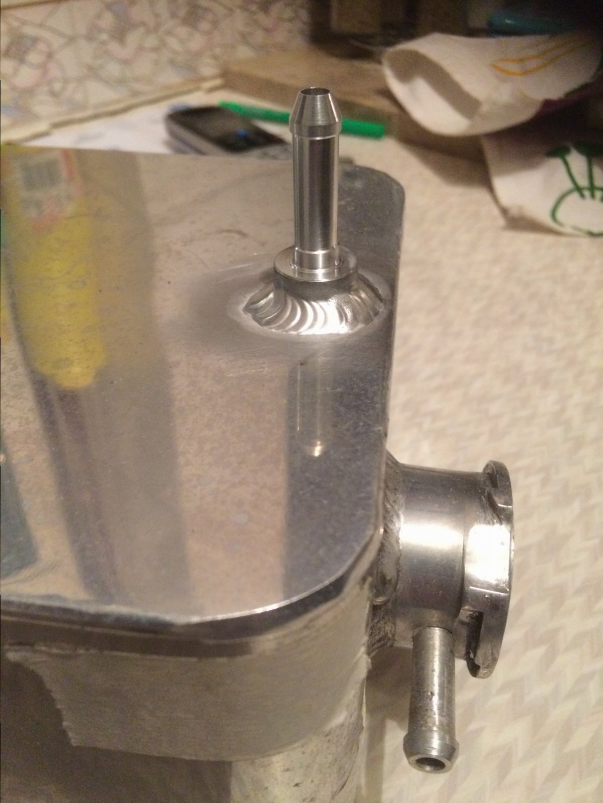

Very good, I am looking forward to seeing how you welded them on, it will make a nice tutorial.It's Alu and it's quite soft. You need some thickness there really and a nice long taper on the barb is best. I think the bores will flow nicely so I'm going to leave them as they are but its gonna be very easy for you to run down them with a bigger drill bit should you think differently.
