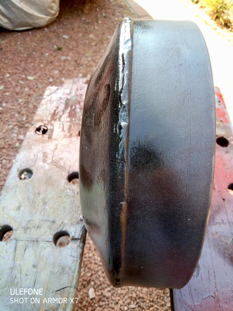

W Wildefalcon Member Messages 1,910 Location Gloucestershire, England Sep 18, 2023 #43 Standard 10" drums (genuine, original swb): OD is 10.75" ish. ID is, well, 10". Brake contact width is 2 1/8" Offset from mounting flange to start of brake width is 1 1/8" Aperture is 4 1/2" Max of hub 8 1/8" Standard 11" drums: 11 1/2 11 2 1/2 1/2 4 1/2 9 1/2 I can measure some stage 1v8 and some 101 one tonne, just not yet.
