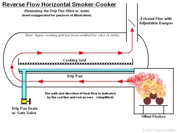

Ok I am about to start this project out of 1x47kg propane cylinder and 2 L size O2 cylinders
I have got a design in mind but just wondered if any of you had experience in smokers
