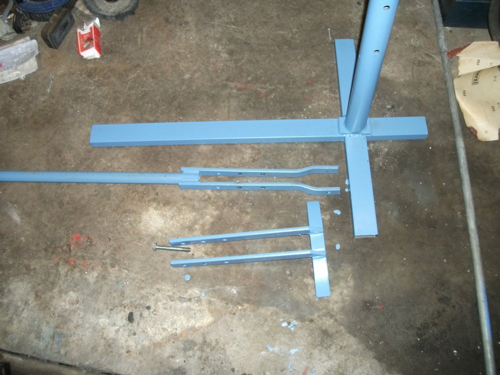

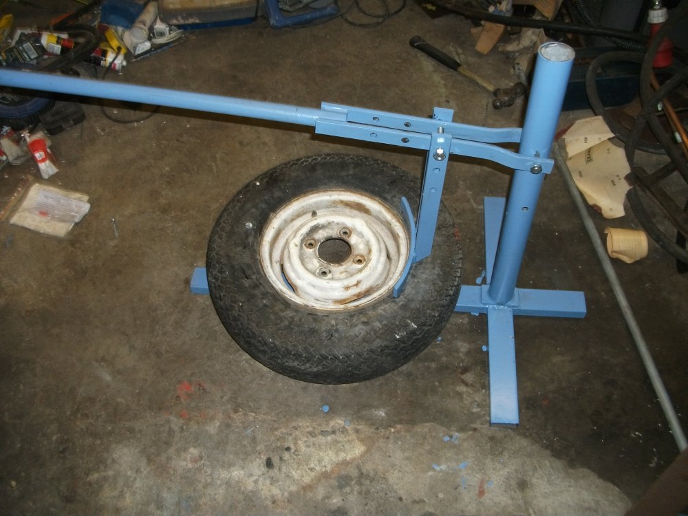

getting fedup of paying for punctures and -having to pay for getting tires off trailers ect to paint knocked this no frills or no spills one up in a couple of nights. I didn't realy have any measurments for one so drilled extra holes in the parts so its adjustable was bang on 1s time and works a treat with no effort to break beads just shotblasted -a -mini wheel and primed for painting it cost 12 quid to make from scrap available-
