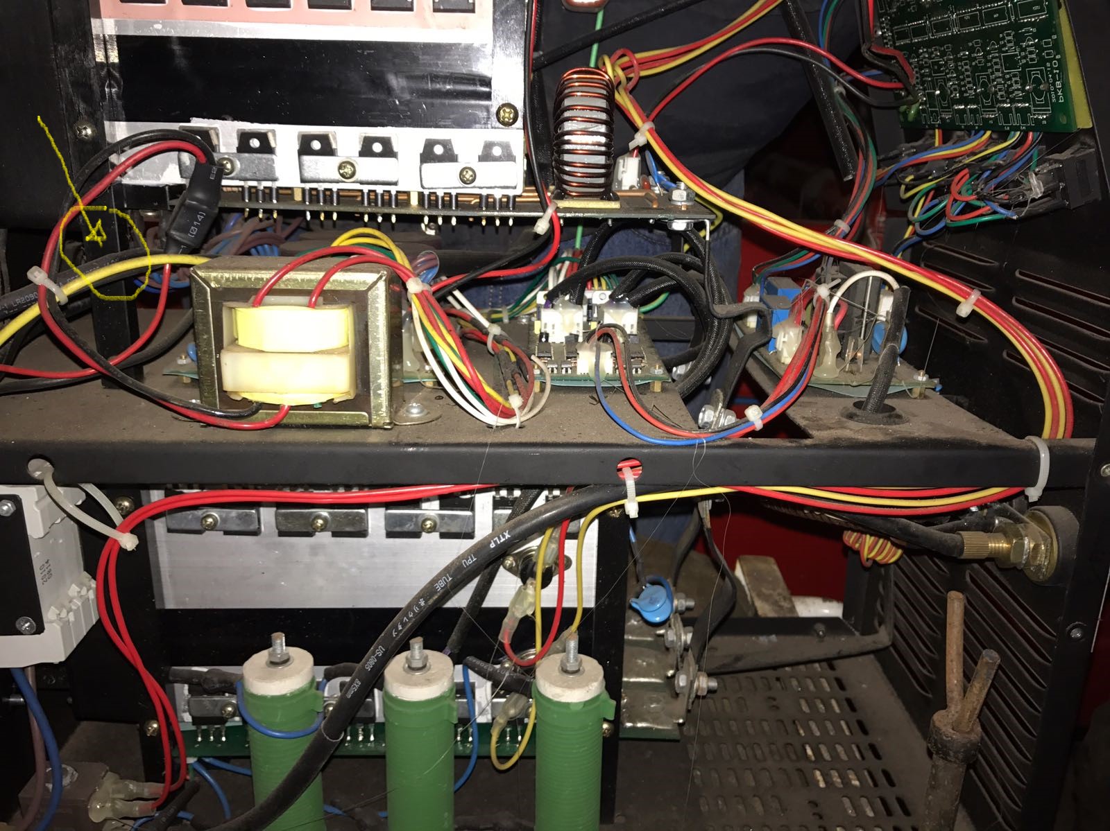

Hi I bought a Cobel tig ac/dc 200 for 30 quid in an industrial auction, looks like the same one as you have. Took it home and plugged with a plug in RCD for safety and tried to get some welding current with a tig torch and the fans came on but nothing else.
Took the cover off and I can see straight away that two power leads coming from the switches at the back are hanging free which starts to explain why the fans work but thats it. I've marked the wires that are free in my welder ones with a yellow arrow in a copy of your original picture on the left hand side.
Could somebody help me with where they plug into? Its not obvious where they should go to me.
