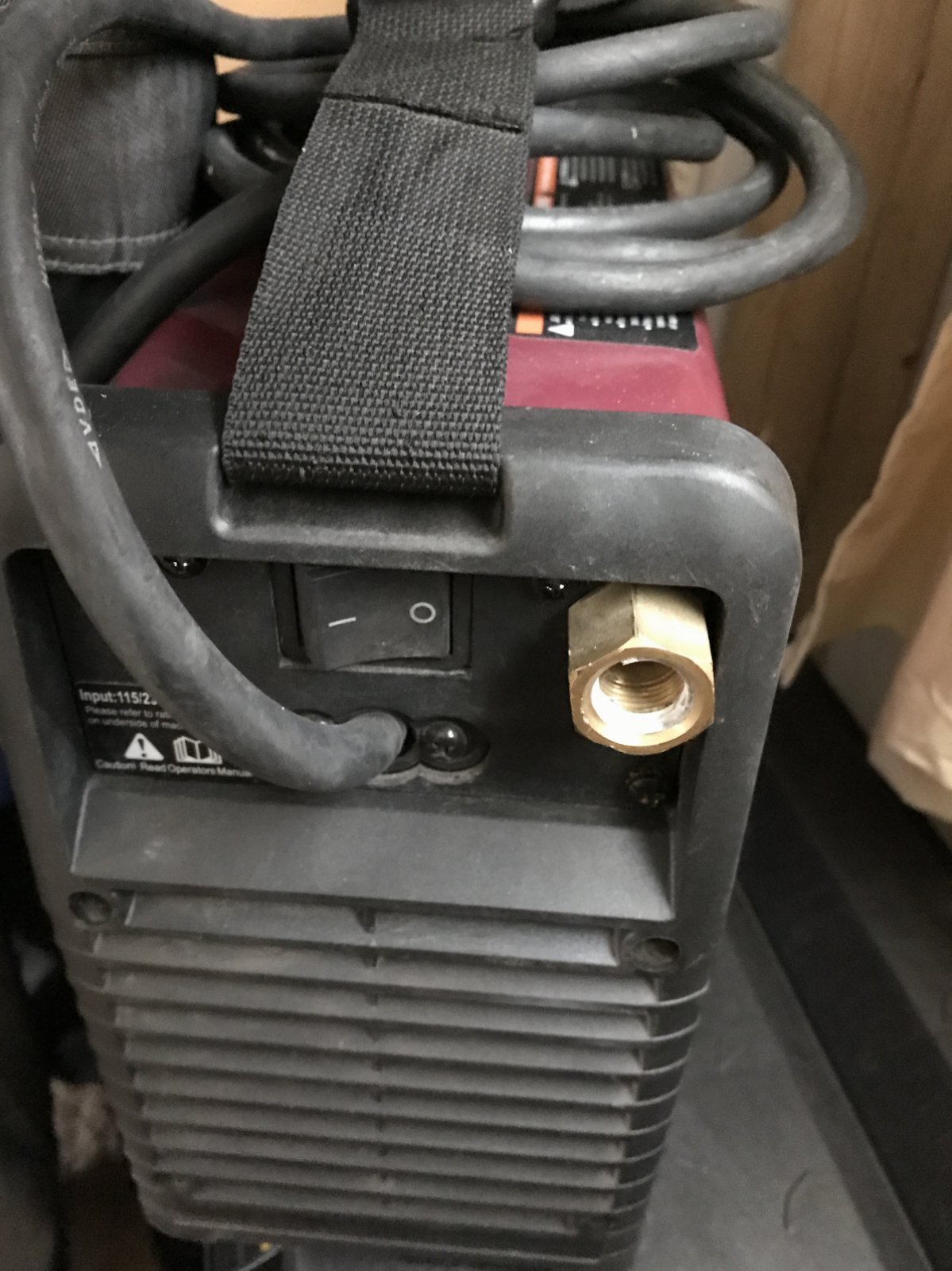

F124nny Member Messages 230 Location Warrington Jun 8, 2017 #1 what size is the argon inlet on a thermal arc 201ts 3/8 rings a bell but could be 1/4.
Richard. Member Messages 18,347 Location Cambridgeshire Jun 8, 2017 #2 Pic please. Think it's female 3/8bsp on both the back and front.
F124nny Member Messages 230 Location Warrington Jun 9, 2017 #3 I'm sure it's 3/8 just making sure before I order a quick release
gordon stephenson Member Messages 7,448 Location Skelton in Cleveland U.K. Jun 9, 2017 #4 Looks like 3/8' ( going by the rule of "thumb" ) Measure the male thread o/d, to confirm. 3/8" will be 0.656 or just over 5/8" dia.

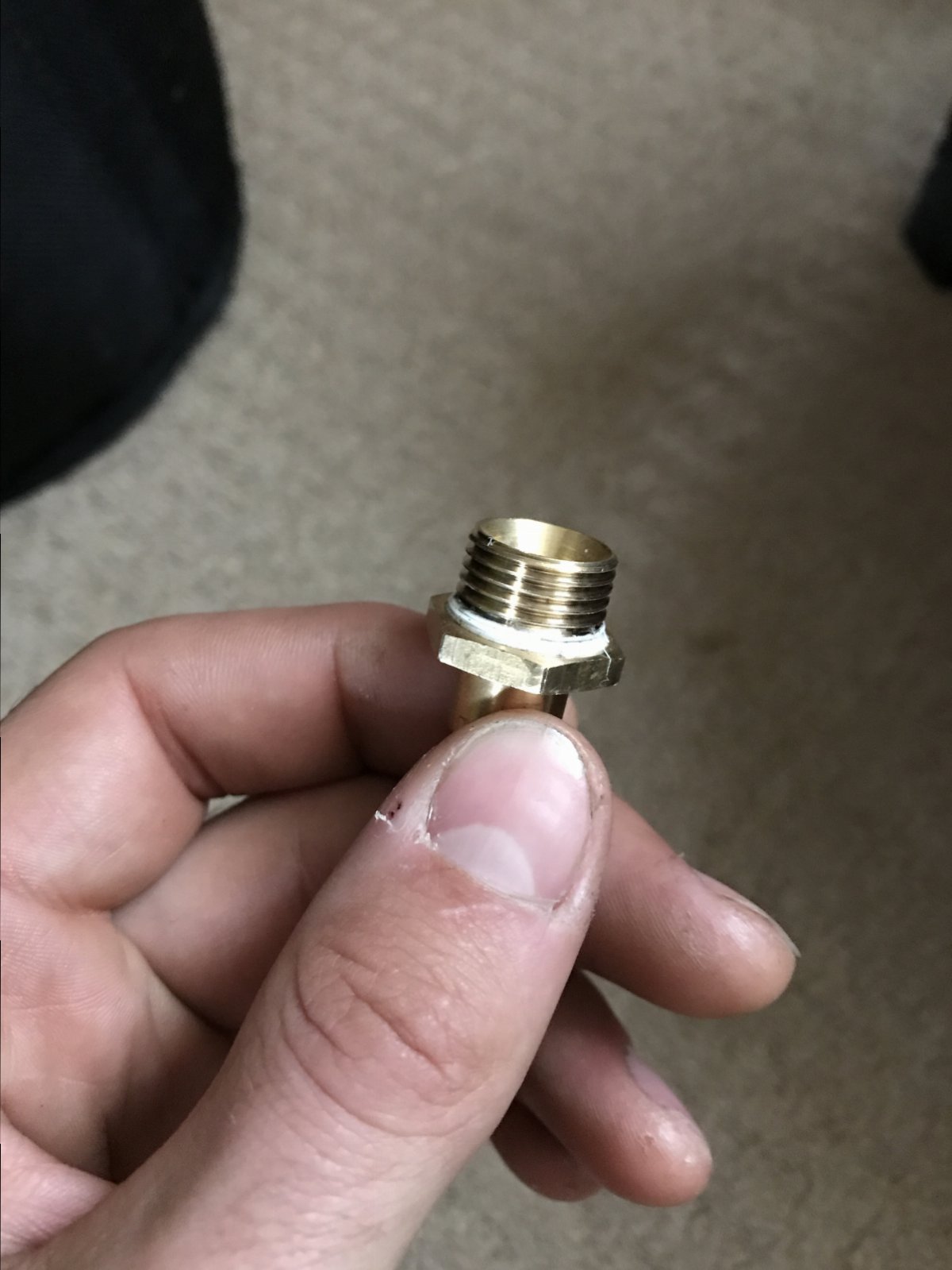

F124nny Member Messages 230 Location Warrington Jun 9, 2017 #5 Iv tried it In a 3/8 fitting at our supplier. Where would you guys get a air quick release. Want it 3/5 to male and female to hose male cripped nipple
gordon stephenson Member Messages 7,448 Location Skelton in Cleveland U.K. Jun 9, 2017 #6 I use Rectus 21 fittings, Excellent items, I believe from ebay, firm called context? Just search ebay for rectus 21
