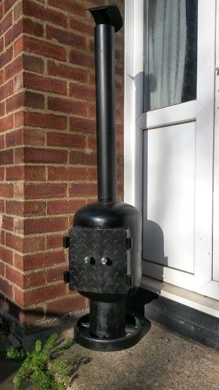

Use angle iron to make a door frame and use rope it's easier to get a better seal with a flat door. It's not the best picture to show what I mean but you should get the idea. The ropes glued on but I normally add some sheet metal tabs round the edge and tap them over the rope just make sure.
