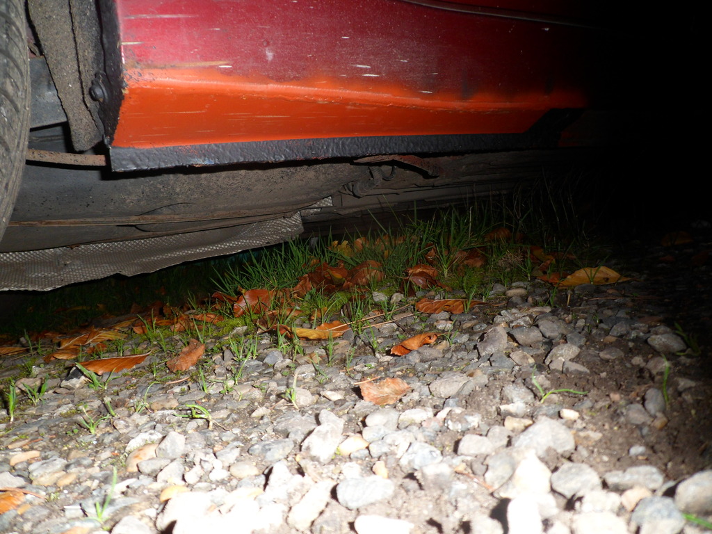

Looking at the pics below I'm assuming it's the usual "3 panel" arrangement of tuned down floor lip, inner sill then outer. I know I'm going to have some issues with the floor and inner sill lower edge. Wondering if best then to put the outer sill on first to have something to butt the floor and inner sill repair sections up to?

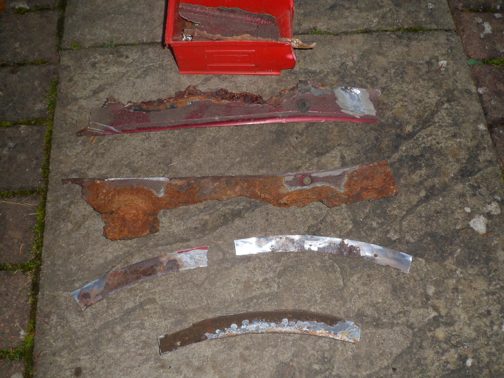

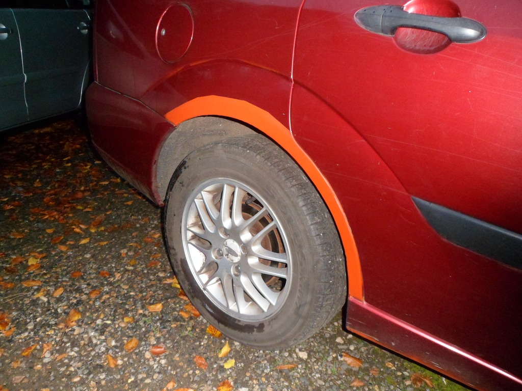

A while back I had some work done on both rear arches and the first 300mm or so going forward on the sills. (I wasn't in a position time wise or mentally to do it myself then). Just to scrape it through the MOT. It was new metal put in but tbh I should have taken out the God awful felt arch liners as they've undone a lot of the work. Really this needs doing again. Could be fun removing it as the repair sections were fully welded.
Back in 2015 then:
Some of the bits that came out:

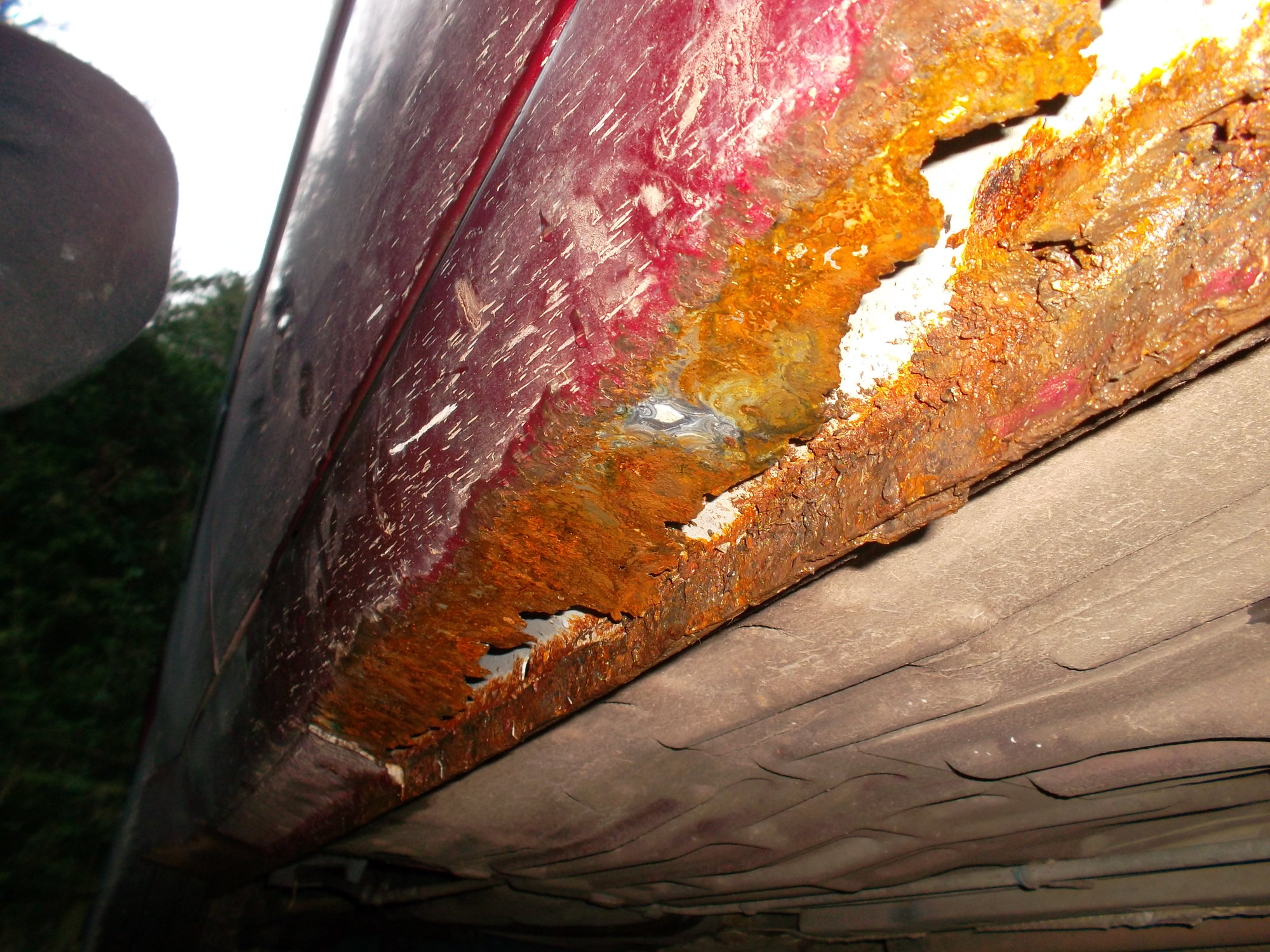

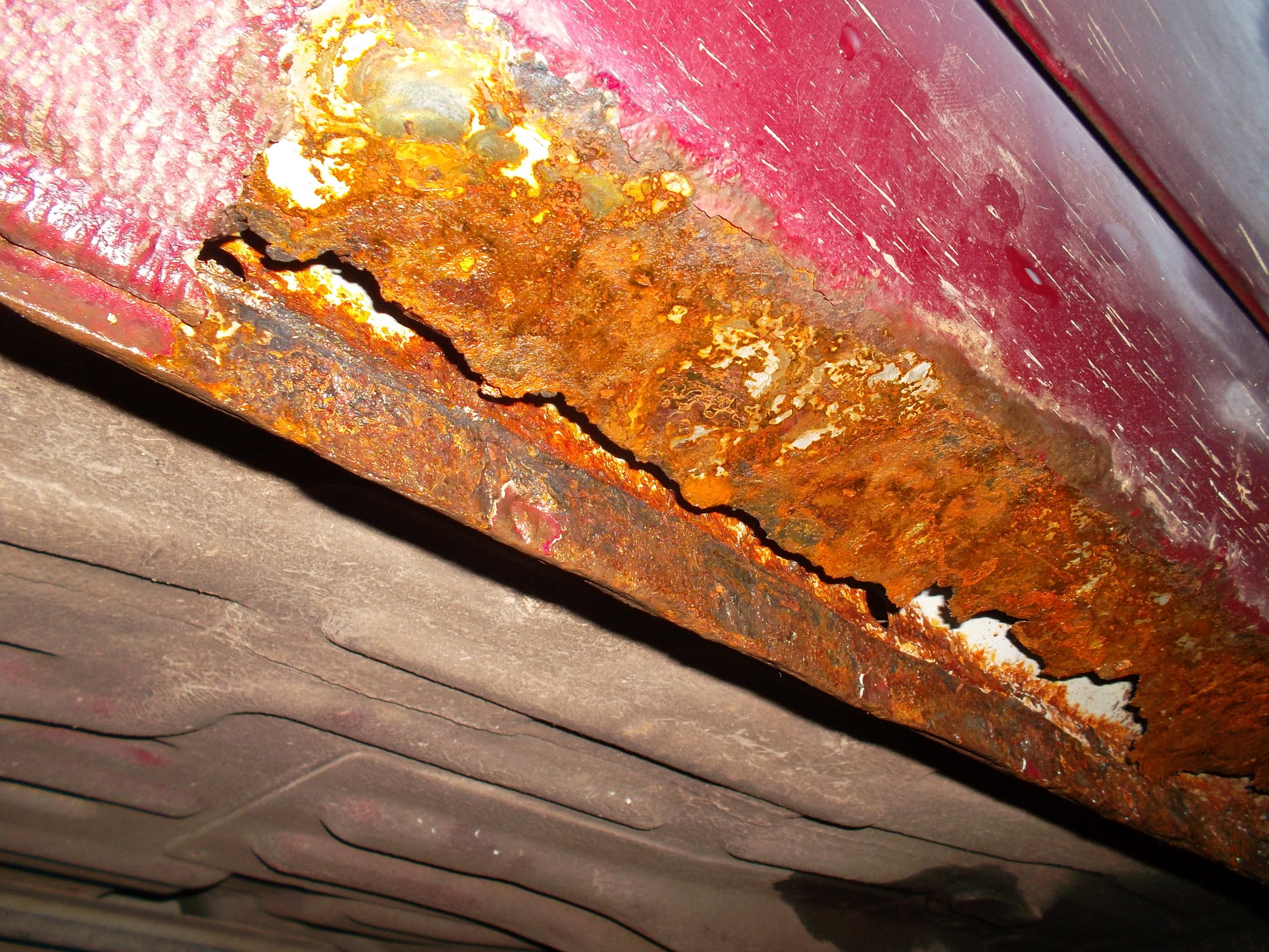

And now. I basically ripped off a whole length of underseal that was keeping everything together:
You can see where the new bit stopped:
Tbh I guess I won't know how bad it is until I start. The quicker I start the sooner I'll know!
