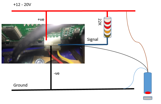

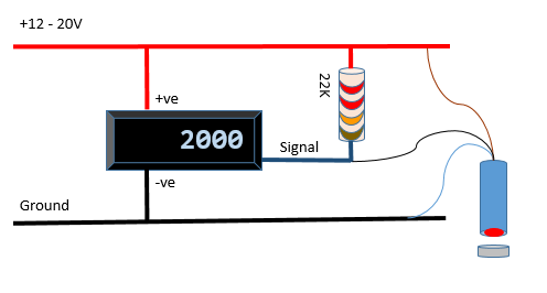

First - a schematic layout, for those of an electronic bent;

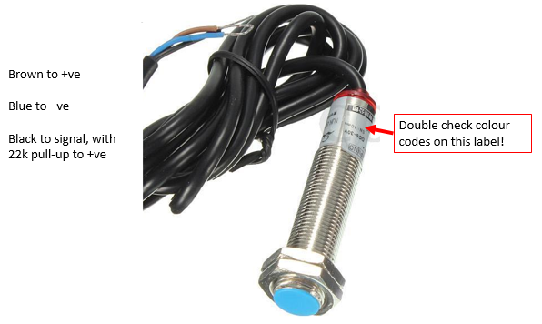

Note that the wire colours on the sensor were the same for both of mine, however both did have a tiny sticky label on them so double check what is written there to confirm the wiring;
The (bad) instructions suggested a 22k pull up resistor between the signal and the +ve supply. A little research suggests that the LED displays already have a pull-up resistor so, if you have one to hand, I would wire it in. If not then it certainly worked fine for me without them on the bench.
I wired them in, anyway, as I had some handy.

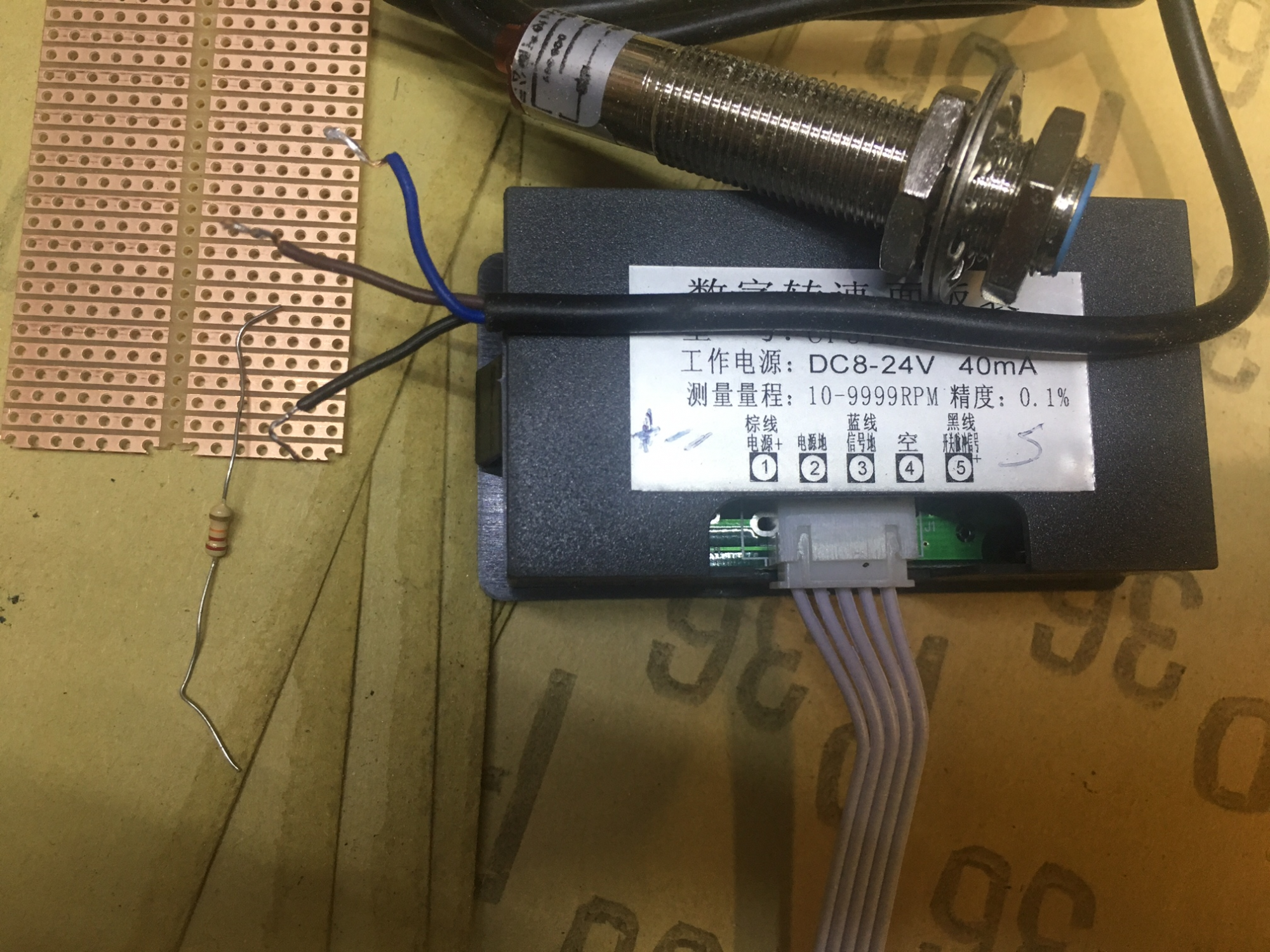

This is the first type of display, which has a 4 pin header at the back;
The board is clearly marked that the left most (red) is +ve, the next (black) is -ve and the right most (yellow) is the incoming signal.

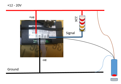

The other board had five pins and was more of a challenge as it was marked in Chinese!
Here, +ve is the left most, -ve is the next one and signal is the far right. In fact, the wiring is effectively the same as the other unit.
