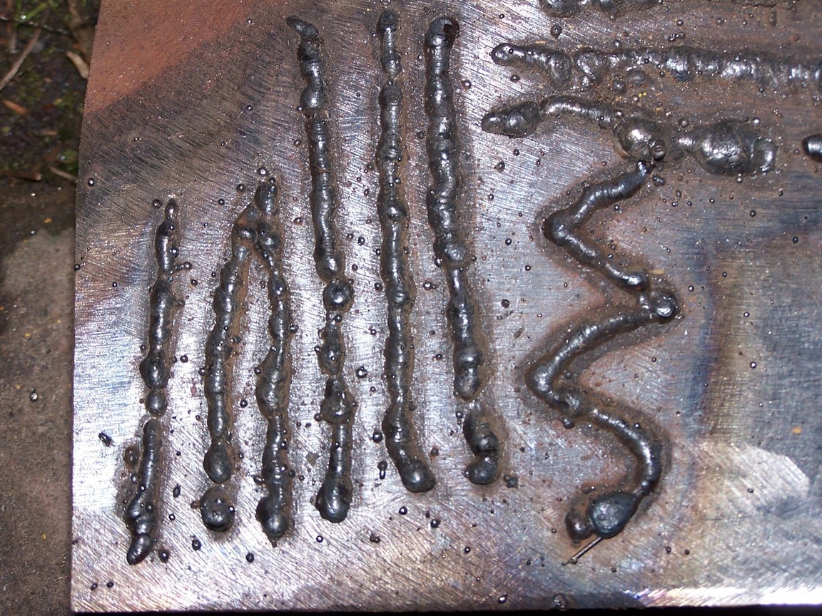

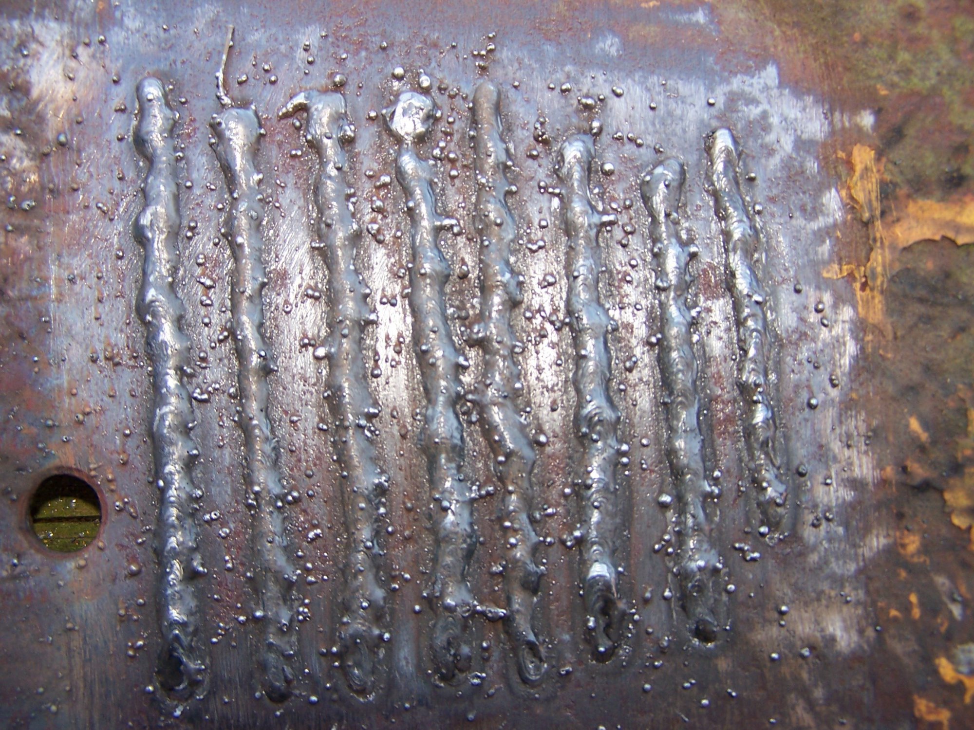

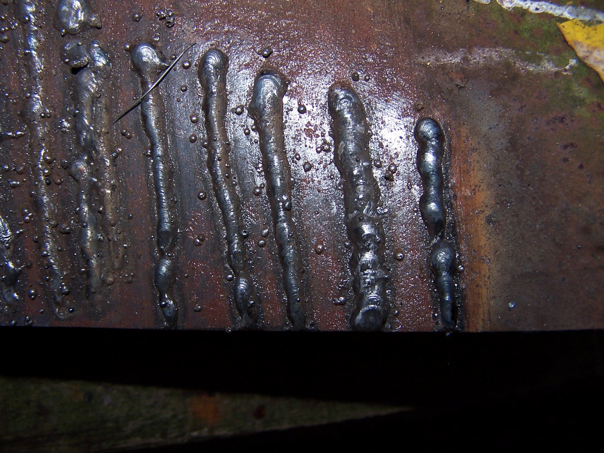

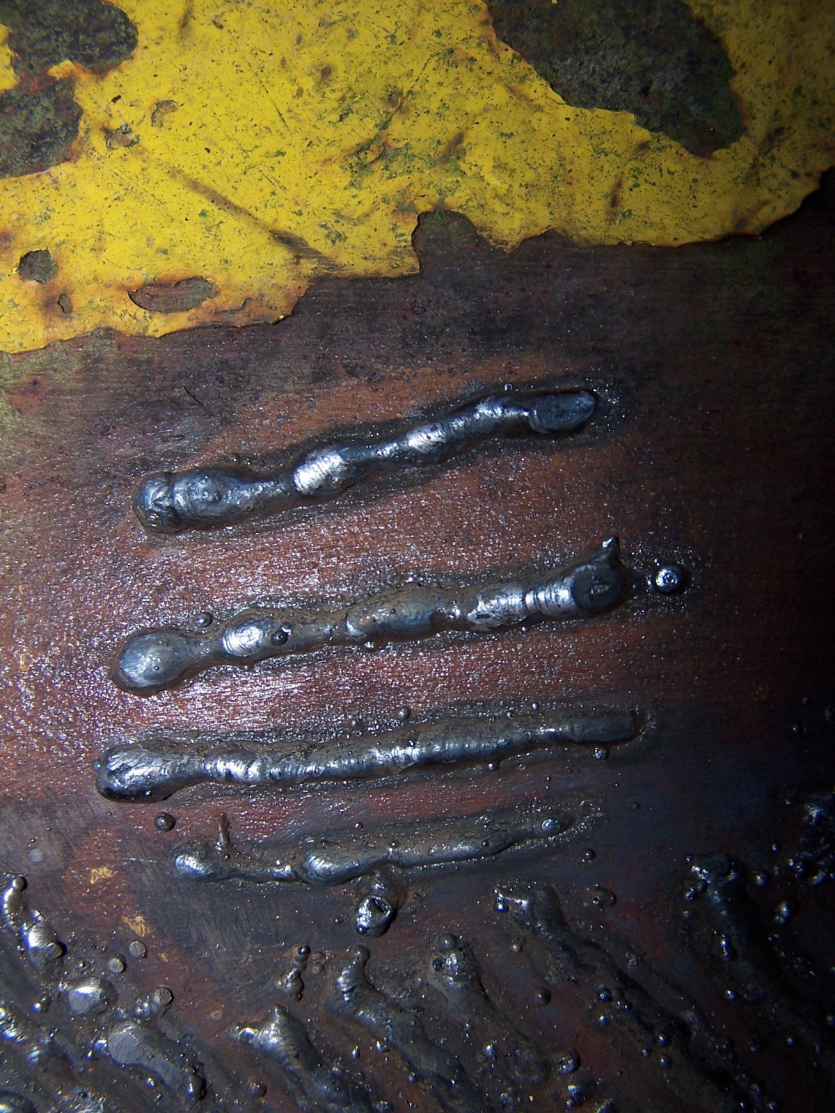

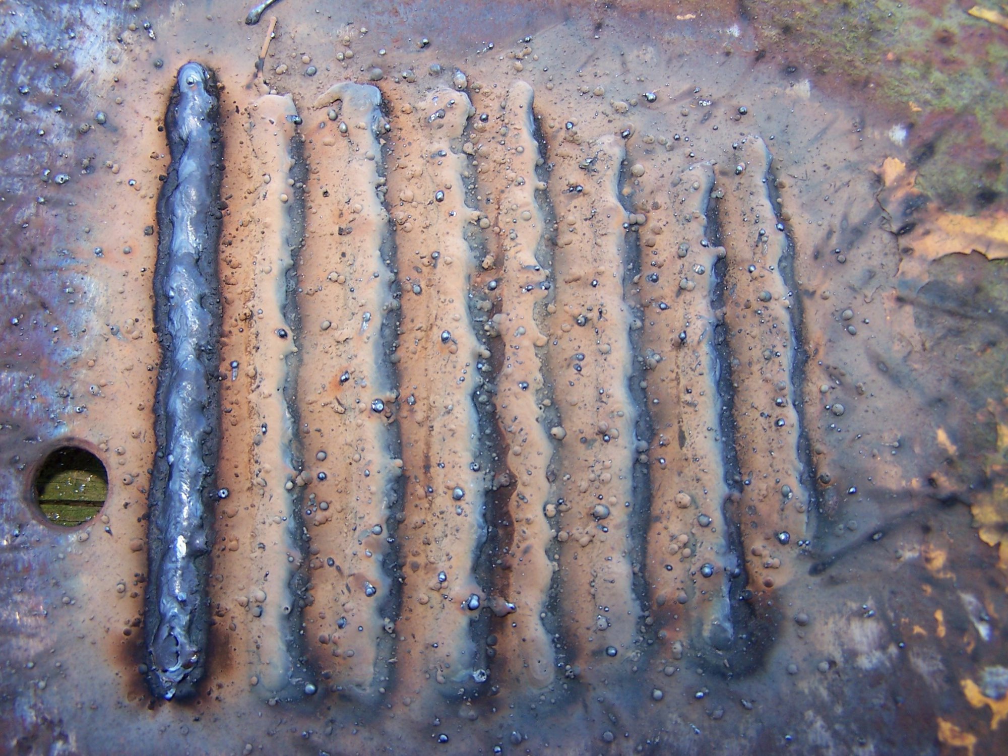

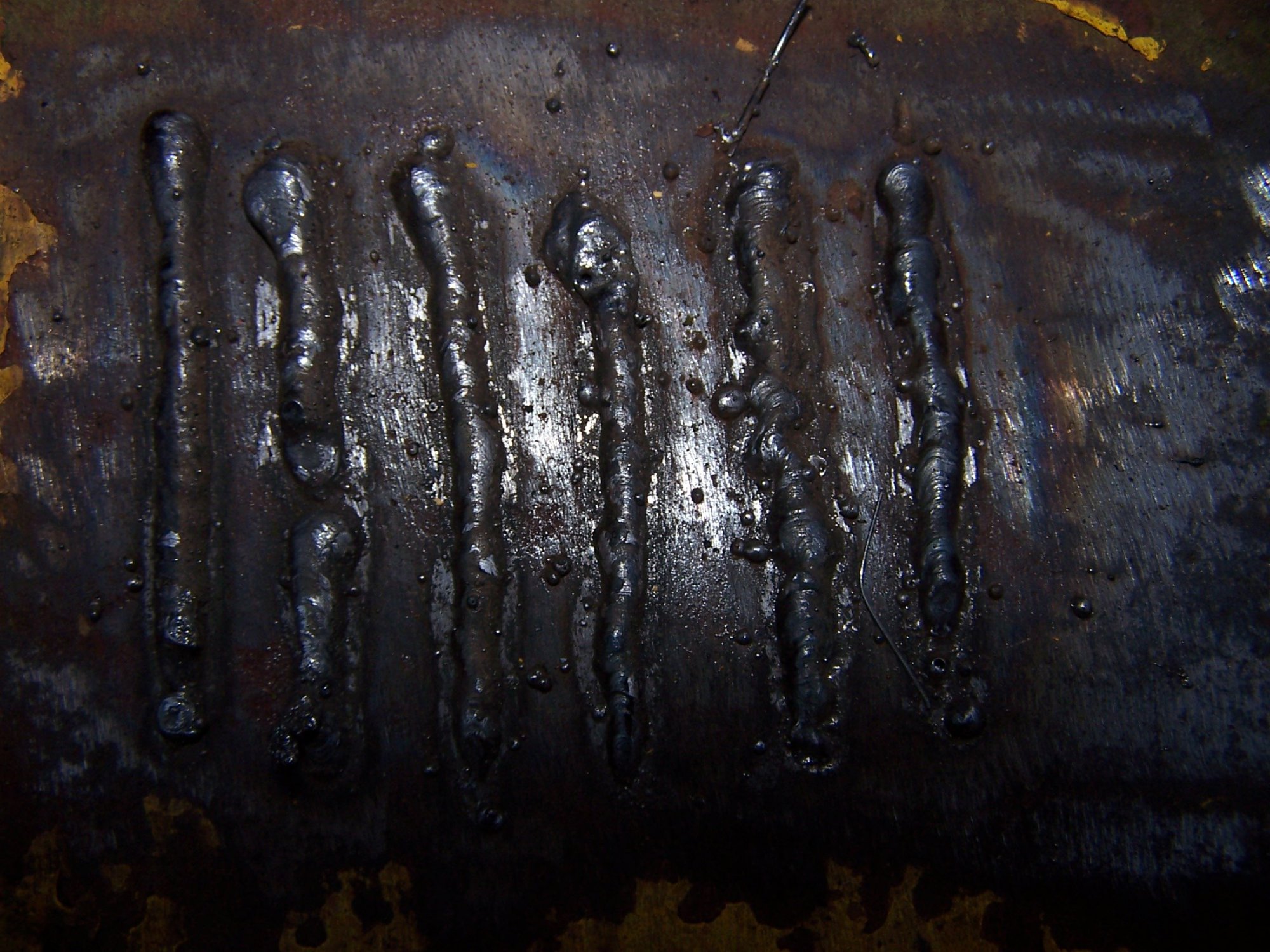

what thickness are you welding on?

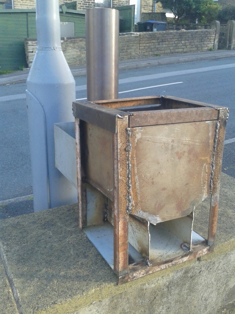

my settings is minimum 3 or max 2 or 3 wire speed between 4/5
There looks to be a lot of RUST around you welds! If you are not cleaning (grinding to clean metal) before welding then that rust will try and melt into your weld pool and be spat out as splatter. Try to get some new clean (no gav or nickle coating) and see what that weld like.
You might be right with this. I've tried to adjust the settings on my helmet to try and get a good view of the puddle. No matter what i try the arc is just too bright and the puddle is dim.i bet you noticed it was bright when welding while using it
