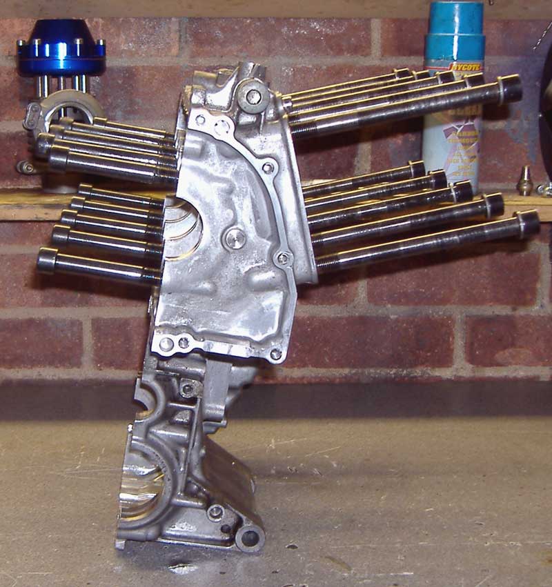

OK well to keep it on topic I'll start with this photo. The original bolts were M10 x 1.25 and I drilled them out to 10.8 then hand-tapped them 12mm x 1.25 for the high tensile socket cap head bolts. The shorter main bearing/bottom crank case bolts were M9 which I also drilled and tapped to 12mm x 1.25.

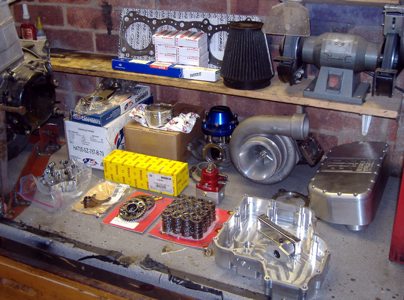

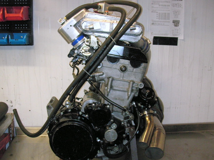

The entire system was built by me except back then I had no suitable welding plant (or skill) so I didn't do the welding. I started out with this pile of expensive parts. Best part of 5 grand here. JE pistons, Carillo rods, HD bolts and gaskets, HD valve springs Bosch 600hp fuel pump and a fuel pressure regulator I can't recall the maker. Garret 500hp GT30R turbo was destined to go on a Skyline but the project was sold off so I bought it. MTC lockup clutch and MRE cover. Adjustable cam sprockets. I didn't use the big wastegate but went for a Tial one and 50mm blowoff.

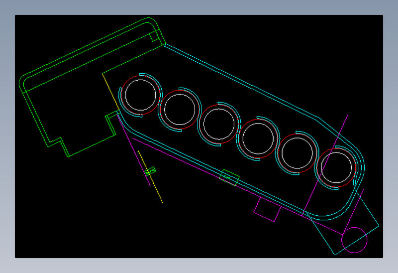

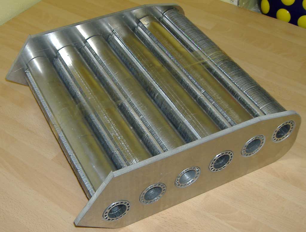

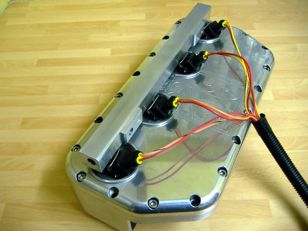

I bought a £400 CNC plenum cut the front off with a mini grinder and welded on my own design of watercooled charge cooler. The late Pete Bolas (hotrodder) welded the cores, a job that even the manufacturer declared would be "very difficult indeed" but he made it look easy. Also cut holes in the top for four extra Siemens Deka 60cc injectors which were (are) controlled by a Microtech fuel injection computer. The fuel rail was the fist thing I ever made on a milling machine.

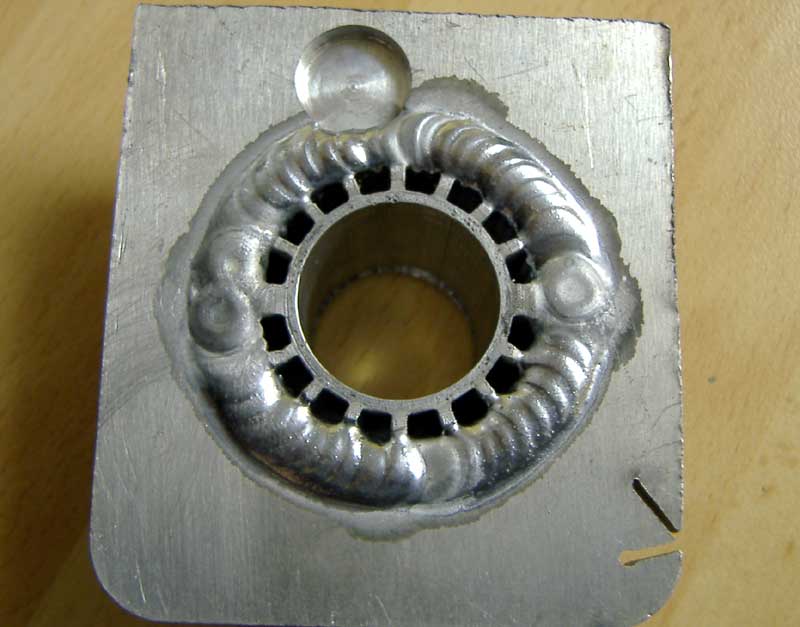

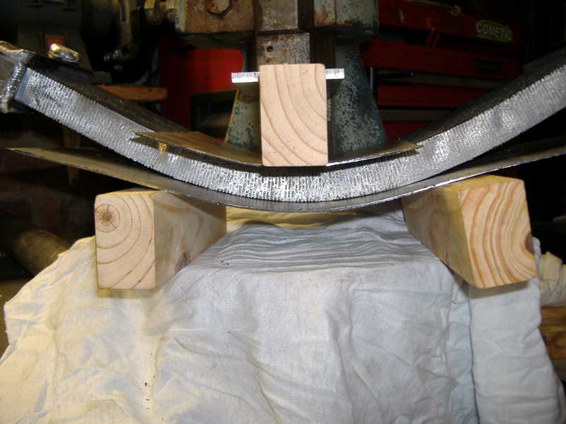

Hotrodder welded 12 of these ends without a single leak. The edge he welded was just 1mm wide pure ally onto 6mm thick 600 series side plates. Awesome skills. This was his practice piece.

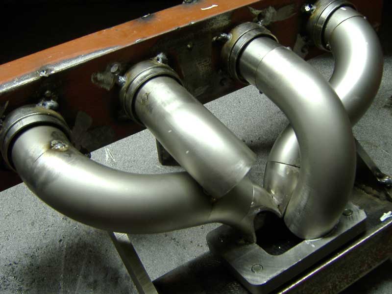

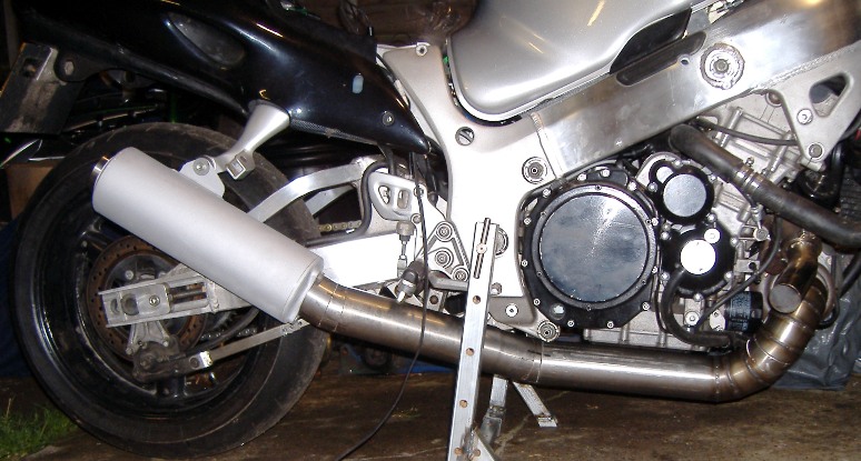

Headers were inch and a half dairy pipe I cut and fitted it all up in a jig and someone welded them for me.

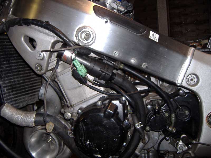

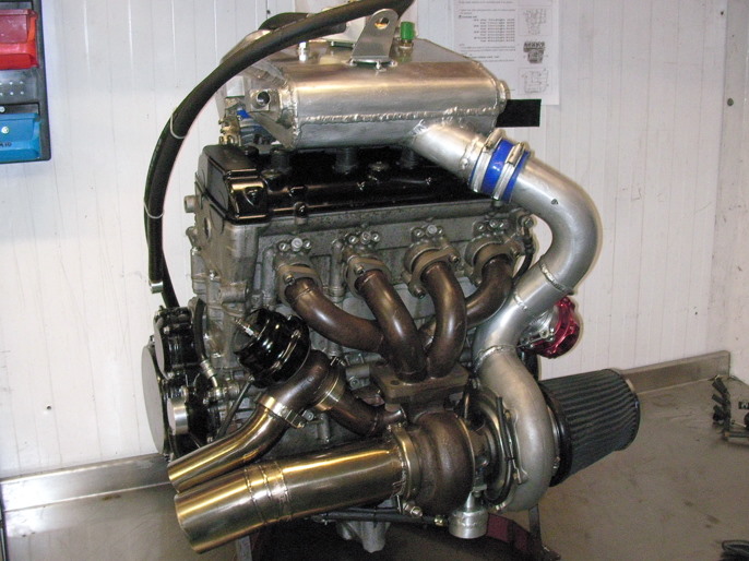

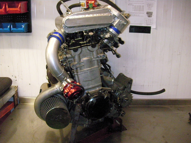

When it all came together it looked like this.
