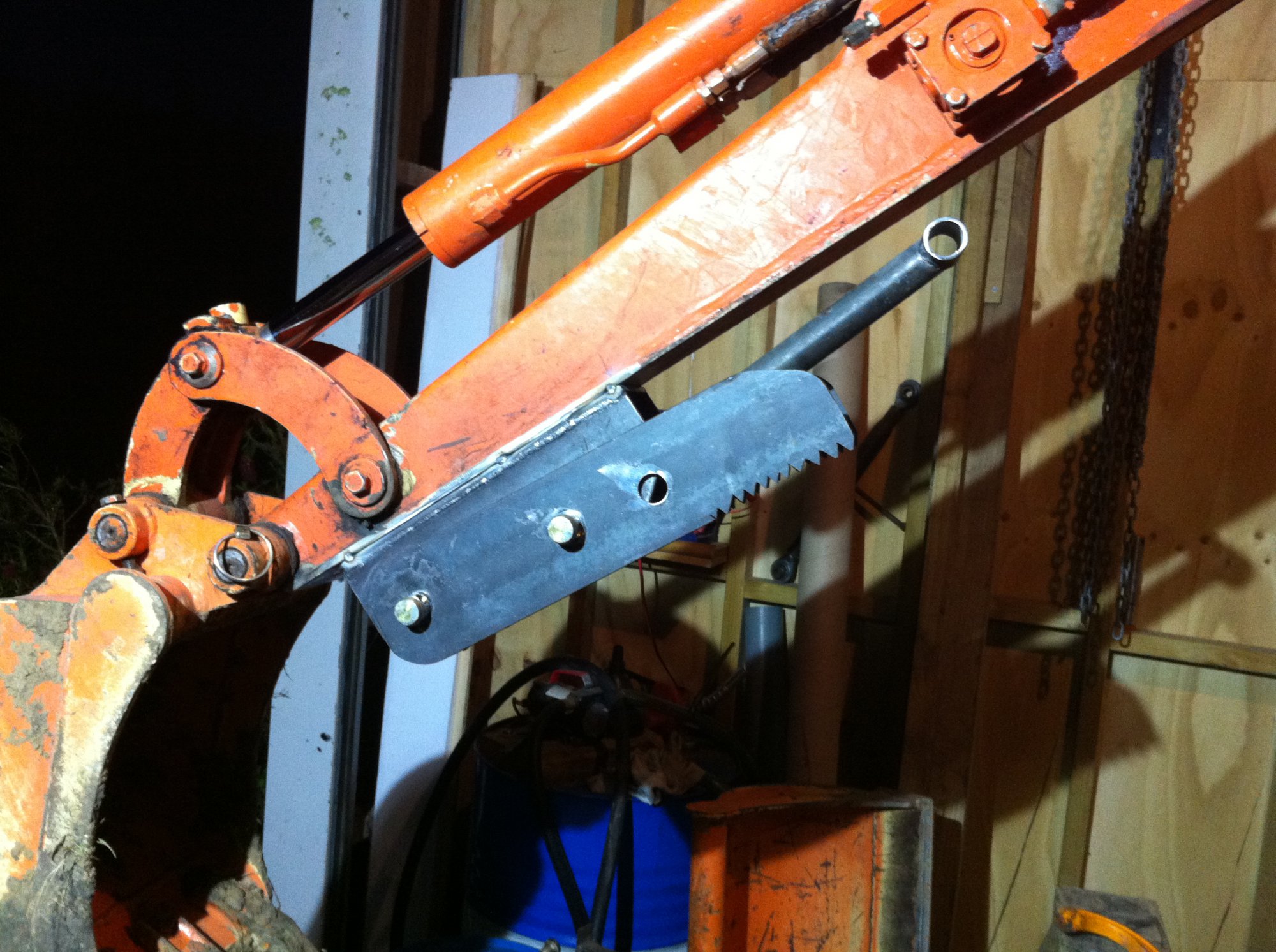

Built this today for my excavator. As it's nearly tree felling season so thought I would be really lazy to save picking up the logs by hand. Even folds back and out of the way.
Welded base plate on and the rest can be unbolted and removed.
Made from 10mm steel cut out with grinder and hole saw, as I don't have plasma, yet.
Works pretty well has 2 positions for the 'thumb' 90 degrees and about 60.
I have noted retiring makes you think about things you don't need and probably won't use much, but you think you need/want, or is it just me ?
Graham
