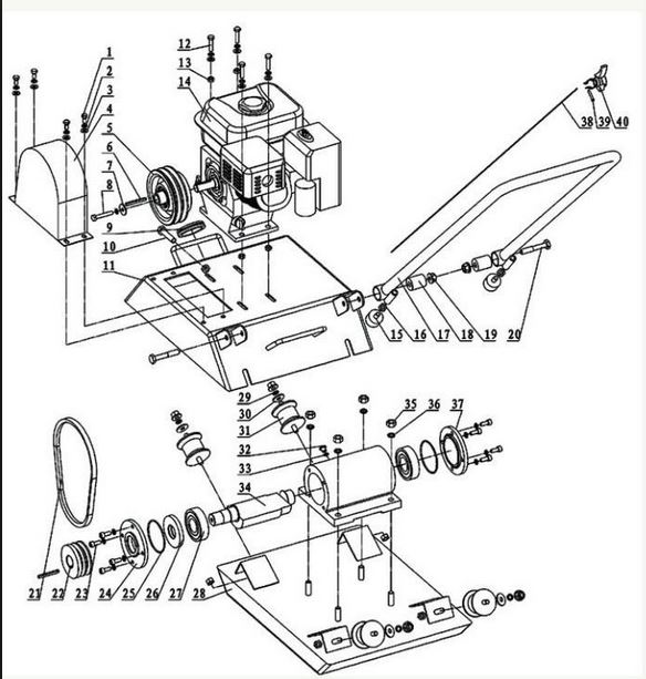

Put the big pulley on the vibrator and the small one on the motor to get back into a more comfortable zone ! 3:1 reduction on a nominal 3K = 1000 rpm
Another comment: Your design is also vibrating the motor - most have a longer belt and locate the motor off the plate to prevent shaking it to bits
This is one schematic I looked at before embarking on mine:
Big pulley on the motor, small on the vibrator, motor mounted on the plate that's isolated by the anti vibration mounts. What am I missing? BTW the Evolution Hulk electric one has an electric motor speed of 2800rpm like mine. Page 30 in this manual:
http://www.evolutionpowertools.com/downloads/manuals/build/web_hulks_eng.pdf
