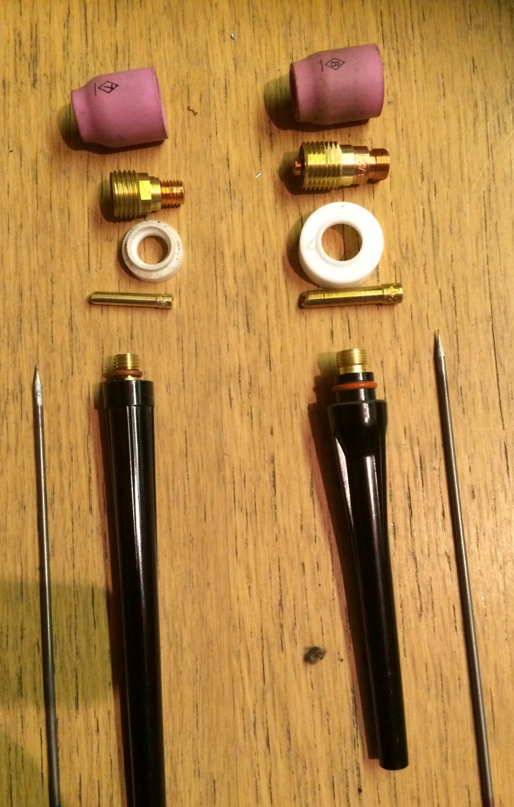

Best fiver I ever spent then lol.I ordered a similar kit but not the glass cups. The white insulator is wrong and the cup doesn't fit into it, looks like you will have the same issue here. I've ordered a couple of other insulators which should hopefully be correct but still waiting on them.
That's what I ordered apart from it was a wp9/20 version. We shall see. Worth a punt, certainly wouldn't be buying it as a replacement for my weldcraft/ck lenses. That no 10 tube and those rubber rings will go in the bin mind. I've no use for those, I'll just give the lens a bash.This kit looks like it would work and you can see in the pics how it goes together.
http://m.ebay.co.uk/itm/10-pcs-TIG-Welding-Torch-Stubby-Gas-Lens-10-Pyrex-Cup-Kit-for-Tig-WP-17-18-26-/291966794782?_trkparms=aid%3D222007%26algo%3DSIC.MBE%26ao%3D1%26asc%3D20150519202351%26meid%3Df213fa70e54240ad83af4aeae8ed0cff%26pid%3D100408%26rk%3D8%26rkt%3D25%26mehot%3Dpp%26sd%3D311786015803&_trksid=p2056116.c100408.m2460
Yes the stubby lens insulator is a big flat surface across the face the lens sits on. That one in the pic looks like the standard type for wp17 collet bodies.This is the one I originally bought and with a bit of hindsight you can see the insulator isn't going to work with the cups. I thought I was just being dim not getting it to fit, which is still a possibility. :-)
