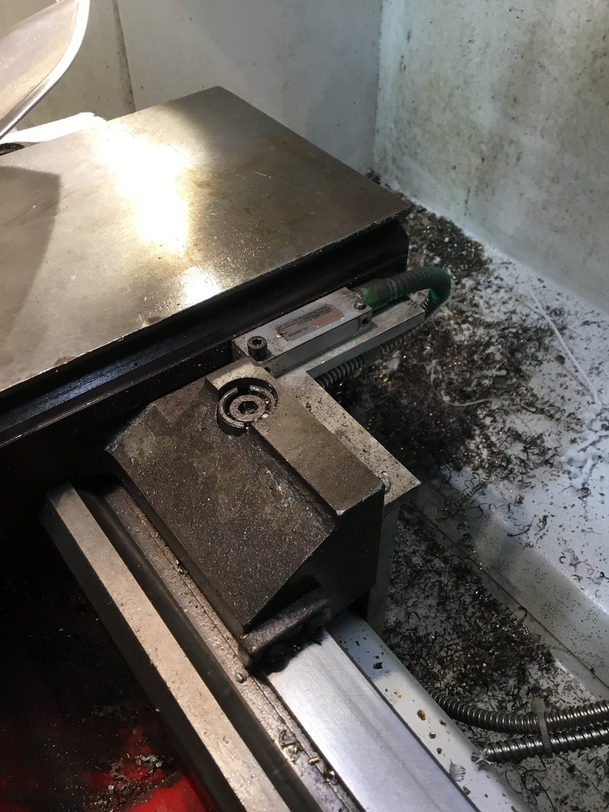

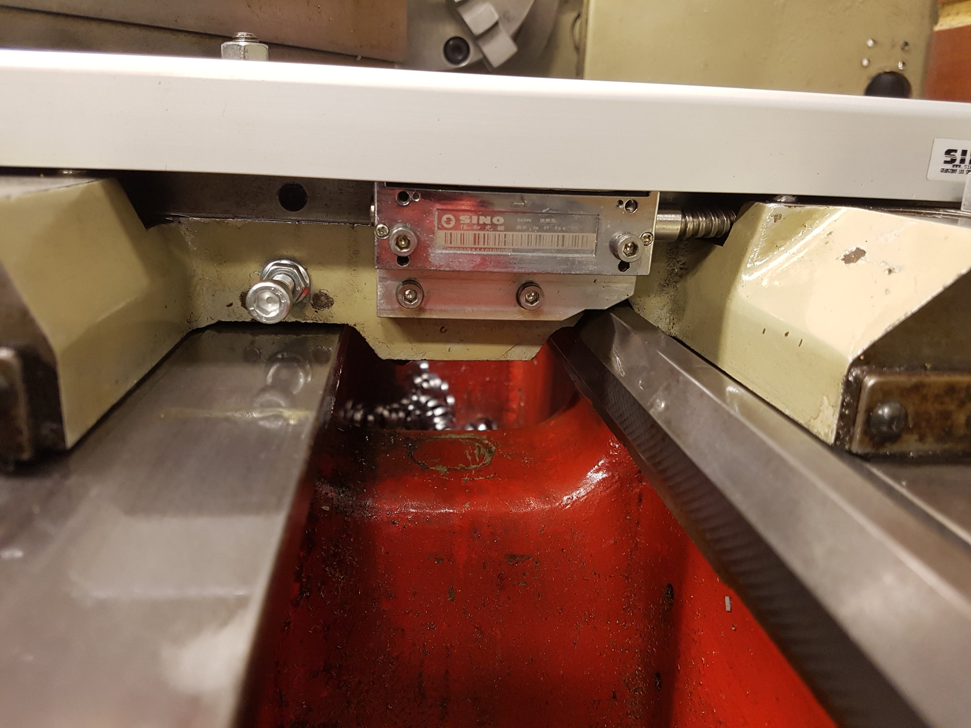

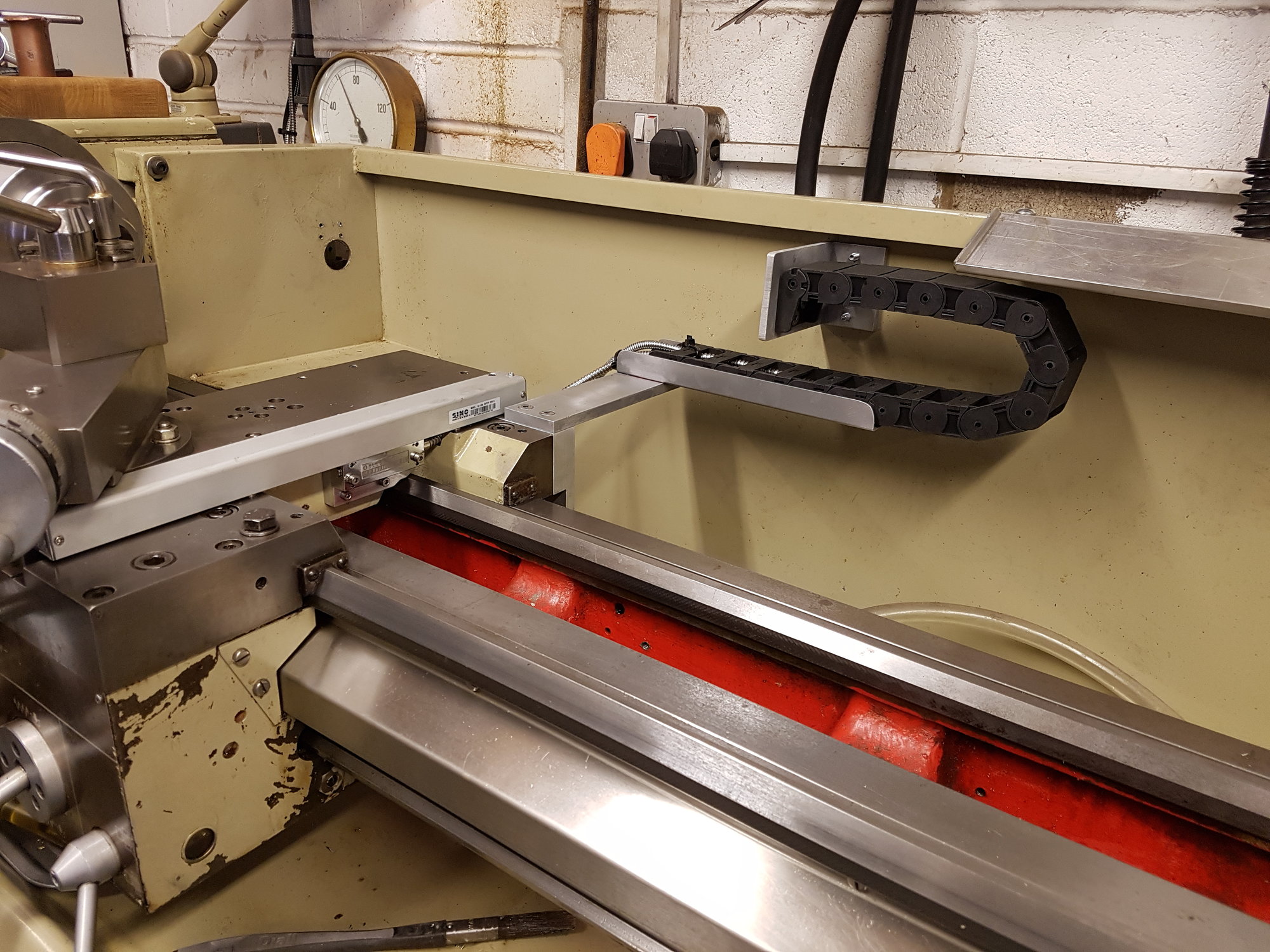

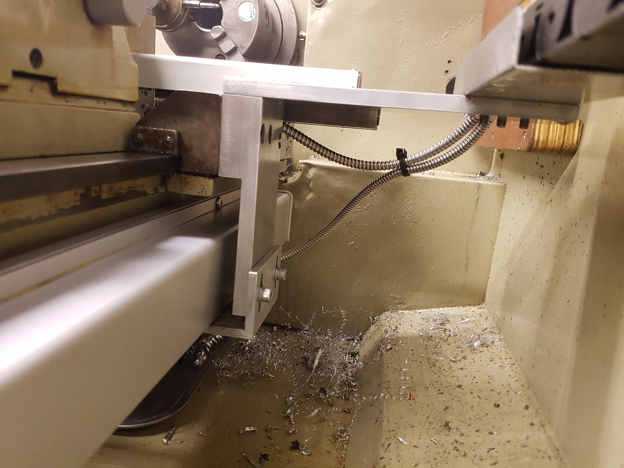

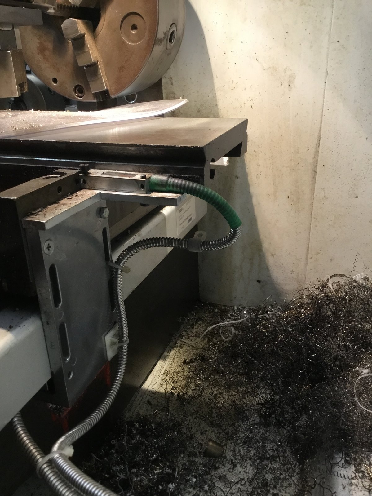

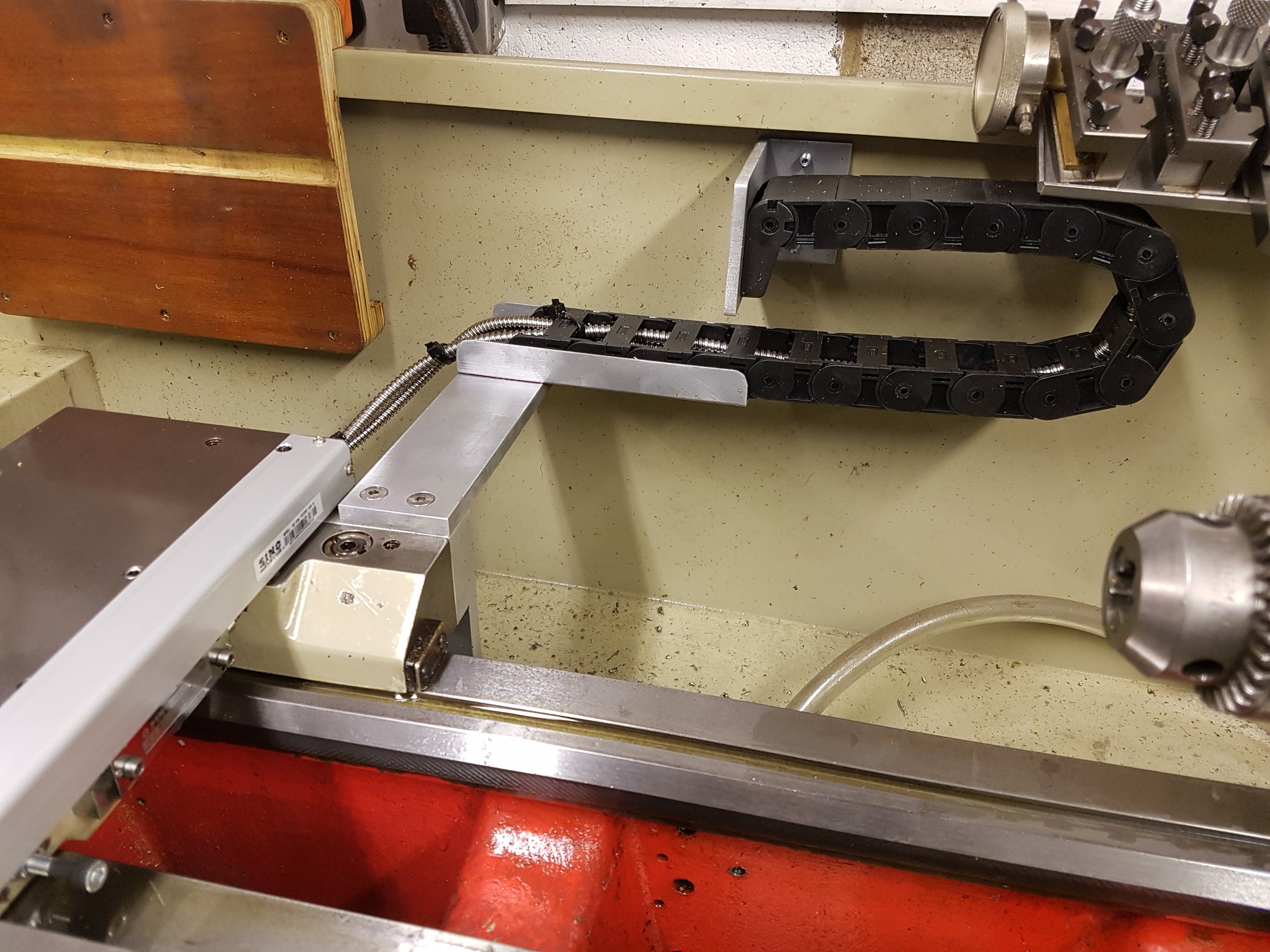

I fitted a DRO to my harrison m250 a while ago and i wanted to keep the cables from the read heads up out of the swarf tray. i didn't want them all tangled up with the long stringy ones so i used a cable drag normally used on cnc machines. i thought i would share it. maybe someone else has a problem with their cables
