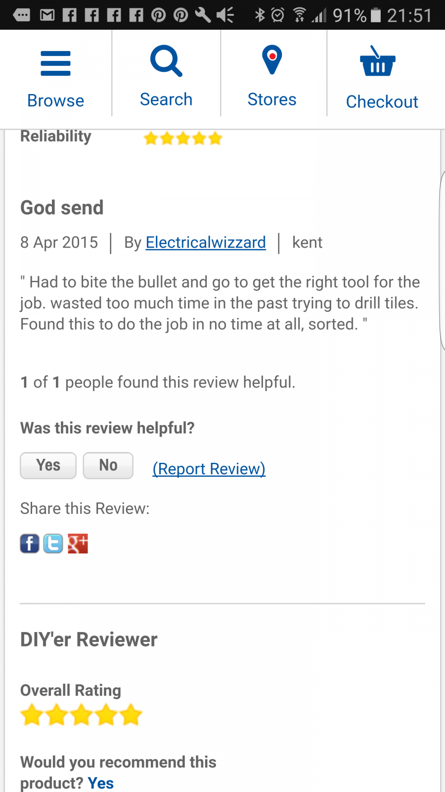

My mate is a bathroom fitter / plumber and he has just finished our bathroom. He uses these:
http://www.screwfix.com/p/erbauer-diamond-tile-drill-set-4-pcs/11128
I tried one of those...a bosch actually and you could hear the tiles laughing at me..lolI've drill hundreds of tiles using cheap glass and tile "spearpoint" drills from Screwfix etal
As mentioned above masking tape to mark the centre point and to prevent slippage during initial starting of the hole and then lots of water as a coolant.View attachment 105826
That was the one i ended up buying...just one drill though and that was 19 quid.My mate is a bathroom fitter / plumber and he has just finished our bathroom. He uses these:
