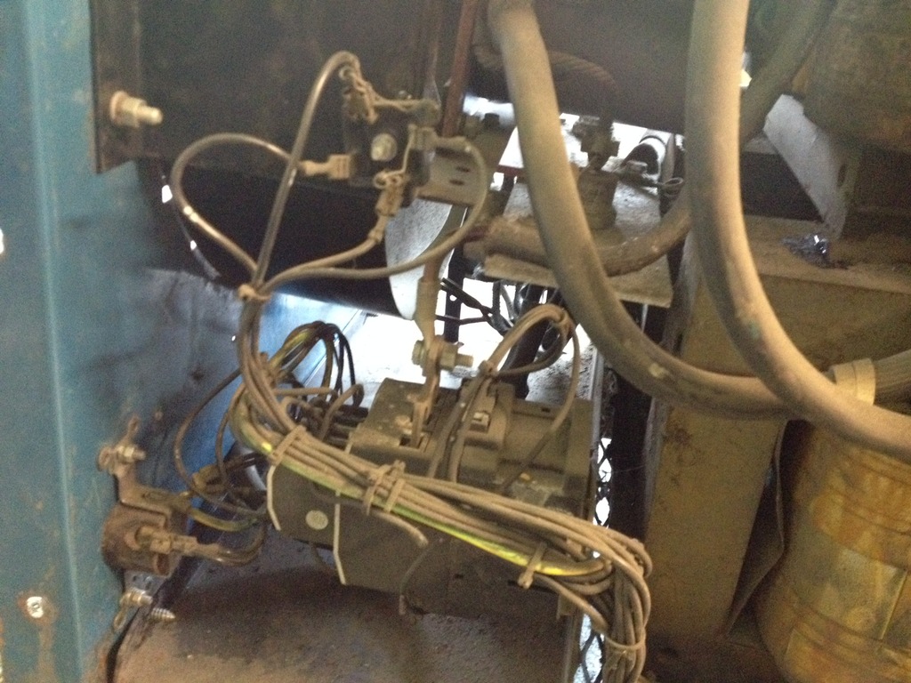

as you can see its a big fat podger of a miller dialarc ,same as Wozzaaahs , except it was bought as not working , (was working then left for a while then didnt work). it came with a pedal and long tig torch and cable ,so for 80 quid all in i thought it worth a gamble .
i have had conflicting advice re whether i can hook it up to my 240 v single ph , but i know Wozz has done it so i am going ahead regardless ,nothing to lose .
i have a 25mm cable to the batcave ,and a 32 amp socket breaker on it ,so my plan is to try it turned right down low and see if it will not trip the trip ...this way i can see if i can get it to work at all, then if it does work i can step up to a 68 AMPS setup, i cannot really see myself using more than 150 amps anyways ,the machine is 310 amp capable .
re getting it running ..All i can say is ,the breakers were .8 and .4 ohm so straight through .there is no smell of burning ,the diodes i have not tested .the caps i found 2 of them were fine .looking at the sheet is it possible the fan would not run if the transformer were dead ?...but i would have thought that would trip the supply which i cannot find out until i finish my hasty 32 amp setup ..i am hoping that will suffice to test ,with the welder on lowest range and the pot turned to 0 ?
I am wondering if the chap in Bury where i got it had had one phase turned off by the land lord and didn’t realise it ...it really does not smell or look bad in there .some piccys ..
