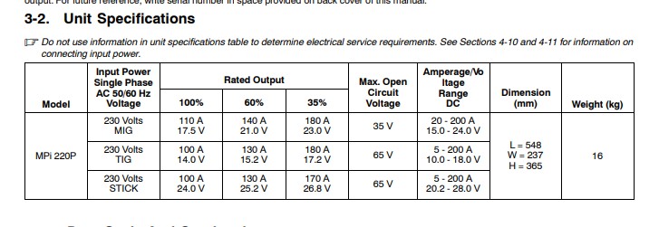

Are there any recommended migs on single phase (32a max) supply, prefer smaller inverter type.
