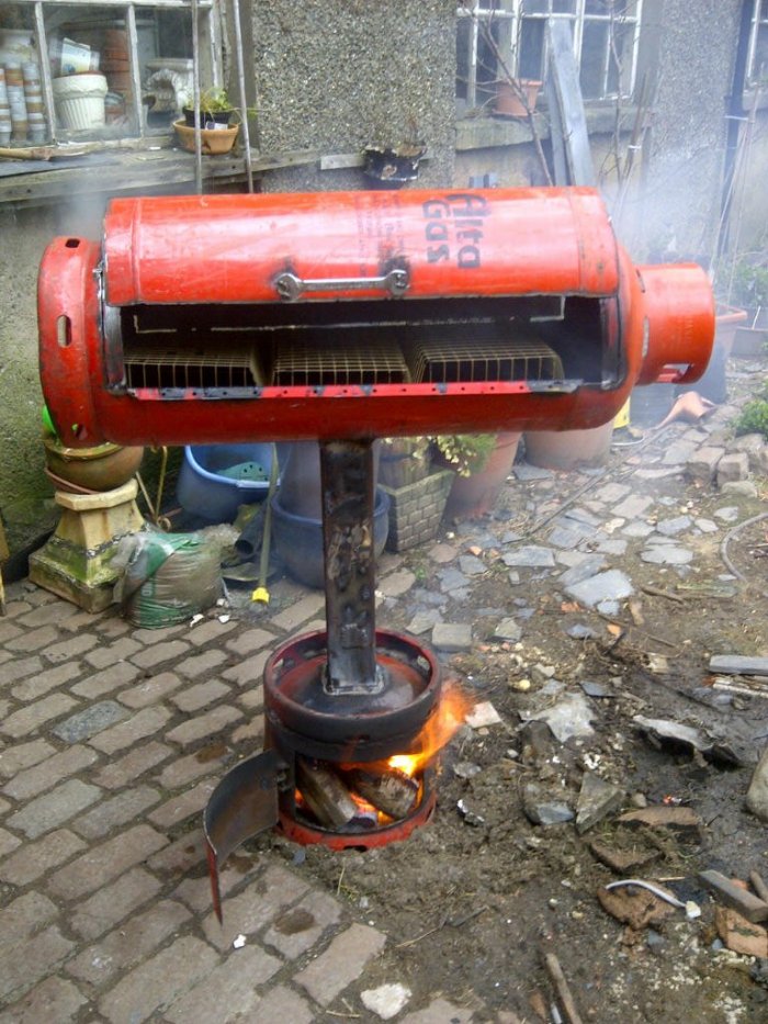

The water merely prevents the possibility of a large volume of gas forming within an enclosed space.
By priming the vessel with water you exclude any gas.

First burner I did I couldn't get the valve off so I cut it with a hacksaw, drilled the valve slowly then filled it with water. It would still hold a flame after though.

My personal "take away" is that when a flammable gas is enclosed in a volume it can either be too lean to even burn, too rich to ignite or - the bit in the middle. The bit in the middle is where the bottle explodes violently. A perfect flame front forms, burns the gas mixture perfectly, the flame front travels at supersonic velocity through the entire volume and the enclosed gas suddenly becomes superheated and wants to occupy a space several orders of magnitude larger than the one it is encased within. This happens very quickly and when that expansion is contained and all that pressure can't get out of the tiny aperture you've cut into the top, it will explode.

Is the thread into the gas bottle left hand thread? Can't remember now, been a while since I recycled one.The best way to take the valve is by cutting of the shroud first. This gives access to a big pair of stillsons. Then a bar in one of the holes in the base ring. Apply force in opposite direction. It works every time

i said open it up not cut it up by taking the valve out and filling with waterThey can't do anything if you cut them open while full of water.
Having had a flame shoot out of a washed out bottle, its not something I want to risk again. The flame won't injure you but when you flinch holding a 9" grinder you risk all kinds of not fun things happening.
or takin the shroud off and giving the valve a good 3 bats on the side of it and it will come out easy with a 2 1/2 lb hammerThe best way to take the valve is by cutting of the shroud first. This gives access to a big pair of stillsons. Then a bar in one of the holes in the base ring. Apply force in opposite direction. It works every time
