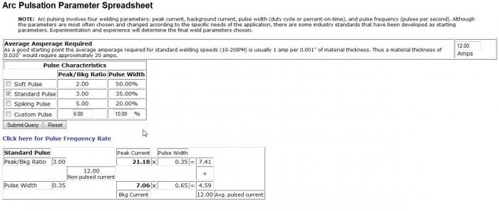

Hi, not posted in here for a while
My work has just ordered me a new tig
Fusion PHF
First one with a pulse function, having never used pulse mode on a tig could anyone tell me what the best setting for doing 2 inch exhaust tubing (stainless) would be, the wall thickness is 1.5mm - 2mm.
Just an average setting is needed to try it out until i get used to the machine and play about with the settings.
Another question is there a bigger advantage using pulse on this kind of tubing.

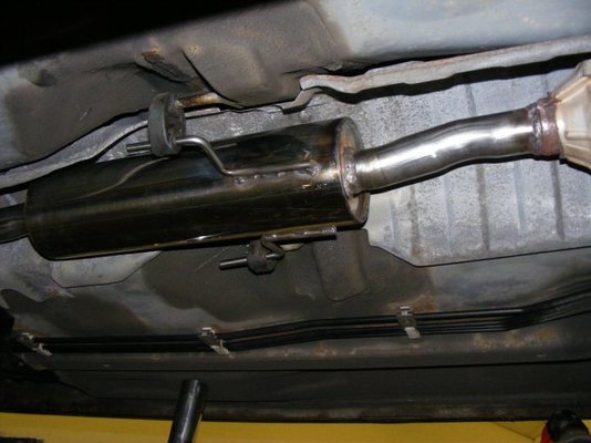

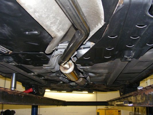

I am doing this sort of thing
