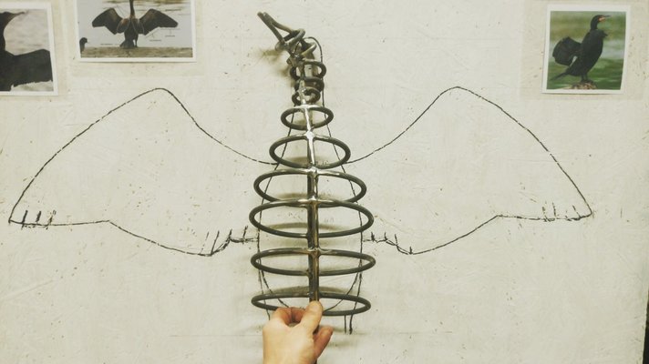

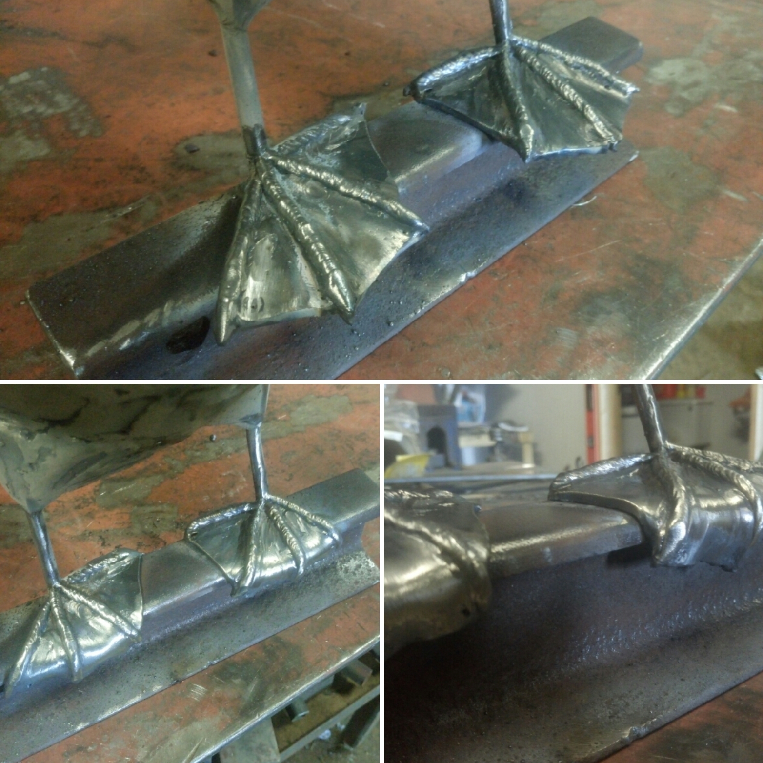

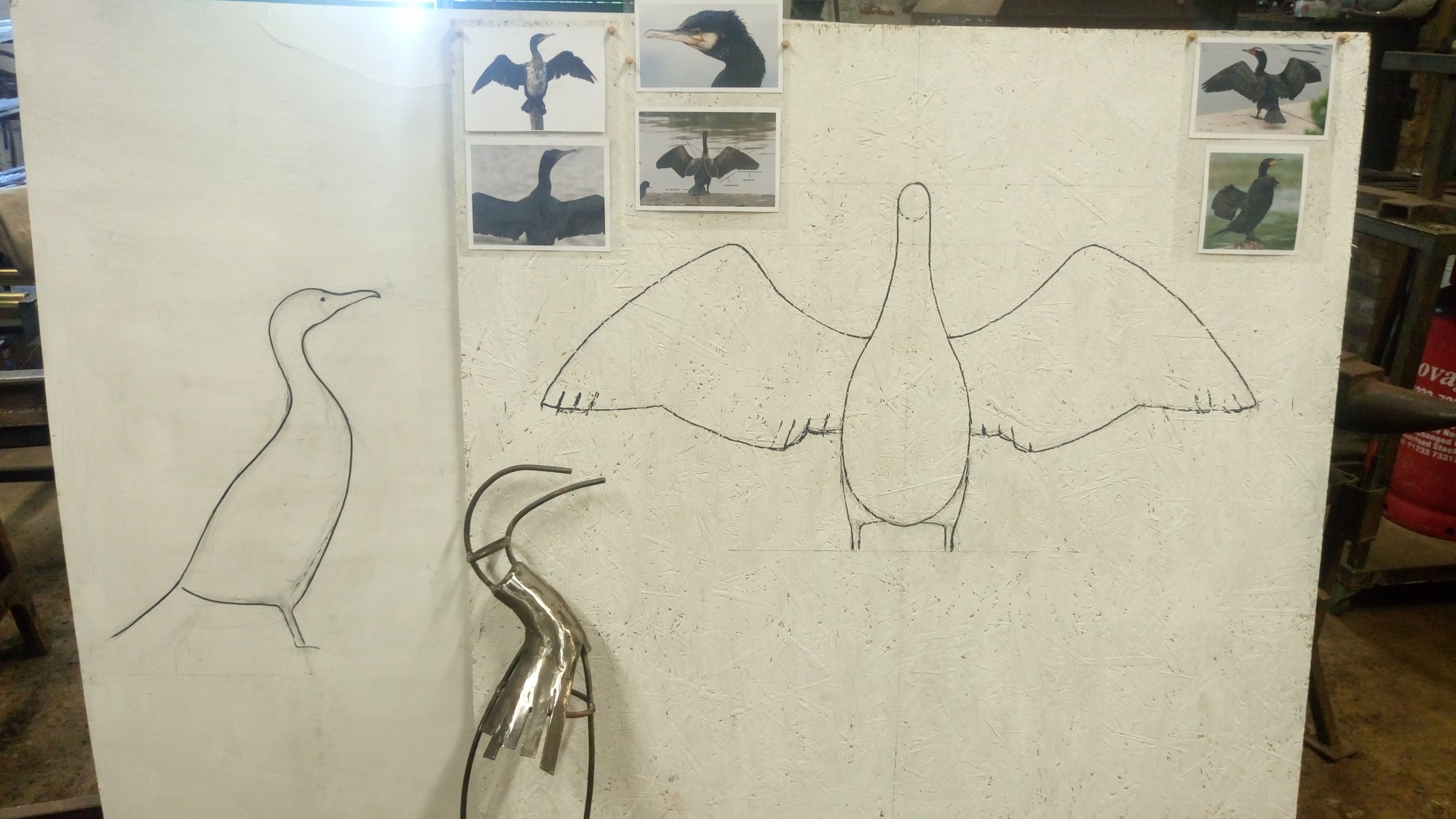

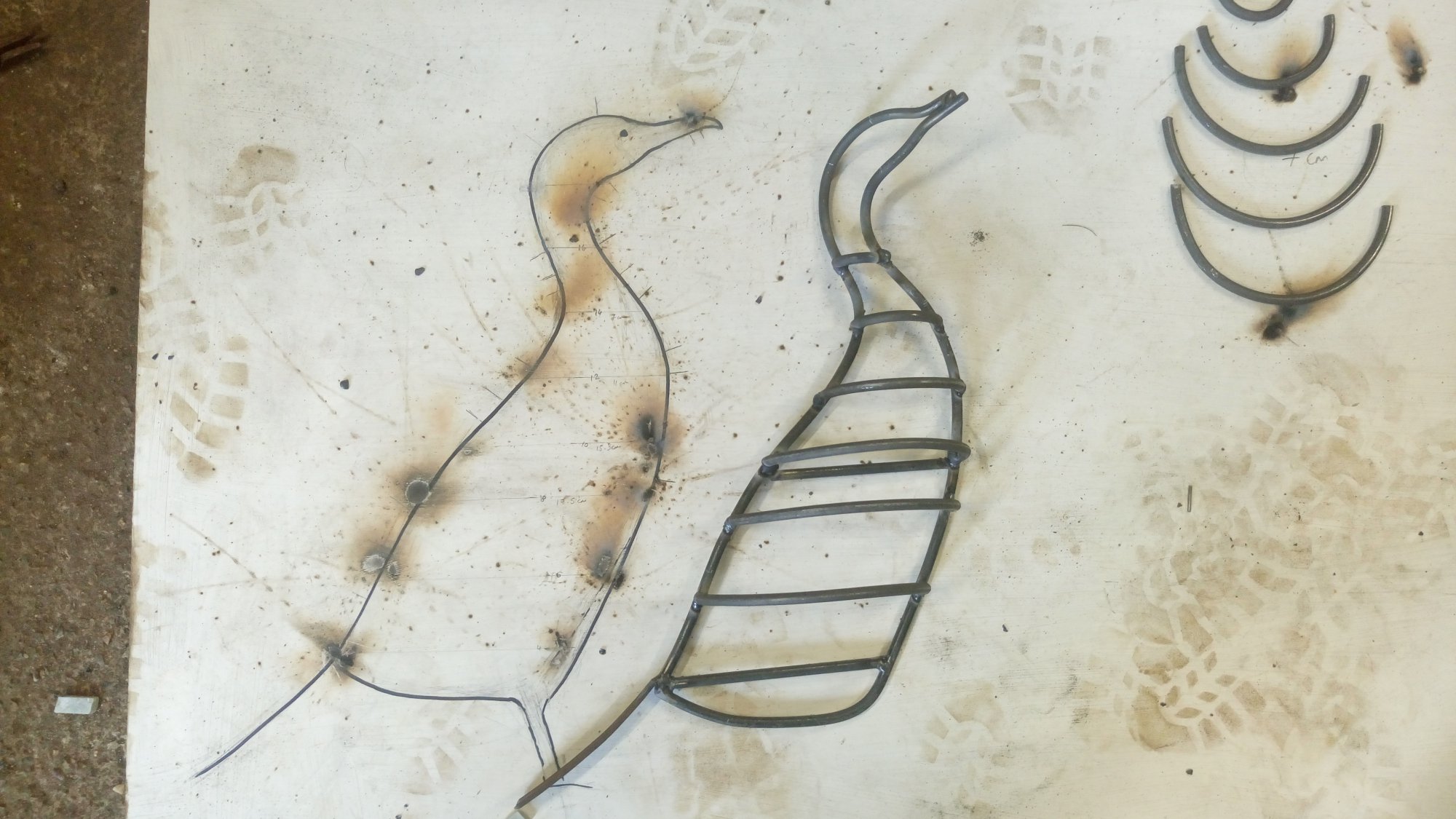

Profile and face on outlines drawn up with my client to the posture they want. Head will actually be turned but I'm not that good at drawing. Sample piece at the bottom.

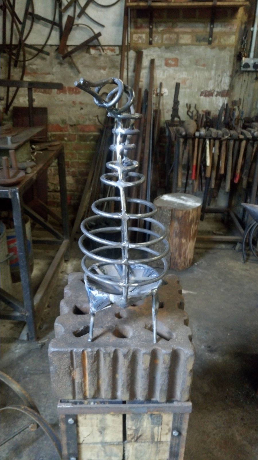

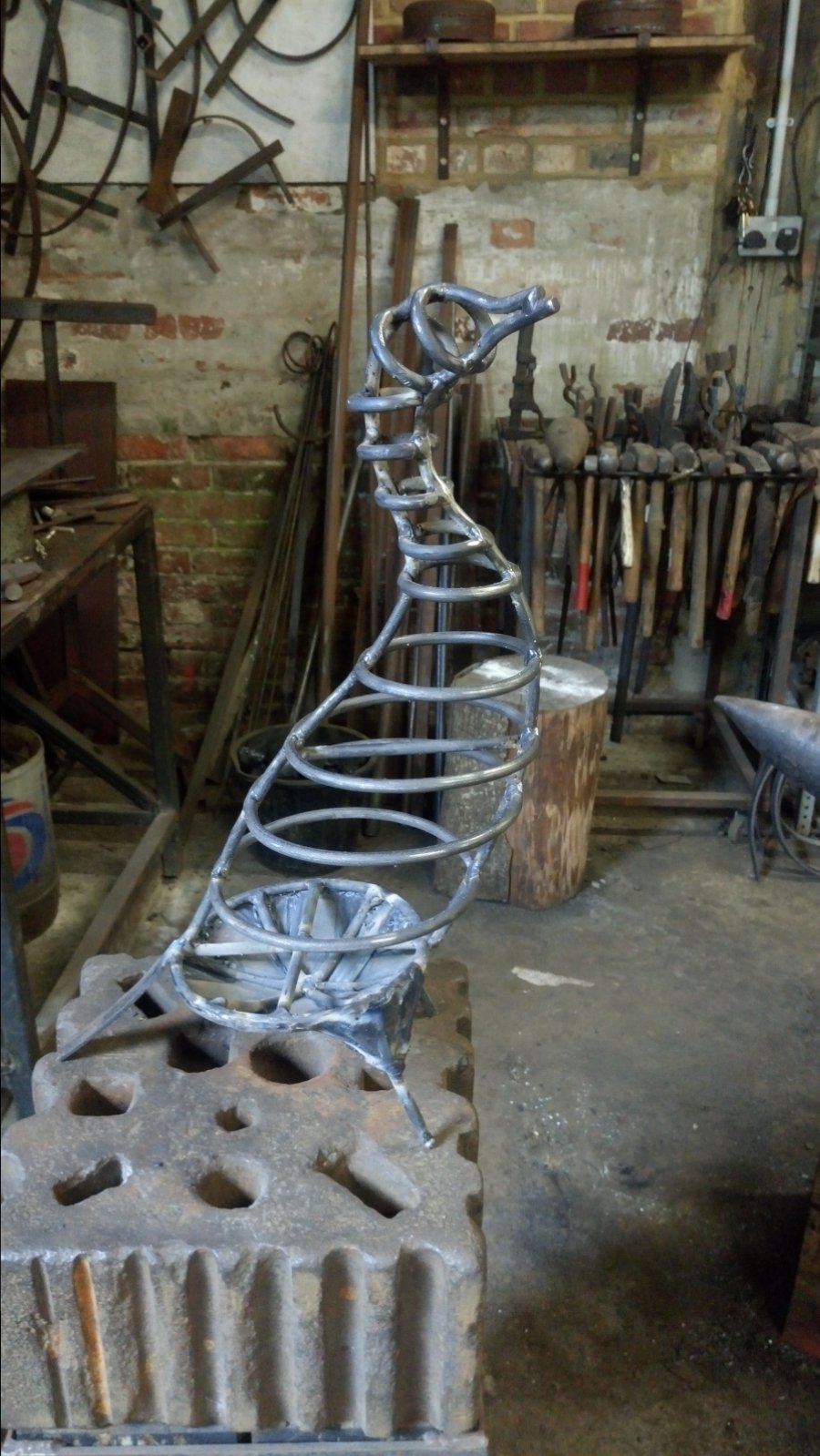

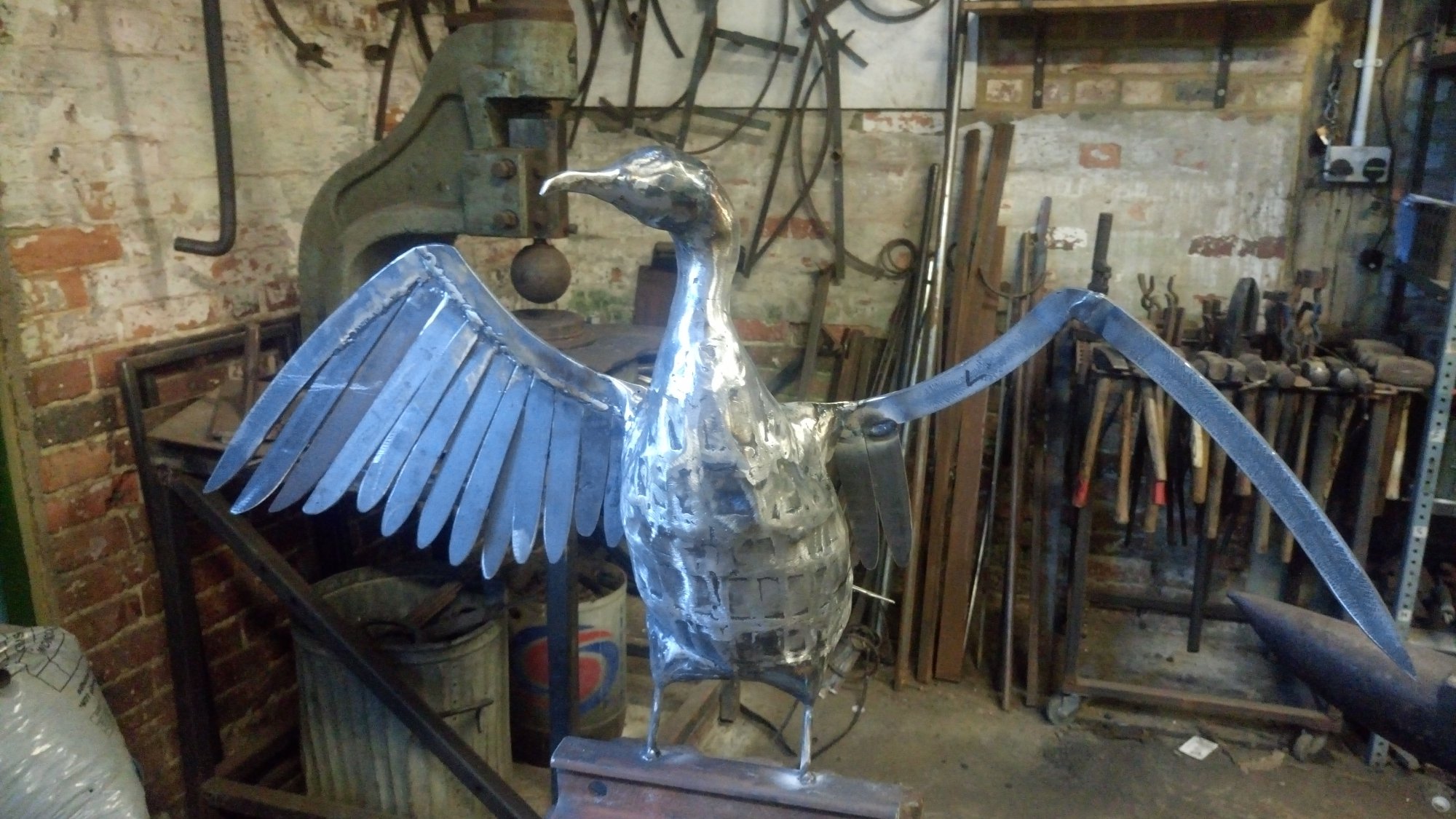

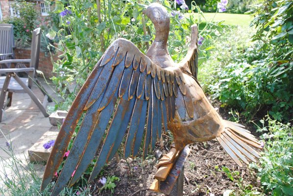

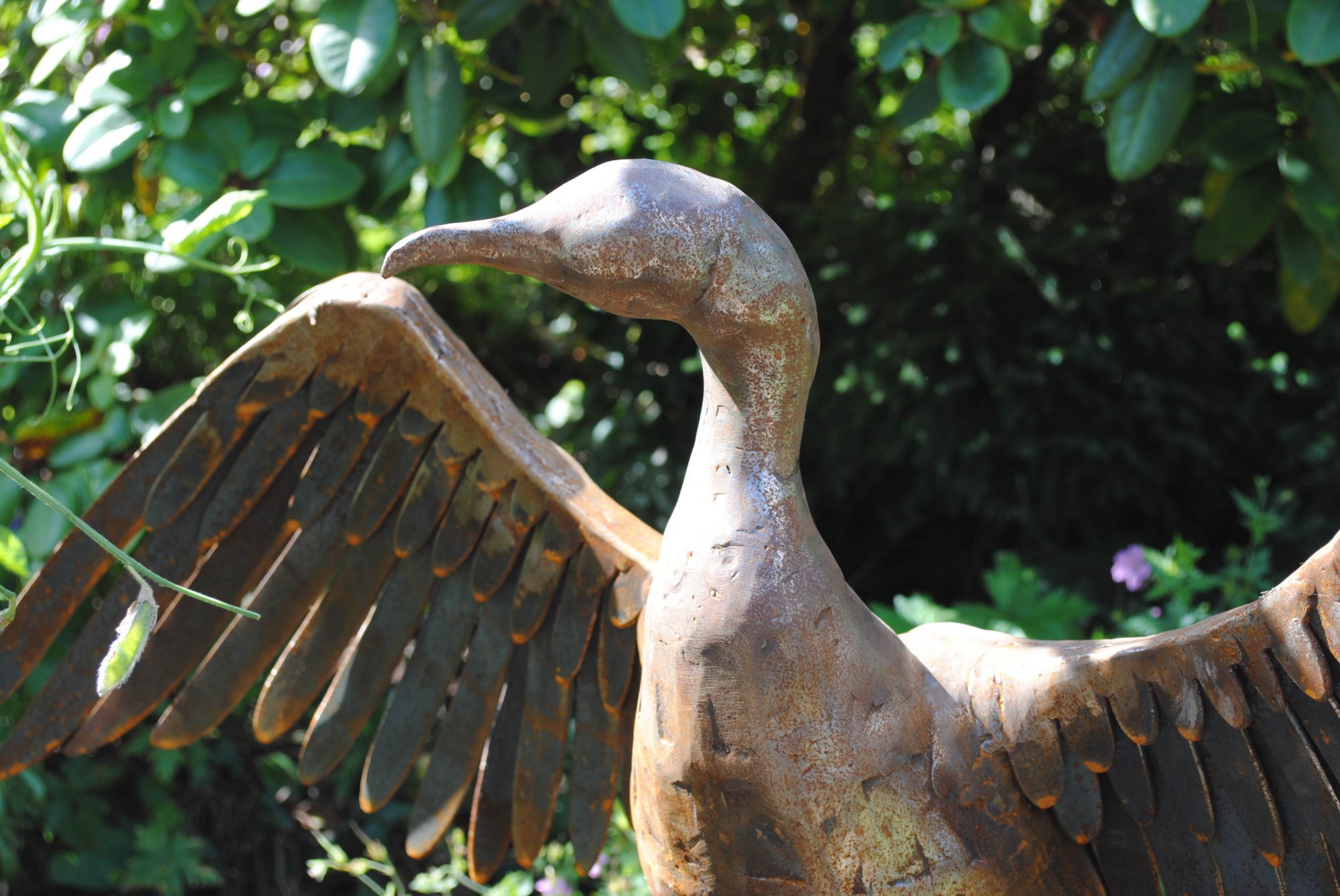

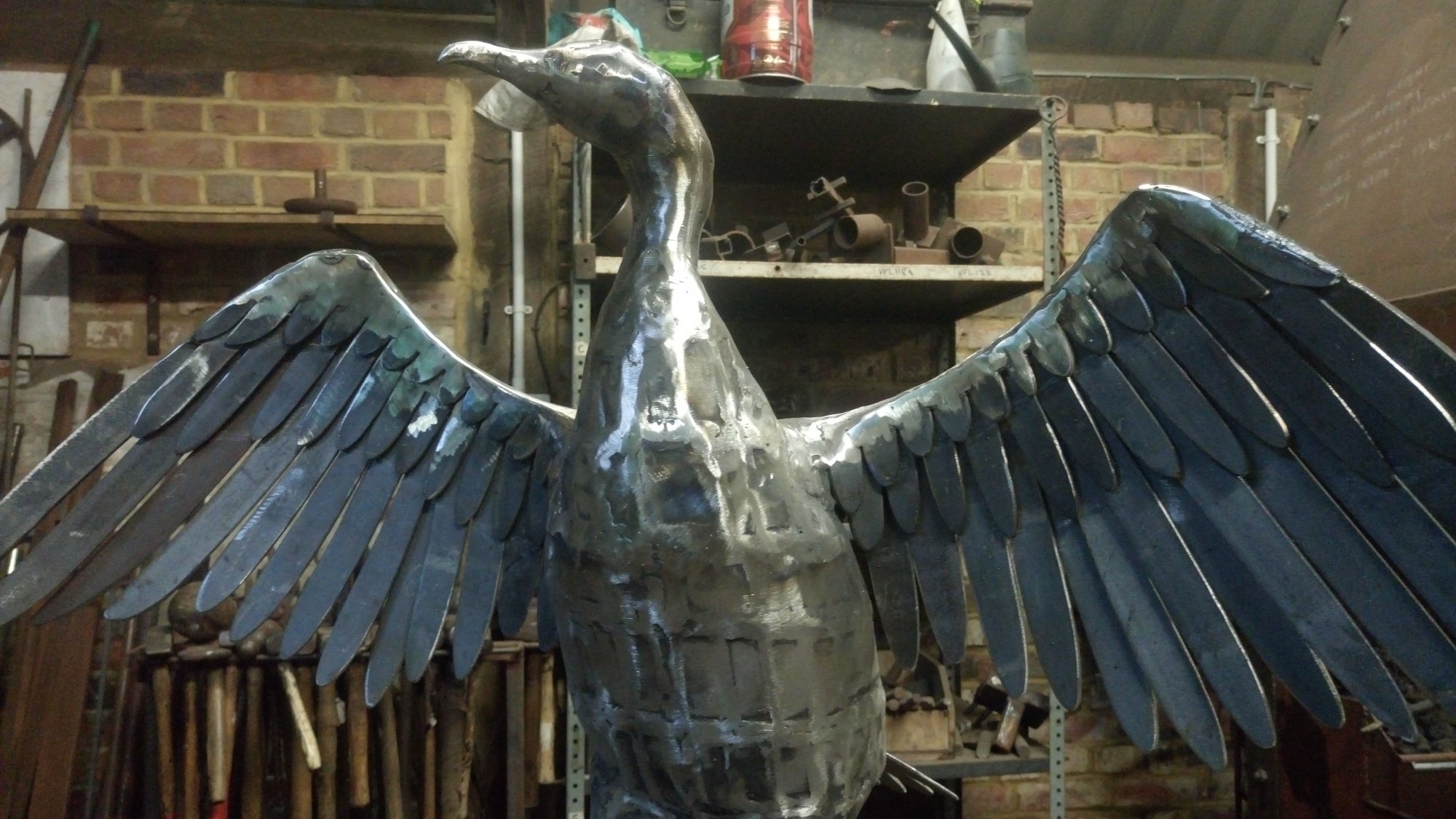

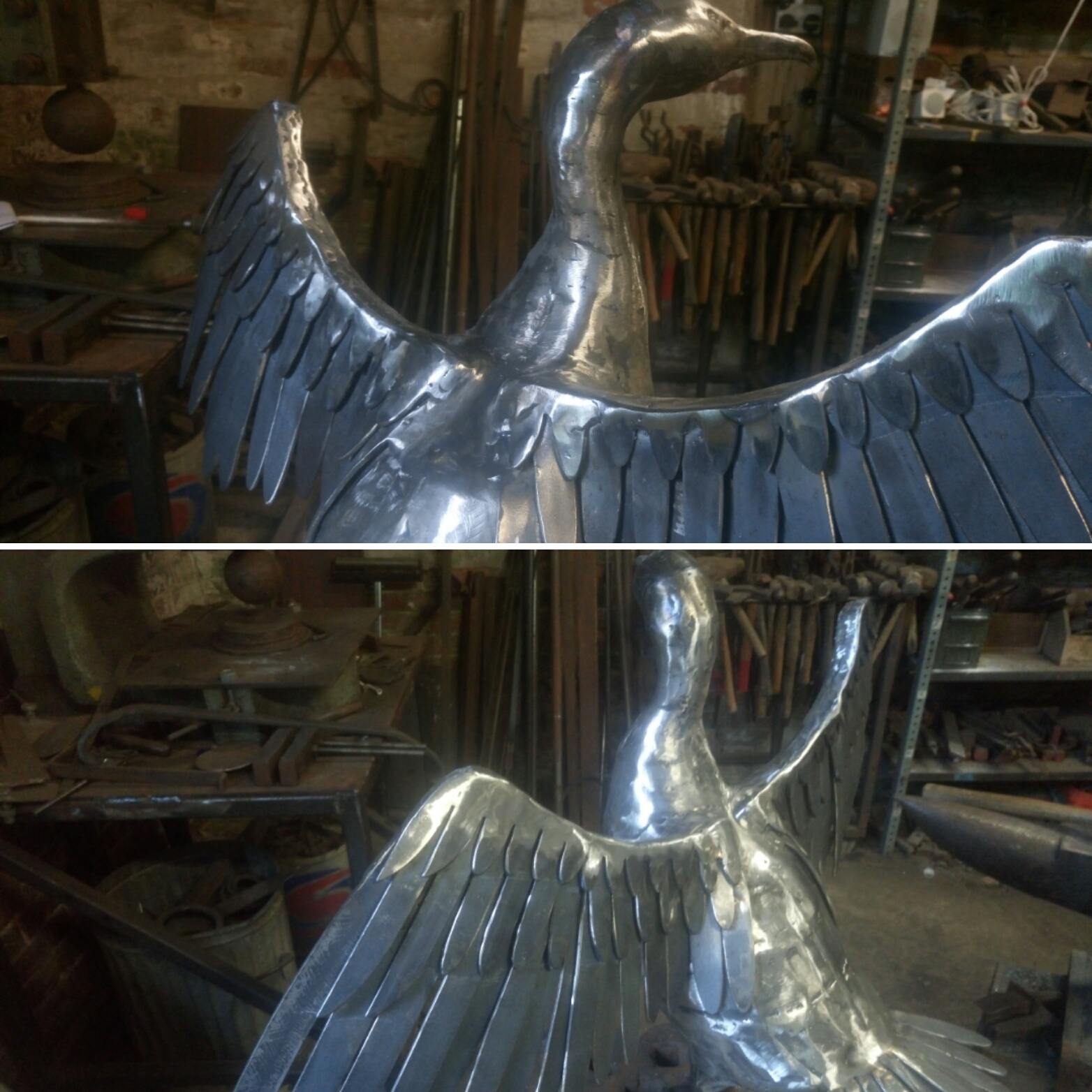

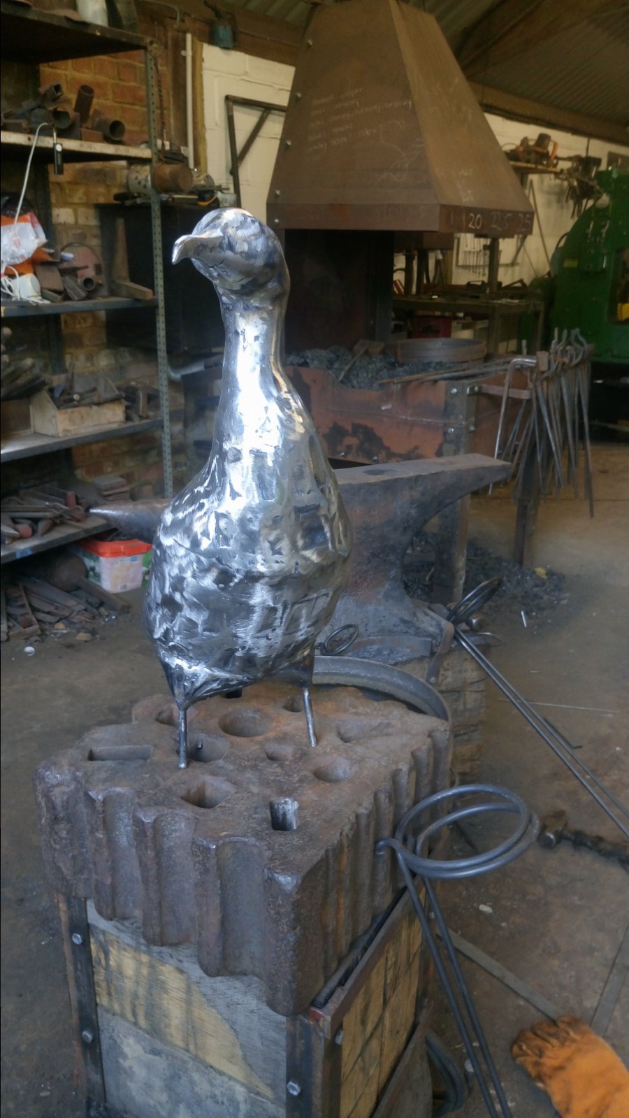

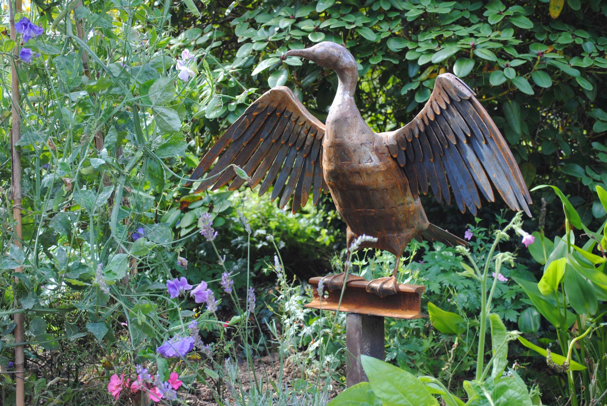

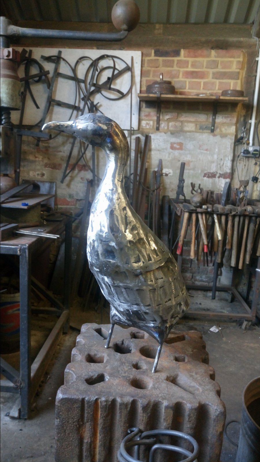

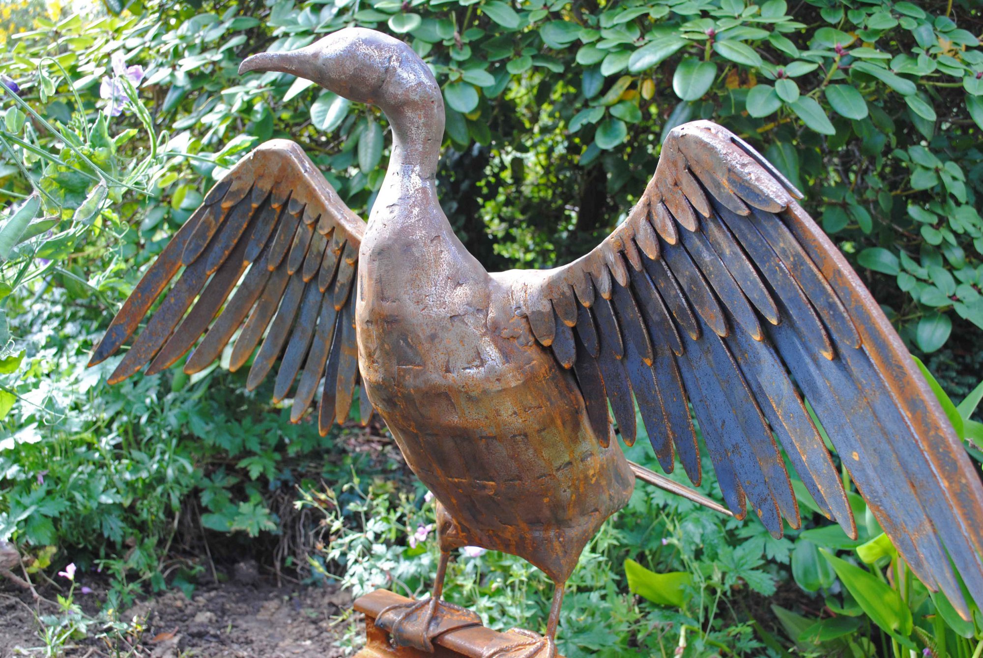

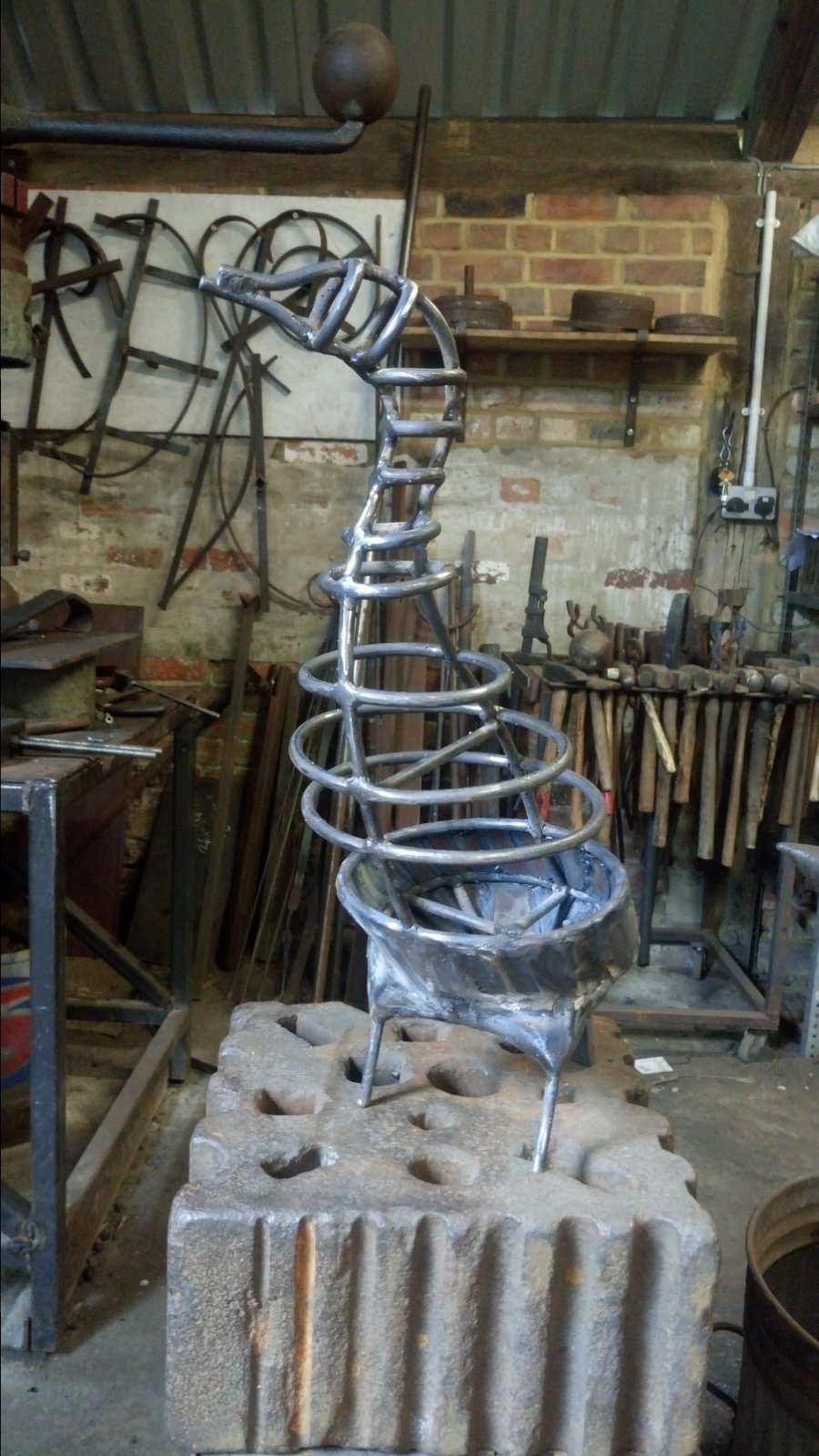

Frame now complete and ready to move onto the body feathers & wings. Frame made from 8mm round, body feathers will appear sheet like made from strips of 3mm flat bar welded side by side & ground back flush. Tail & wing feathers willl be strips of either 16 x 3mm or 20 x 3mm - as per the bottom of the sample piece. Being left to rust as per client's request.
