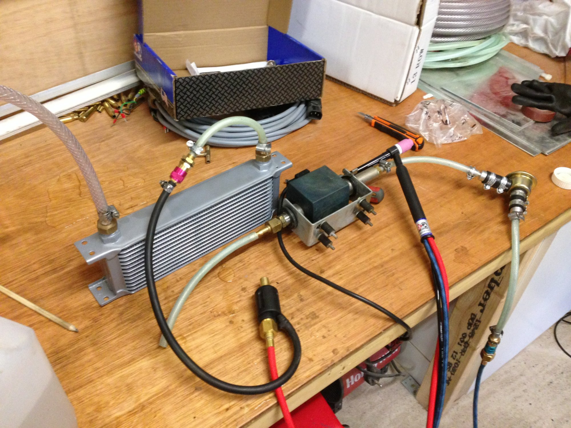

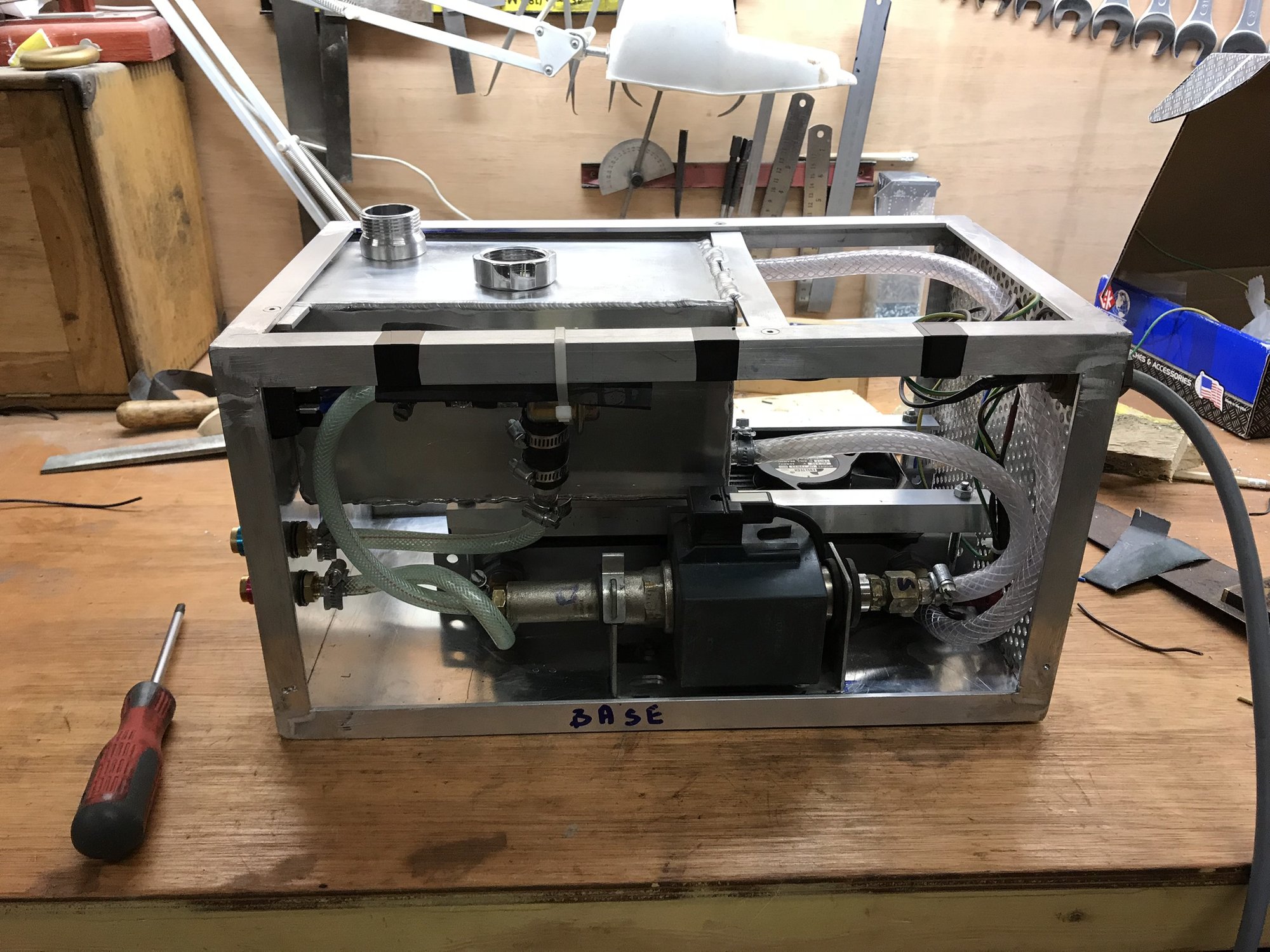

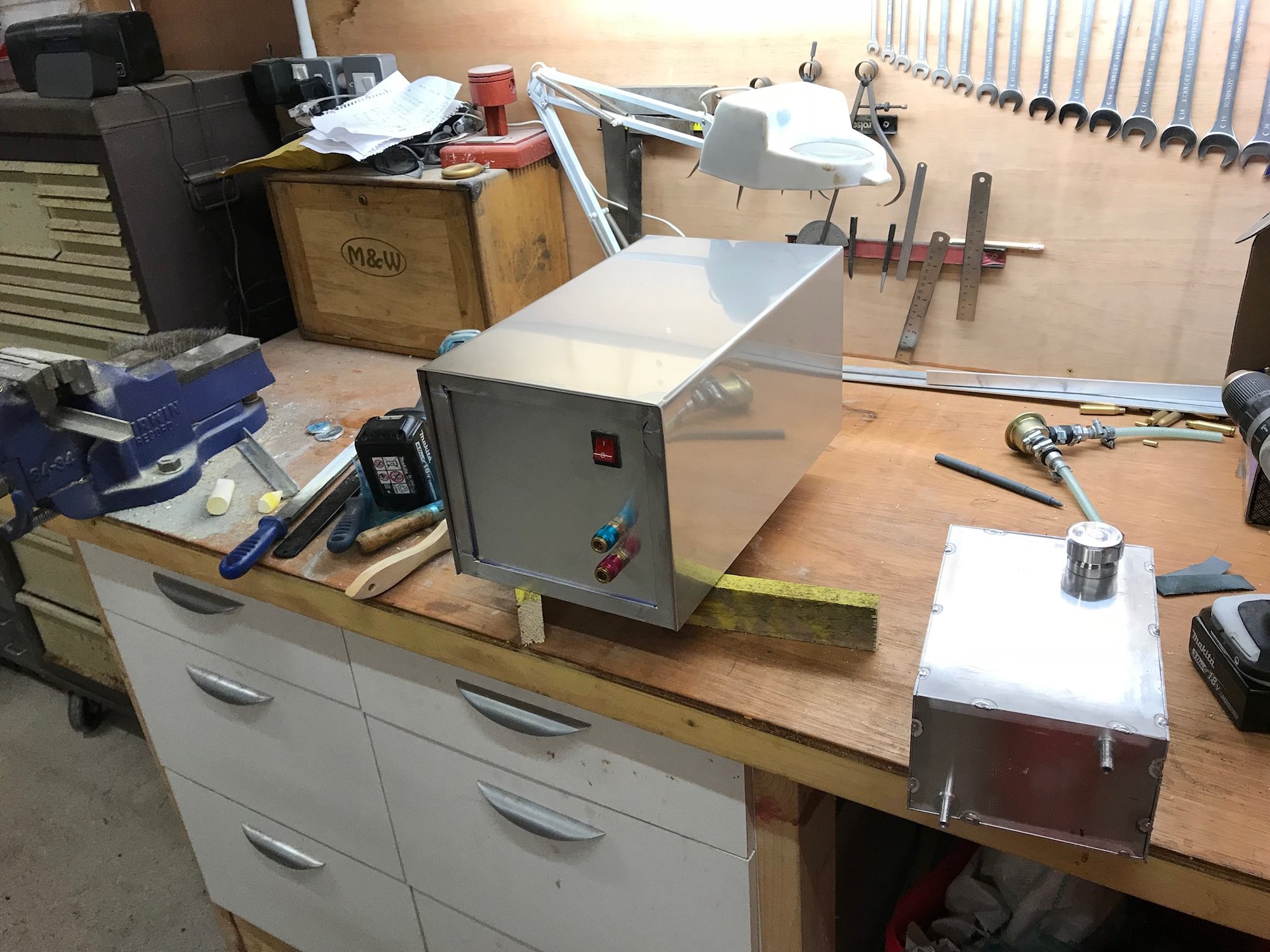

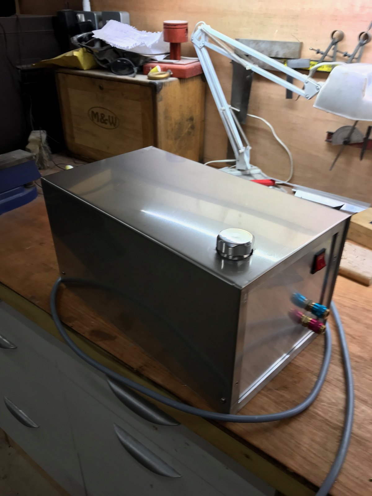

Today I had a bit of time to myself, so played with the tractor got it running, welded up the sheep race, then machined all the fittings and diameter adapters for my cooler project, run it on test for an hour, couple of minor leaks nothing thread sealant wont fix. Big thing no vibration at the torch.
Just need to make the box now!
