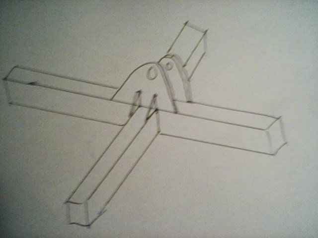

Exactly wyn. Design is certainly your friend if power is lacking. A good design can take the forces and stresses right off a welded joint. In theory you could build that to take a ton easy with a 150 Clarke (I don’t recommend you try) if the design allows loading to be placed on the steel rather than the welds.When i'm sticking brackets and things onto box section i always try and brace it so the forces are acting down the sides of the box section.
When the bracket is on the face of the box section it can flex the surface and start to crack.
So many people go for the brute force approach, if well designed, this could probably be safely constructed with half the weight of steel
I do completely agree. I’d much rather do it like that also. But, I can’t see any way without very expensive tooling to make that work in this application.When i'm sticking brackets and things onto box section i always try and brace it so the forces are acting down the sides of the box section.
Yes I guess so actually. Putting shackles through will just be a pain though.You could use two of the plates with the holes and four of the smaller gussets with a pin through the holes to fix a shackle or the lifting hook.

Again, I’m my eyes just needless work. Each corner is only holding no more than 200-300kg. That weight spread over 480mm leverage, it doesn’t even flex with that IBC. My friend put a straight edge to it.if you want it to be stronger... on the next one can you make the eye in the center a bit taller ?
then you can add a flat bar from just below the eye out to each corner lifting point
so then instead of your lift depending on not bending the box section, instead it's pulling on the flat bar (which you'll never stretch) and compressing your box section (which you'll never compress... (as long as you don't bend it))
Oh off course. Something that’s quite easy to overlook is the fact that each corner wouldn’t be exceeding 250-300kg as I’ve just said above. That over 480mm long 5mm box, it didn’t move at all.And neither do I,
