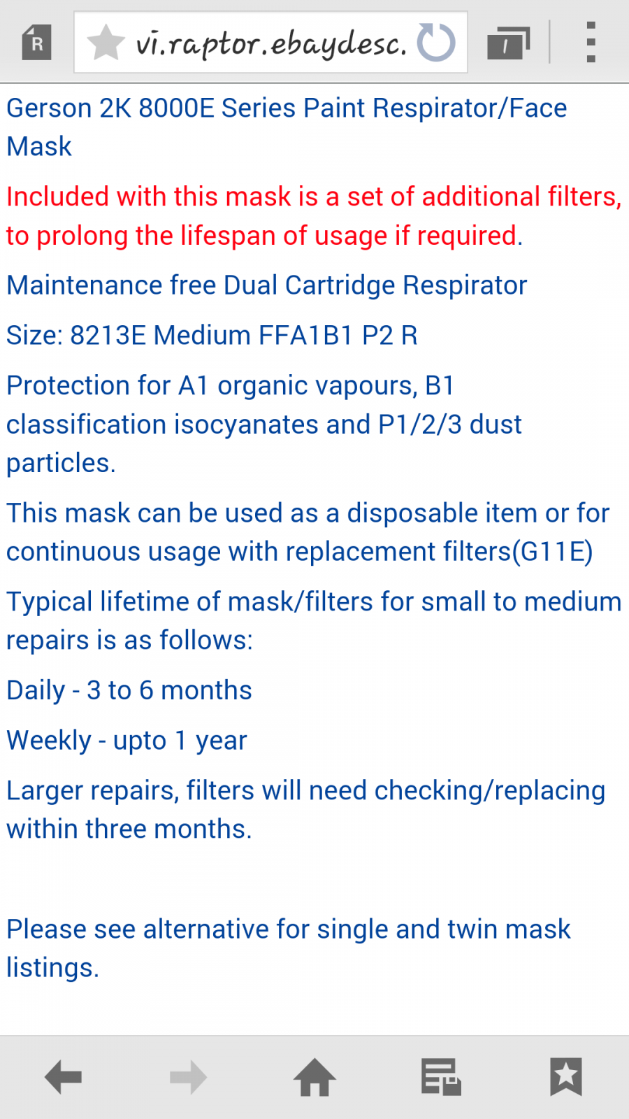

What’s the electric Sundstrom you guys are talking about? Are you just talking about the battery powered electric filter pack? As that’s not a substitute for an air-fed mask if that’s what you are talking about.
Yes my two 14.5cfm compressors will run my spray gun and air fed mask no bother.
Yes the electric mask. According to Swedish department tests it is isocyanate safe. Yes two compressors would work. I have one plus two DIY compressors but plan to switch to two 14 CFM machines and sell the DIY compressors.
