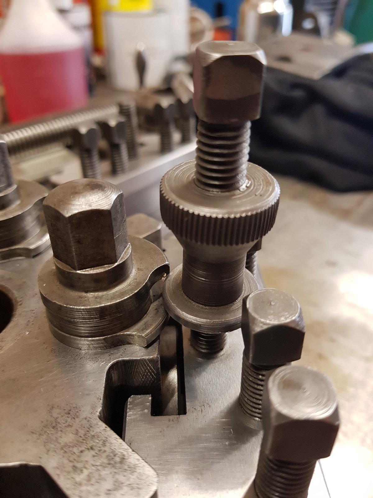

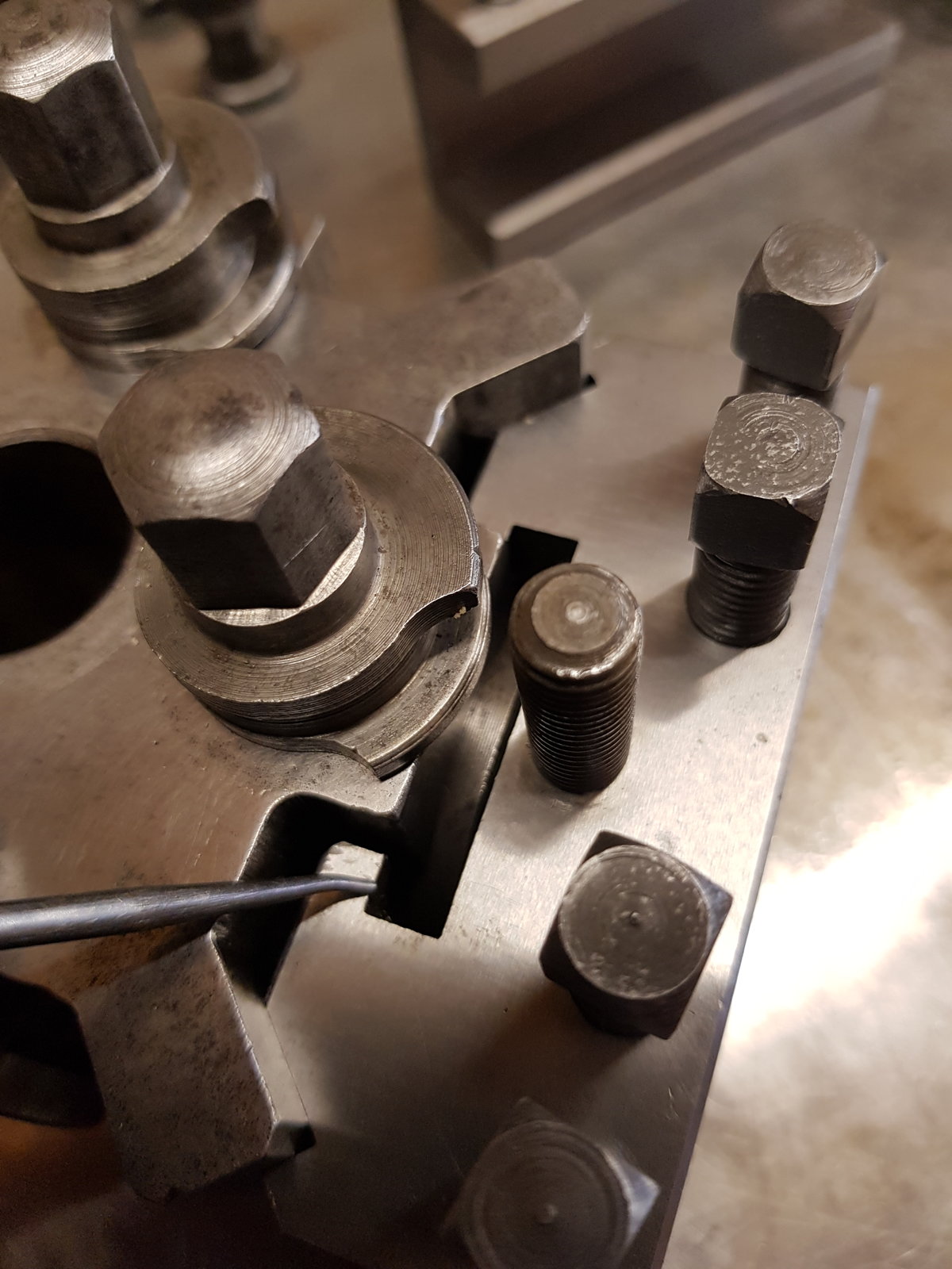

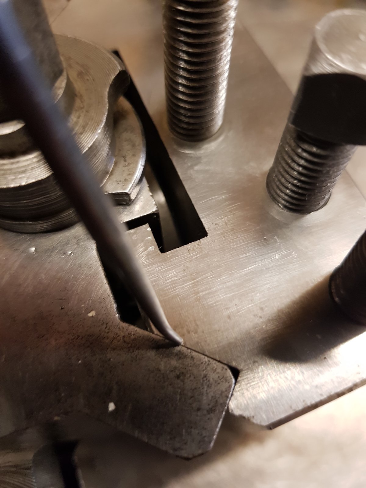

They have a small spring in each one. So once you remove the cam spindle just let the preasure off slowly. You might have to prize the cam spindle out because it will be full of crud. The spindle has two cams that operate the tool holder. These have to be lined up for the removal and re fitting. Hope that makes sense
