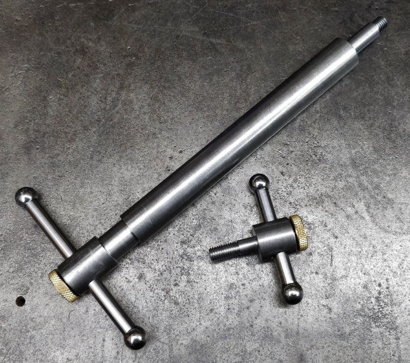

Next up was some welding.

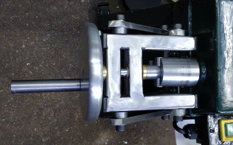

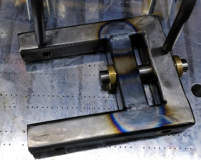

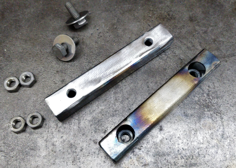

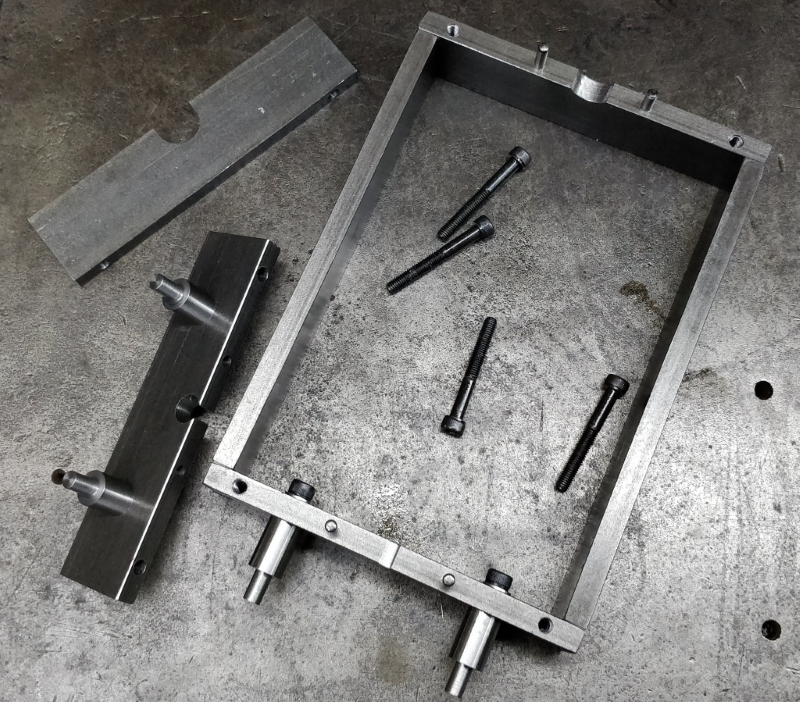

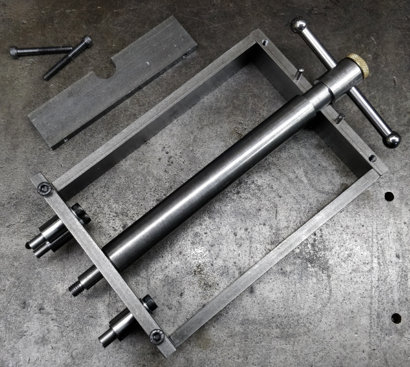

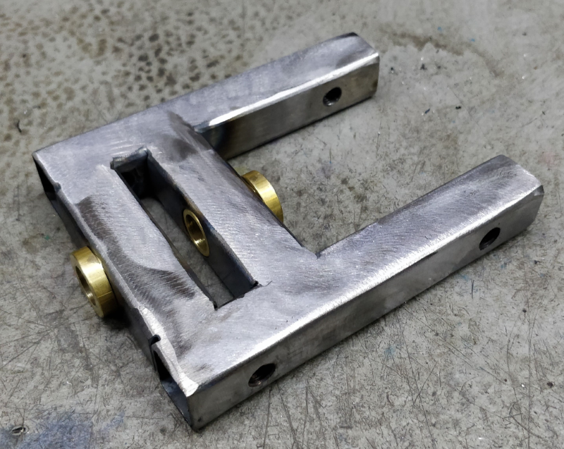

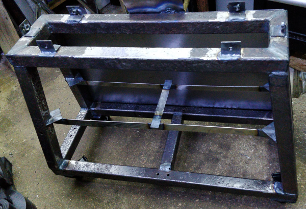

I had some offcuts of 20 × 20 × 2 mm box section, so these got trimmed slightly such that I had two long pieces and two short pieces. Holes were drilled and then I welded some nuts (four per length) into the longer sections.
The photo above shows what the longer lengths looked like with the first pairs of nuts welded in and the welds cleaned up with an 80 grit flap disc. I then used the M8 screw you can see at the top of the photo (which had been in the citric acid bath with the nuts to get rid of the zinc plating) to make sure the nuts in the other side of the box section were thread-aligned with the ones already fitted.
I turned up some brass bushes (I don't know how good brass is compared to, e.g., Phosphor Bronze, but I don't have any bronze in the right size and it's not going to be working that hard, so I'd guess it'll be fine). I also drilled some holes in a couple of bits of angle offcut and welded some nuts by one of the holes in each piece. Then the frame got welded together, first the outer pieces:
Then I used an offcut of 12 mm silver steel to hold the bushes in alignment and welded the cross-member in place:
All cleaned up:

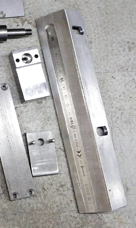

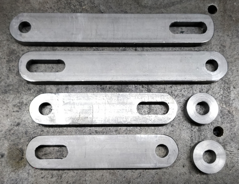

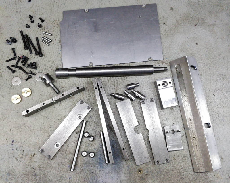

Last manufacturing job was some more washers and some "uprights" - these were made out of 8 × 20 mm steel purely because it's what I had. Probably overkill being 8 mm thick!

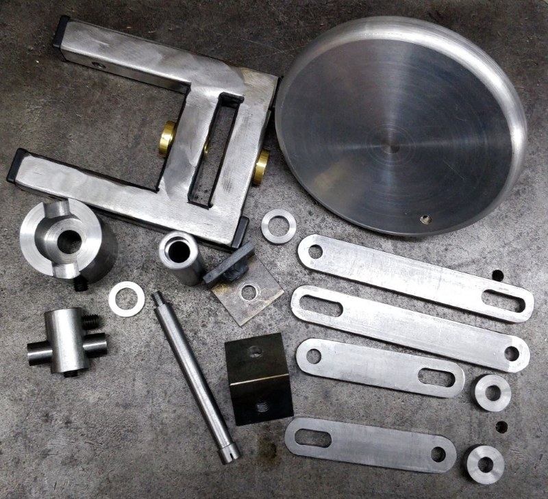

Here's all the bits together:

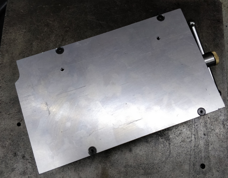

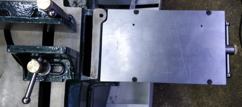

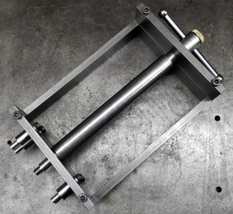

Assembly was a bit of a pig as a result of the amount the lead screw wobbles / precesses. Essentially a case of getting it together, then fiddling until it runs smoothly for the vast majority of the length of travel of the moving jaw.

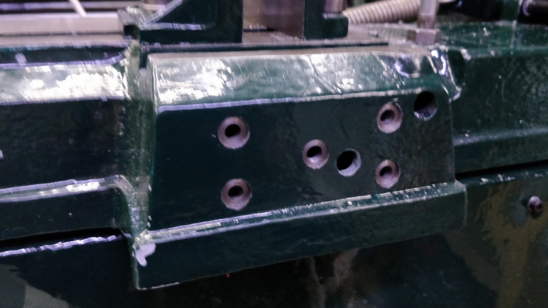

First the angle got attached (after drilling and tapping some M6 holes in the base frame - the holes in the angle are 8 mm to allow for some adjustment here).
Then the rest of the frame was built on top and everything tweaked and tweaked and tweaked until it was right (this took about an hour!)

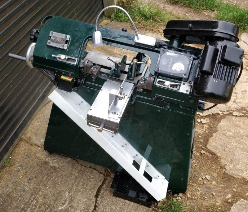

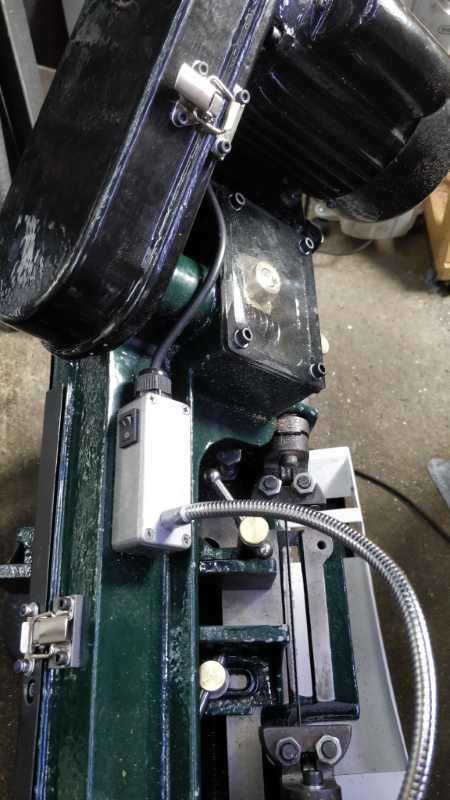

Here's a shot with the top arm down: the vice handle is readily accessible:
This was a lot of work, but hopefully will deal with the longest standing annoyance that I've had with the saw (which had also been exacerbated by the lack of a blade wheel cover at the moment: although the saw is off when I'm loosening the vice, the blade is still sharp!)
