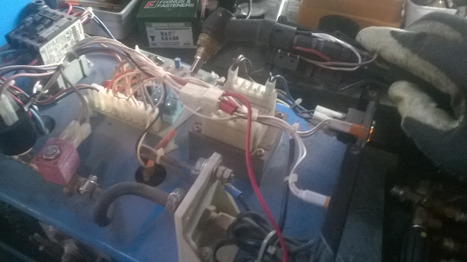

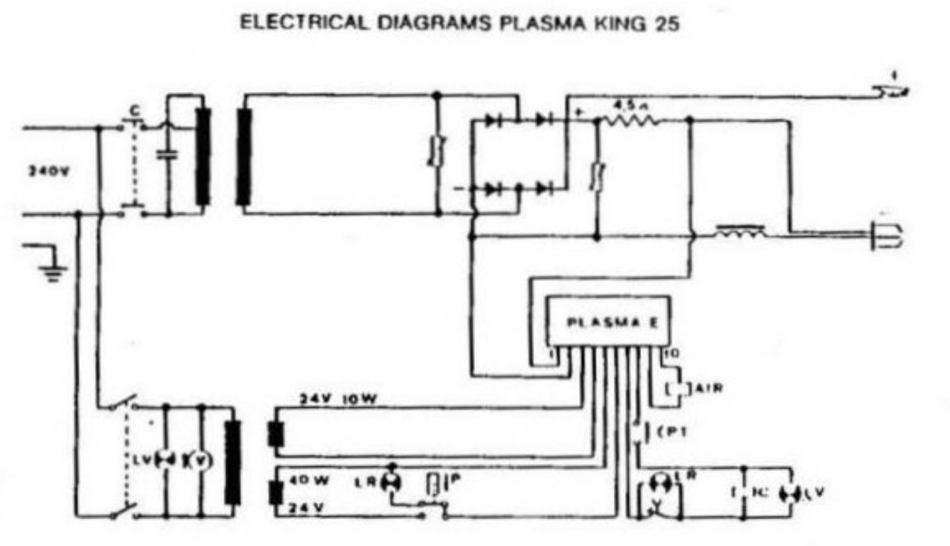

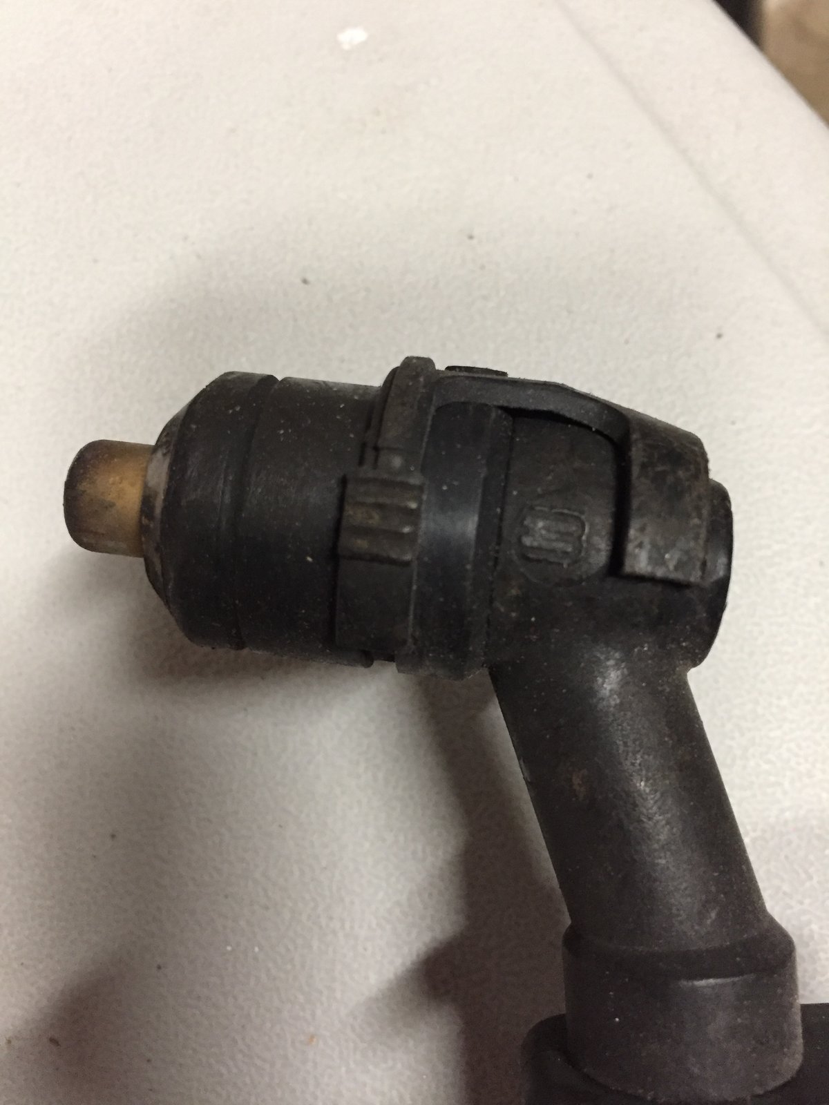

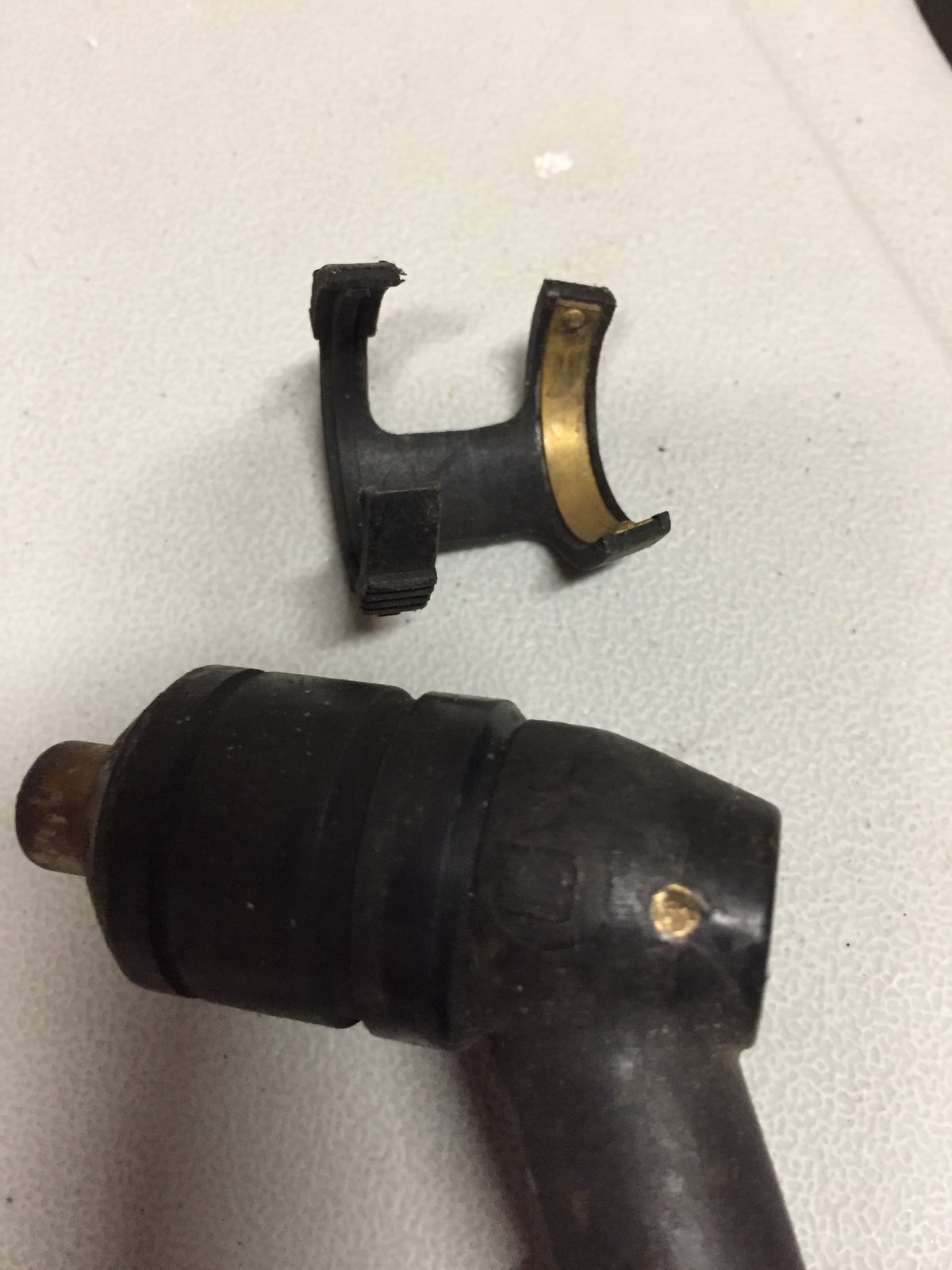

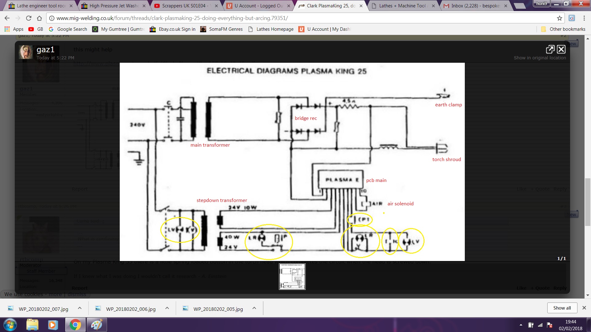

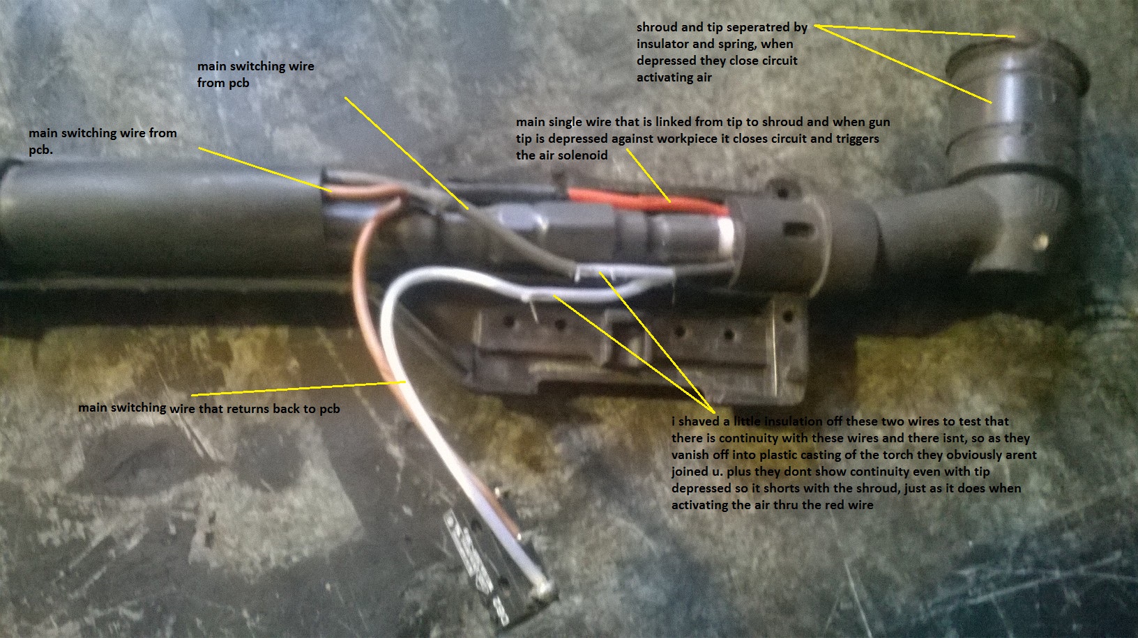

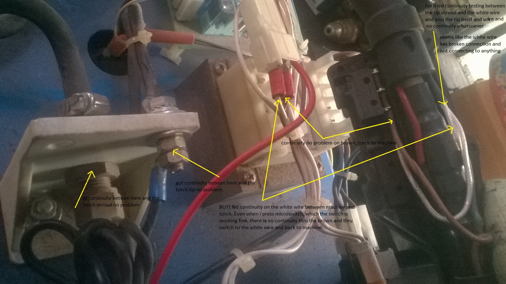

doing everything other than arcing.. new tips, done nothing. so i opened torch and noticed their isnt and continuity between switch wires, brown and white. the brown seems fine from machine to torch. the switch is fine.
What is confusing me is? Is there supposed to be something within the tip that completes this circuit..
As their is white wire goign from switch into the tip itself and then the main white wire coming back out of the tip and goes back to machine.... There isnt any continuity between the start of the white wire at the gun switch andas it passes thru torch tip and back to machine there is nothing.
see pics it may show th.ings clearer
