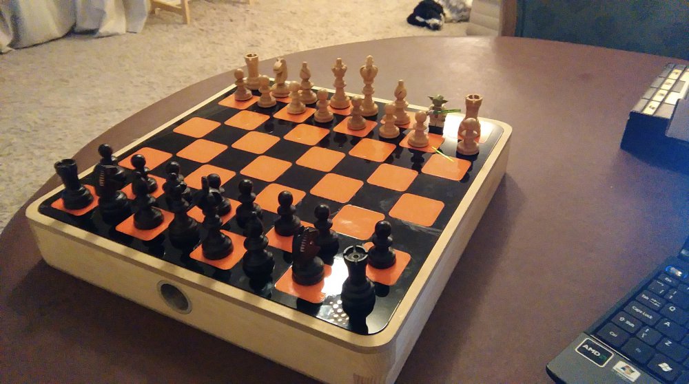

This is the chess board I made as my final piece for my resistant materials GCSE. It's mainly laser cut because using CAM pushes the grade up, even though it's very unskilled work.
The board is made from black and orange 3mm acrylic. I laser cut all the squares out then glued it all back to back so it can be flipped over to be mainly orange. I machined a couple of aluminium rings to poke your finger through to press the board out to flip it over or get to the storage inside.
The wooden sides are assembled with half lap joints, held together by the base and top edge. The bottom, top edge and insides are all 3mm laser cut MDF.
I'm very happy with it overall, now I just need to learn how to play.
Lego Yoda is there because our dog ate the horse.
