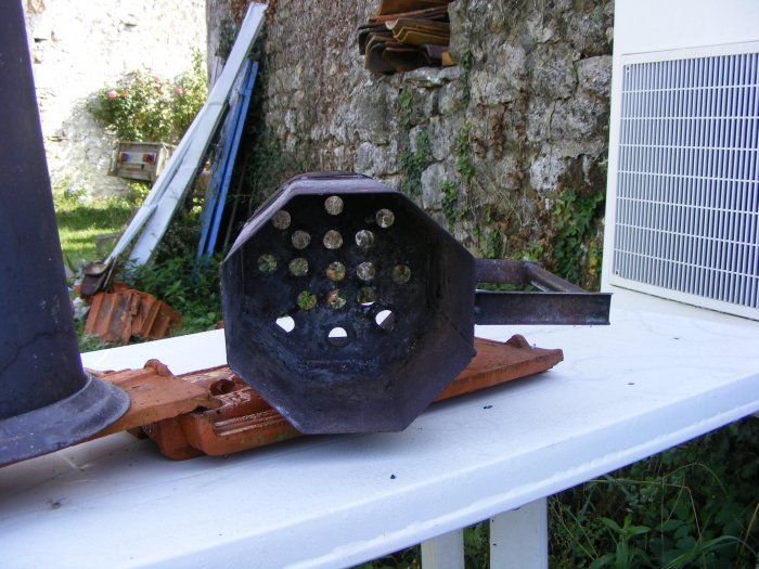

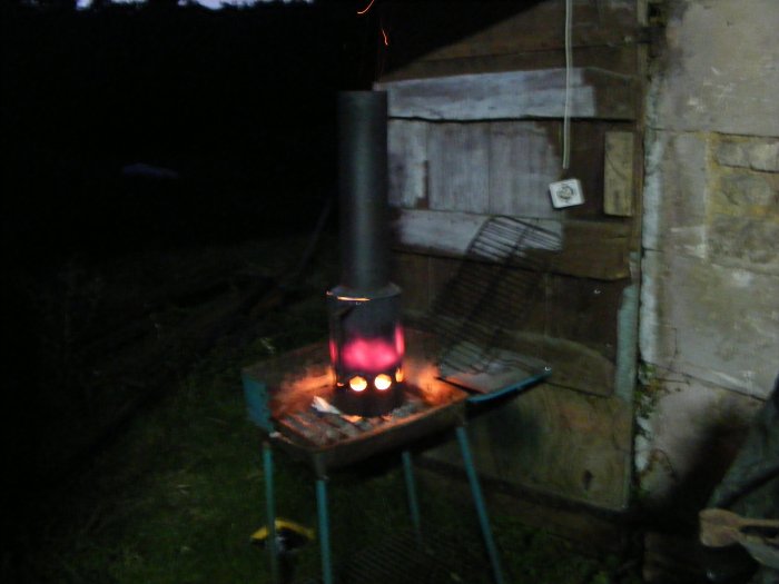

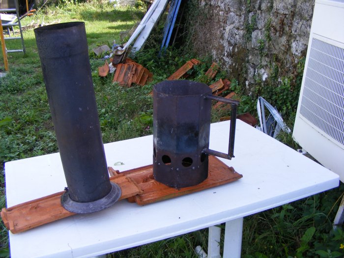

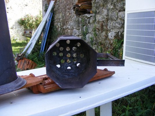

We use the BBQ a couple of times a week and lighting up was always a bit hassle. Some years ago I had a starter, so made this to a similar style. The torn & crumpled newspaper goes under the grid and the coal on top. After a couple of goes, I increased the space for the paper and now it is fill and forget for 15min. So, if making another one, the side holes should be at the bottom. The bit of stove pipe and collar are rested on top to increase the draft. Final pic is just before I dumped them on the grill. (use a glove!!)
