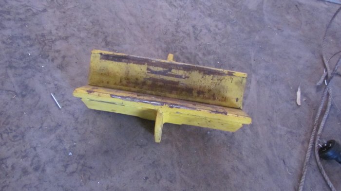

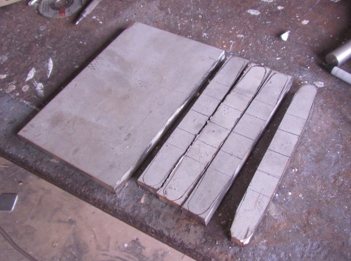

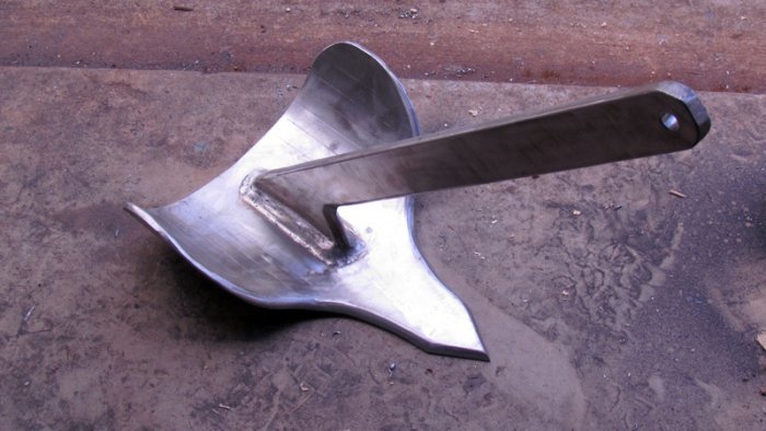

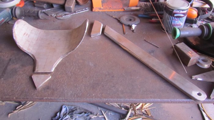

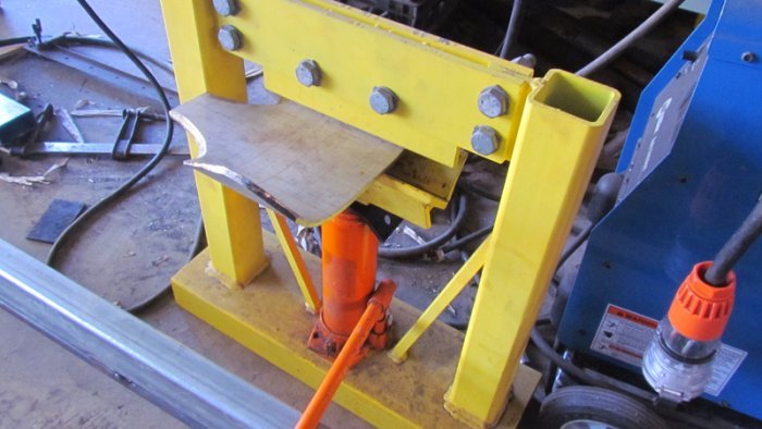

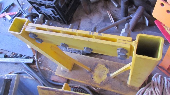

Built a anchor for the boat, made it out of 316 8mm plate with a 50mm x 16mm shank, cut out the bits and joined some as I didn't have a big enough plate. Made the curve on the fluke on my home made bender using a hydraulic bottle jack that I used from a 12 ton pipe bender, one of these day I will get a 16 ton jack as it will give me more grunt. It was struggling a bit on the 8mm thick plate.

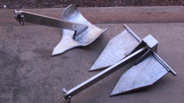

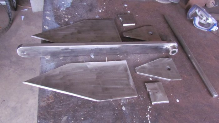

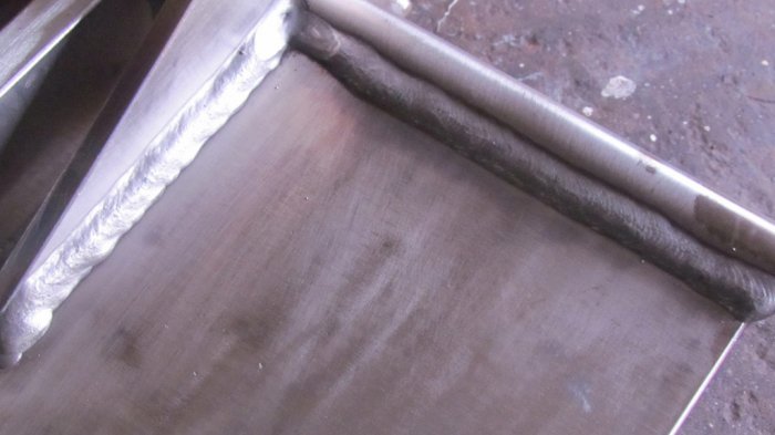

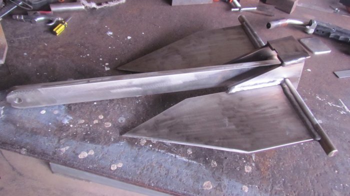

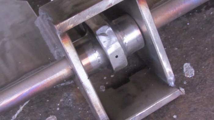

Today I made another anchor, as a spare in case the first one gets snagged or I get caught in a storm and need a bit more holding power, again made out of 8mm 316 plate and a 50mm x 16mm shank with a 19mm round bar for the top of the flukes, I TIG'd the bushes on to the shaft then reamed it out to make it the right size, drilled a small hole in the end of the shaft so that I can push grease in to it later on, the rest of it was MIG welded using 316sli wire.
My welds aren't as good as I would have liked them as it bucketed rain here today and with the sudden temperature drop the hood lens kept fogging up, so I had to wing it for most of the welds, hate it when I can't see the weld pool, the beads were larger than I wanted them to be. Anyway they should hold.

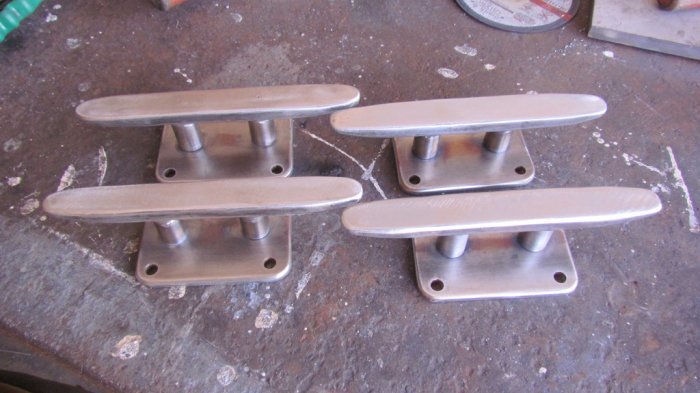

So now that completes the anchoring gear and next job is to work on the electric winch setup, some more boat cleats, and 2 seat bases.
welded up and welds needing a grind and polish IMG_0640.jpg55.3 KB · Views: 1,588
