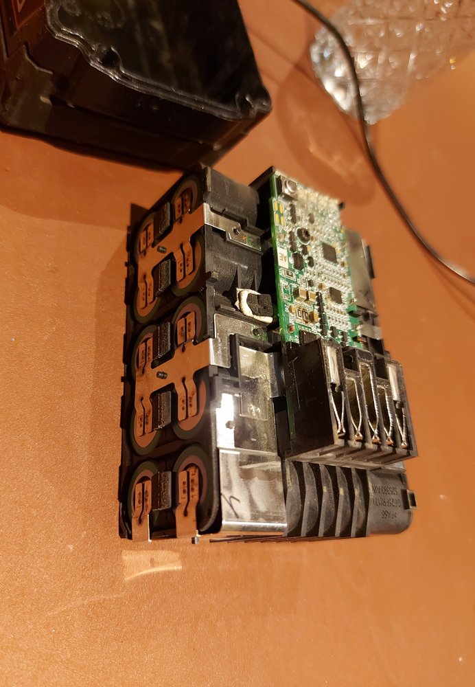

I tested it and each cell is showing 3.6v

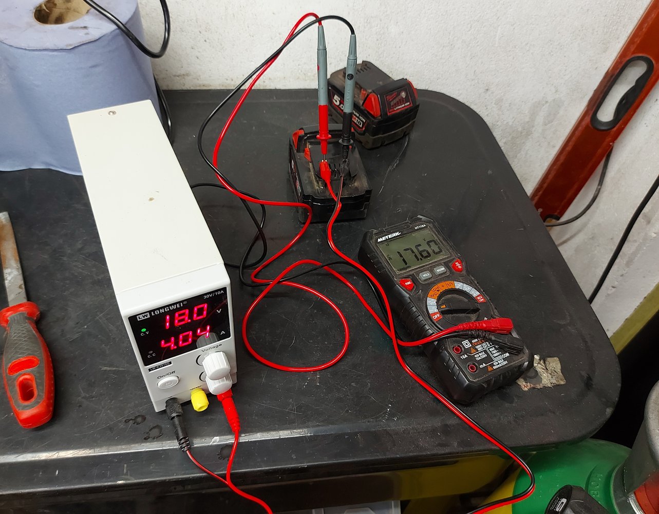

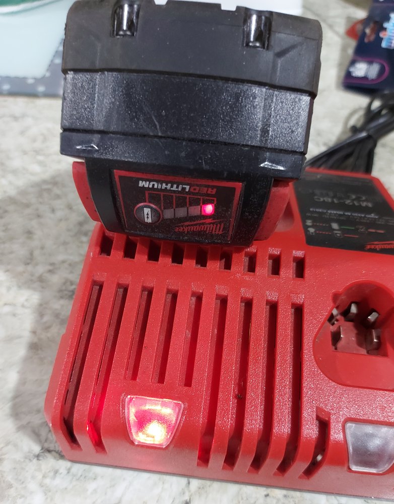

This young and nearly new looking genuine M18 battery was in my other garage on a Milwaukee torch unused for months. I went to use it this morning and it was completely discharged. Milwaukee charger won't recognise it so I'm trying this. Amps are steadily going down which would suggest it's accepting a charge?
The battery status indicator still appears dead though.
