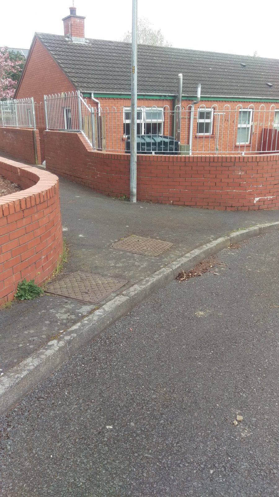

Every hole drilled and every bar bent by me. This job took so long I'm glad to see the back of it haha I wish the boss would get me another pair of hands

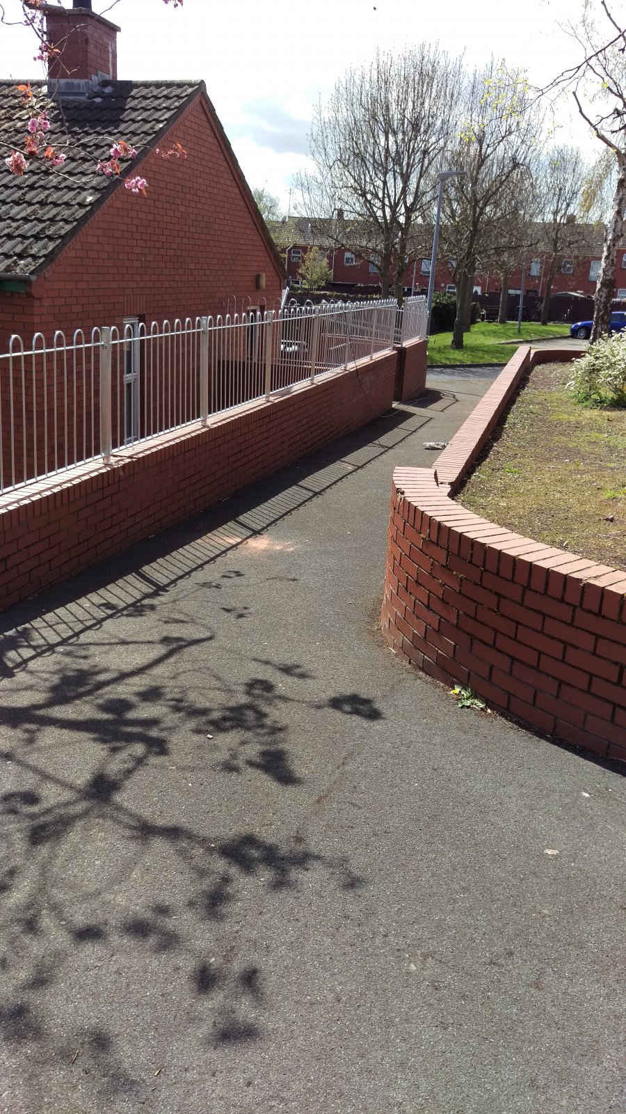

Using the phone camera haha and they wanted this made because the young ones on the estate like to sit on the wall haha
I used a jig chris just cut some pieces of 12mm round and weld them to a piece of 150mm x 10mm plate. Draw a half circle on the plate and put the 12mm round in place then bend some sheet until it takes the right shape. Put some 42mm pipe in the center of the jig for an arm to slide into so you can keep the bar tight on the jig when pulling it around. Then just a piece of square bar on the side to hold the bar in place if you can make sense of that :3 and the job was for a house in lurgan
