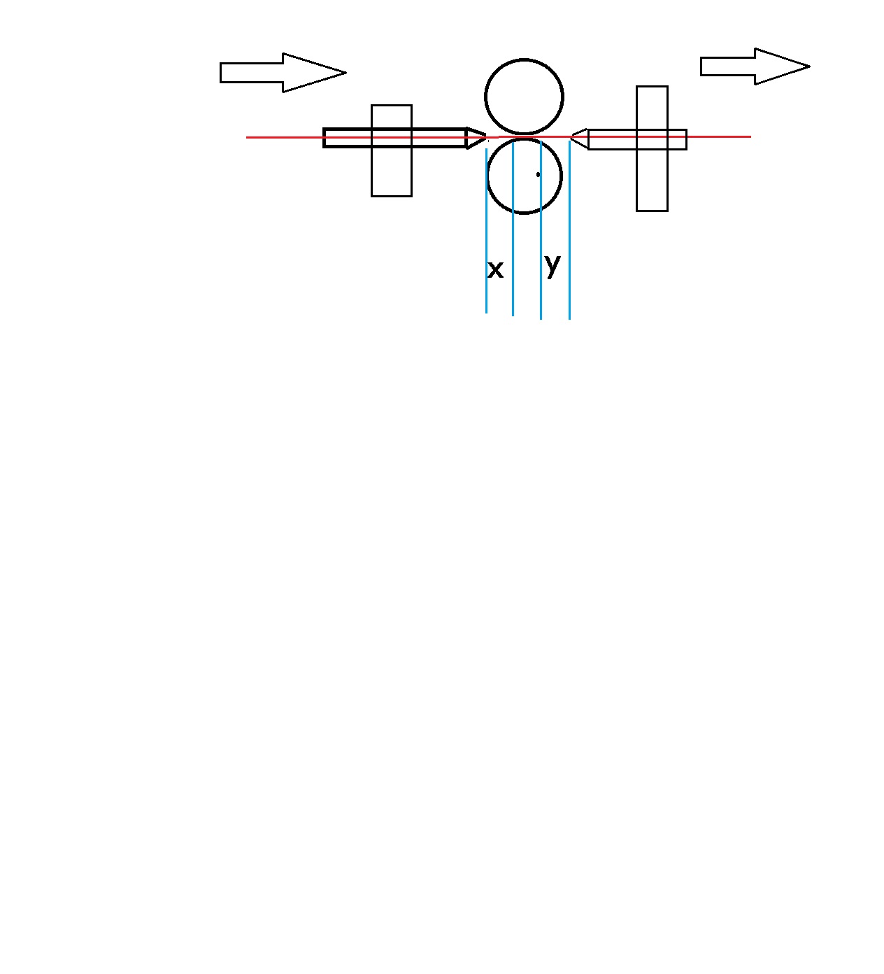

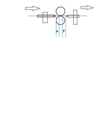

  16. mike 109444
    mike 109444 Member
    Messages:
    3,817
    uk Bristol
    One thing to adjust if you can is the IN feed and OUT feed gaps. Looking at pic if you can get the guide pipe as close as possible (virtually torching the roller) for the IN and OUT (the out may not be adjustable)
    This reduces where the wire can "escape" from to cause a birds nest.
    One way to check the tension of the spool over run is fires clear any birds nest. then feed say 62 of wire out of the tip. Now release/unlatch the feed roller so it is applying NO force to the wire. If you now grip the wire sticking out of the torch with pliers you should be able to easily pull the wire through from the spool BUT when you stop pulling the spool should NOT over run. The weight of the spool should stop most of the over run so very little pressure should be applied to the spool clutch/nut.
