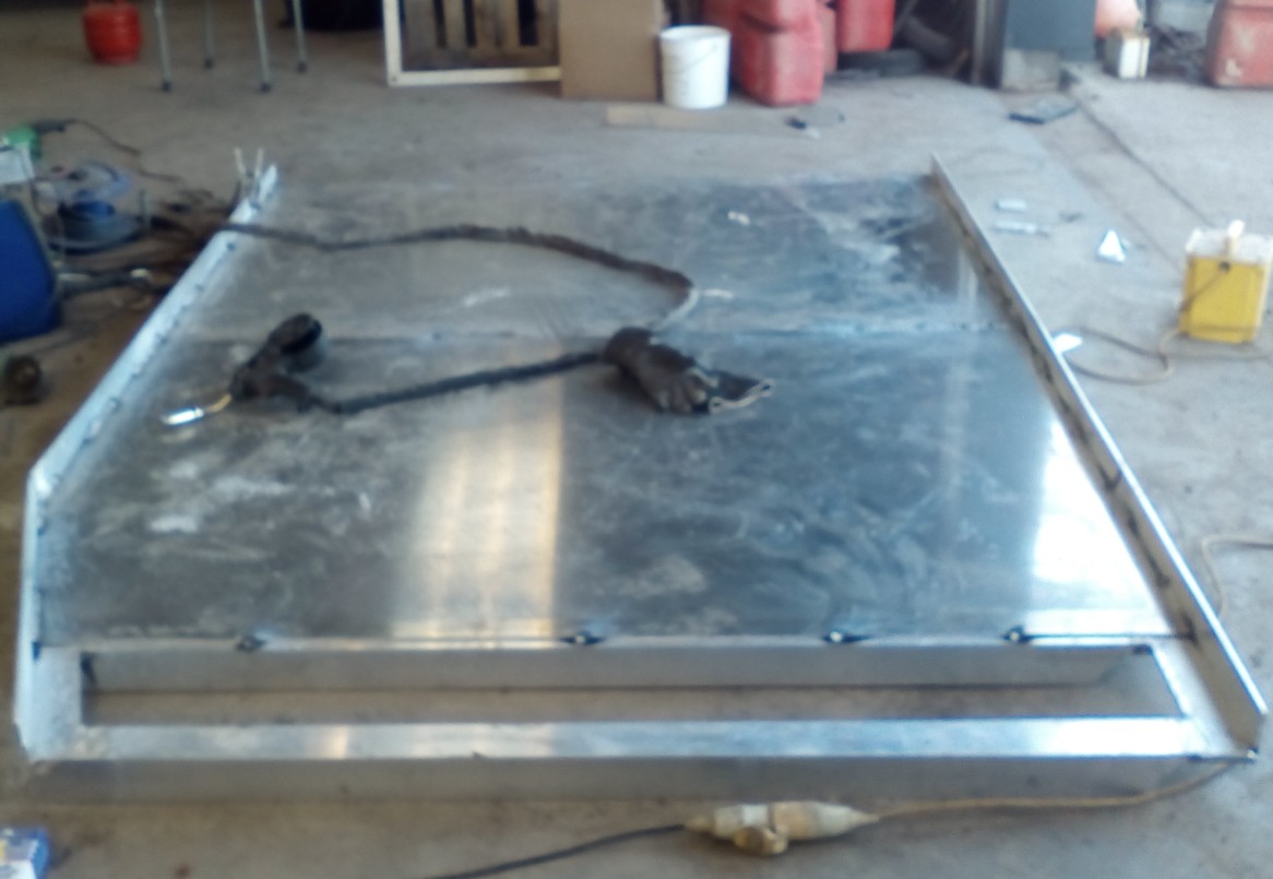

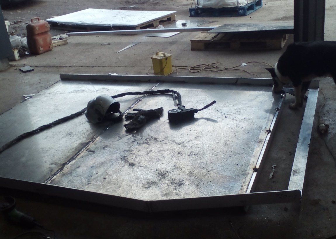

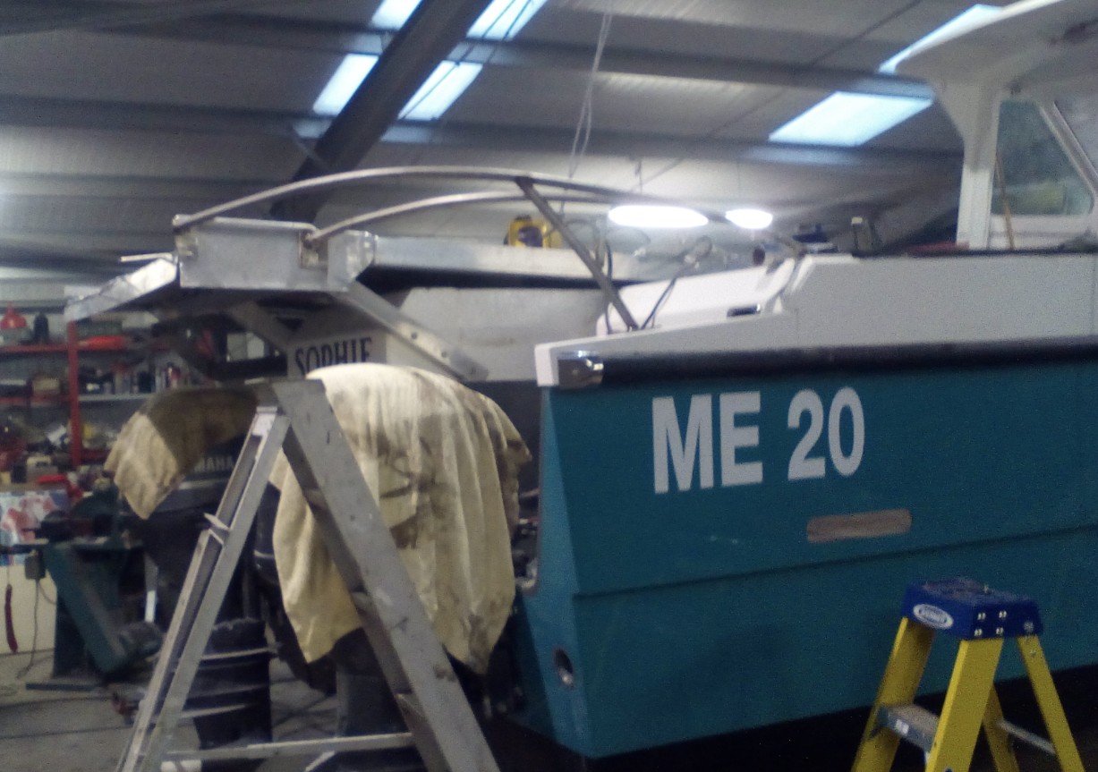

Today I was doing some more welding, 3" x 3" x 1/4" 6082 and 5mm 5083 sheet, to make the first section of a shooting table for a boat I am helping fit out.
I went through 4 rolls of 5356 wire in the spool gun today and the welding went well, very happy.
Few pics below, sadly my phones lens was dirty and I never noticed until I saw the pics on the home computer but hopefully they are good enough.

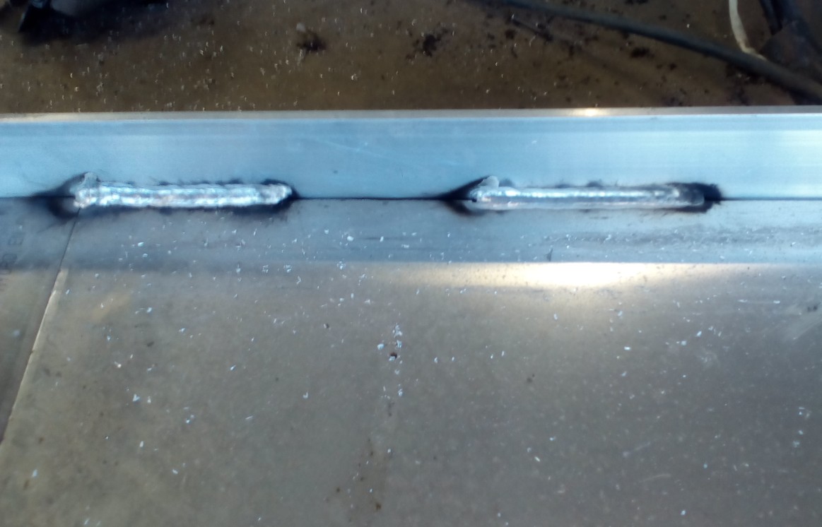

Lastly a close up of the welds, sadly not the clearest but should give an idea of the ability of the MTS255S
