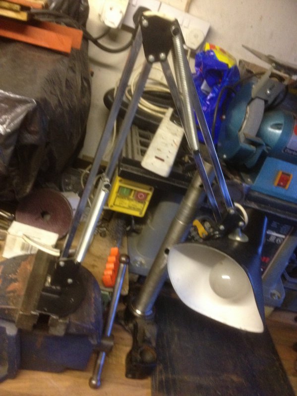

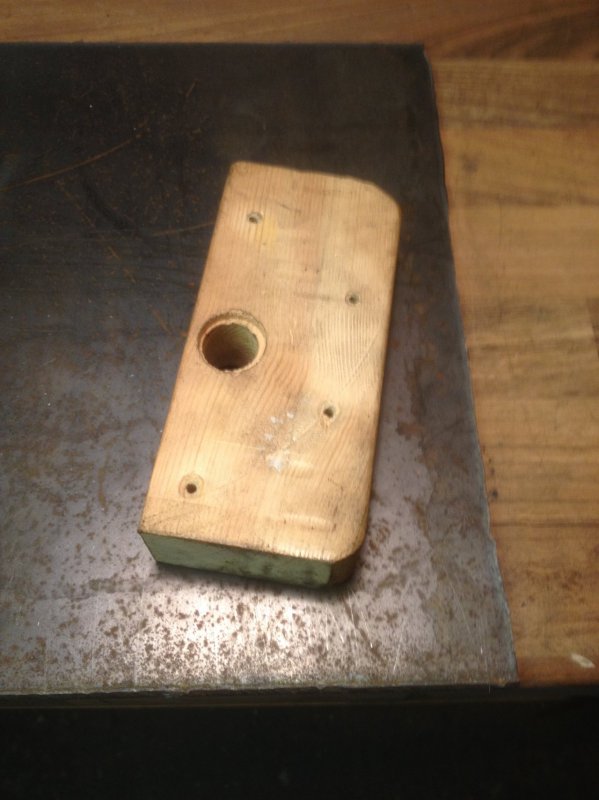

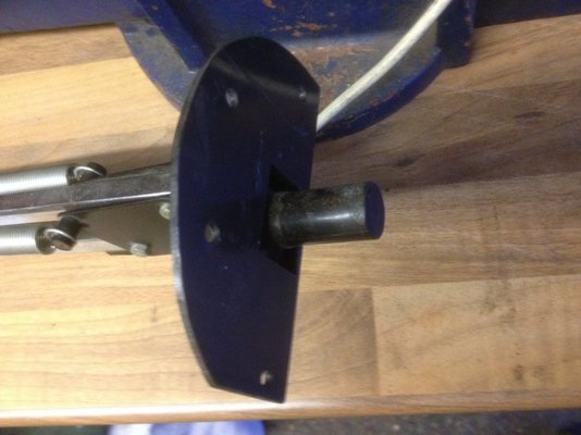

well i thought it was time to have a bench light, to help see when welding and fabricating.
i remember getting a desk light as one of the many things from my late fathers stuff,
didn't use it as i have a few ikea 12v lights.
so i dug it out.
i did buy a BC to GU10 adaptor and 50w halagon bulb for it.
i did have it mounted to a piece of wood to make it easy to clamp down.
so decided to try something that will allow it to stand up without having to clamp it.

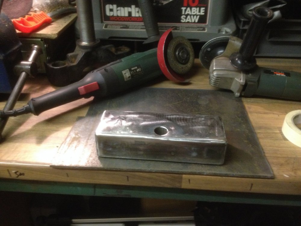

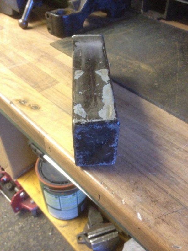

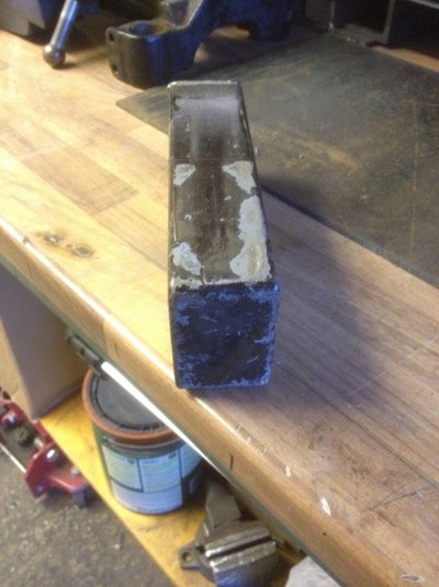

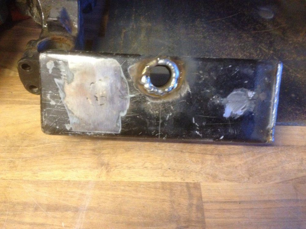

bit of an off cut from my dolly frame i have as i found it too wide.
not so easy to mount the light, due to the base.

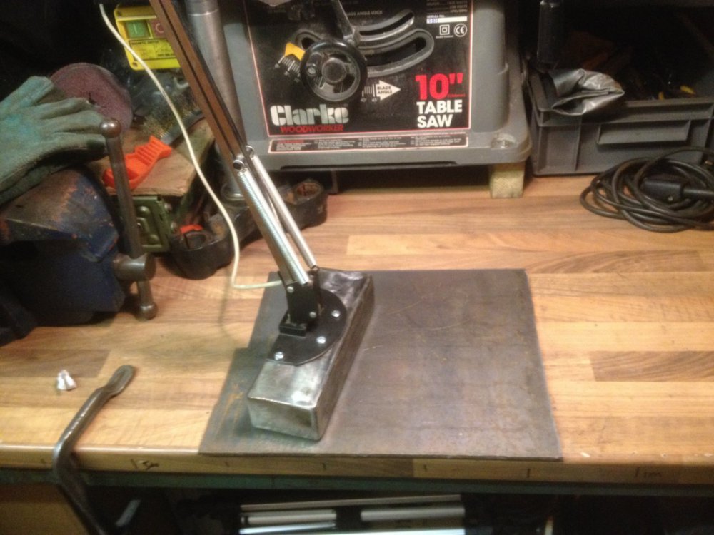

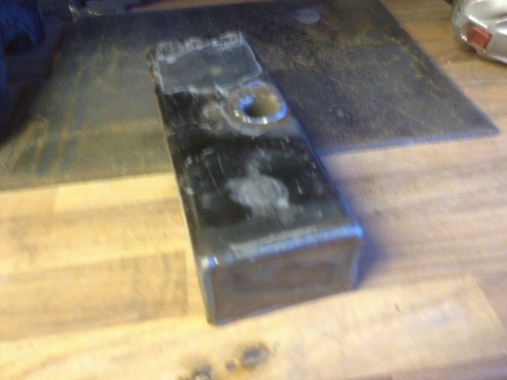

so i decided to cap the end that was open, and add a tube into the box to allow the light to mount.

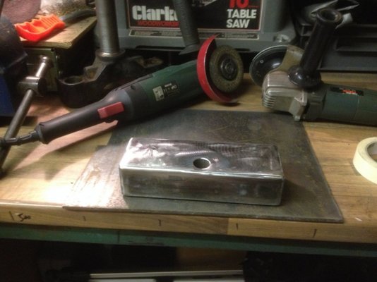

bit of a clean up of the welds and remove the old paint.
drilled the holes and mounted the light.
so now i need to fill it with something to make it heavy.
dry sand i guess would be best ?.
concrete would start it off rusting, lead would be a nightmare trying to pour that amount.
