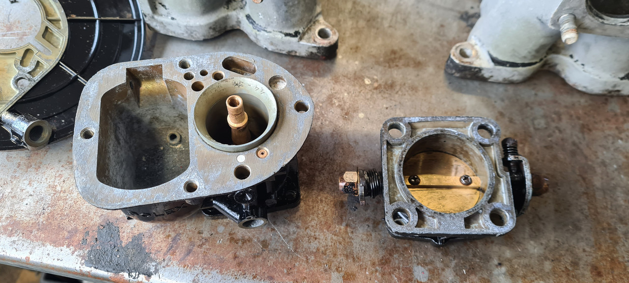

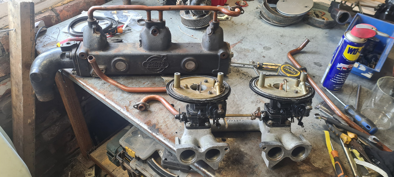

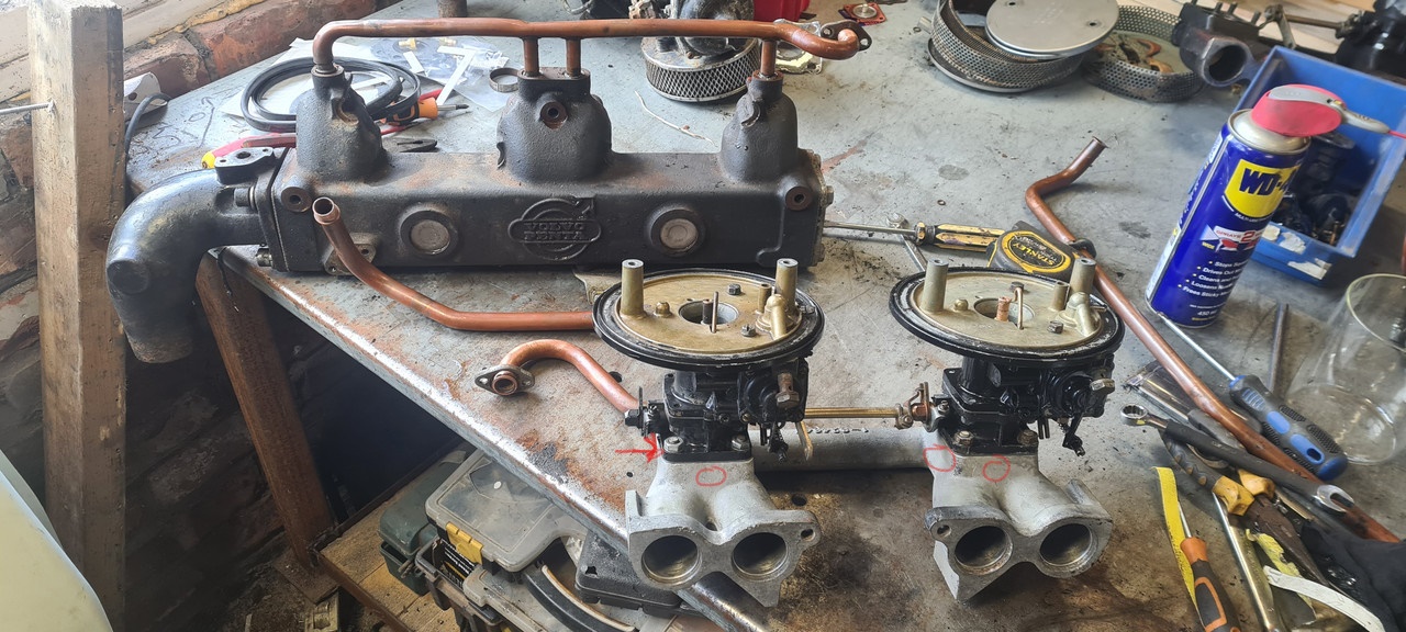

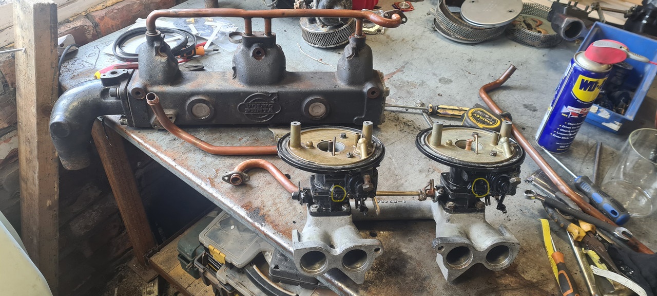

No nothing there. thanks though for idea.Are there removable screws or plugs in the yellow circles, if so you could possibly use a motorbike carb balancer??
No not eight but I can do six with a hose.Try getting eight itb’s balanced at idle when they don’t share a common plenum

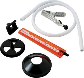

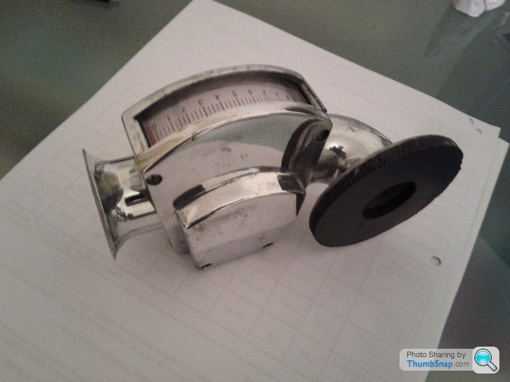

I have one just like that, but somewhat less shiny!I have one of these somewhere in the workshop... and used to tune my SU carbs on my Rover V8 with it plus other twin carb set ups.
View attachment 343900 View attachment 343901
You take the air filters off before trying to fit the vac gauge! Sory flowmeter.
I will elaborate on my first post, seeing as the penny does not seem to have dropped, with you or anyone else. You have only taken the elements off the air cleaners not the air cleaners themselves. Take the rest of the filter boxes off and you can use whatever carb balancer you want.
Two bolts facing downwards and one upwards in each air filter mounting flange. I could be wrong, but expect, once removed, standard carb flanges will be underneath, which can be fitted with those flowmeter type carb balancers.
My one as dull as ditch water as well with a cone, the shiny one an image of the web.....I have one just like that, but somewhat less shiny!
Also has a detatchable rubber cone thing that fits over that big rubber donut.
This is the first time I've seen another one!
