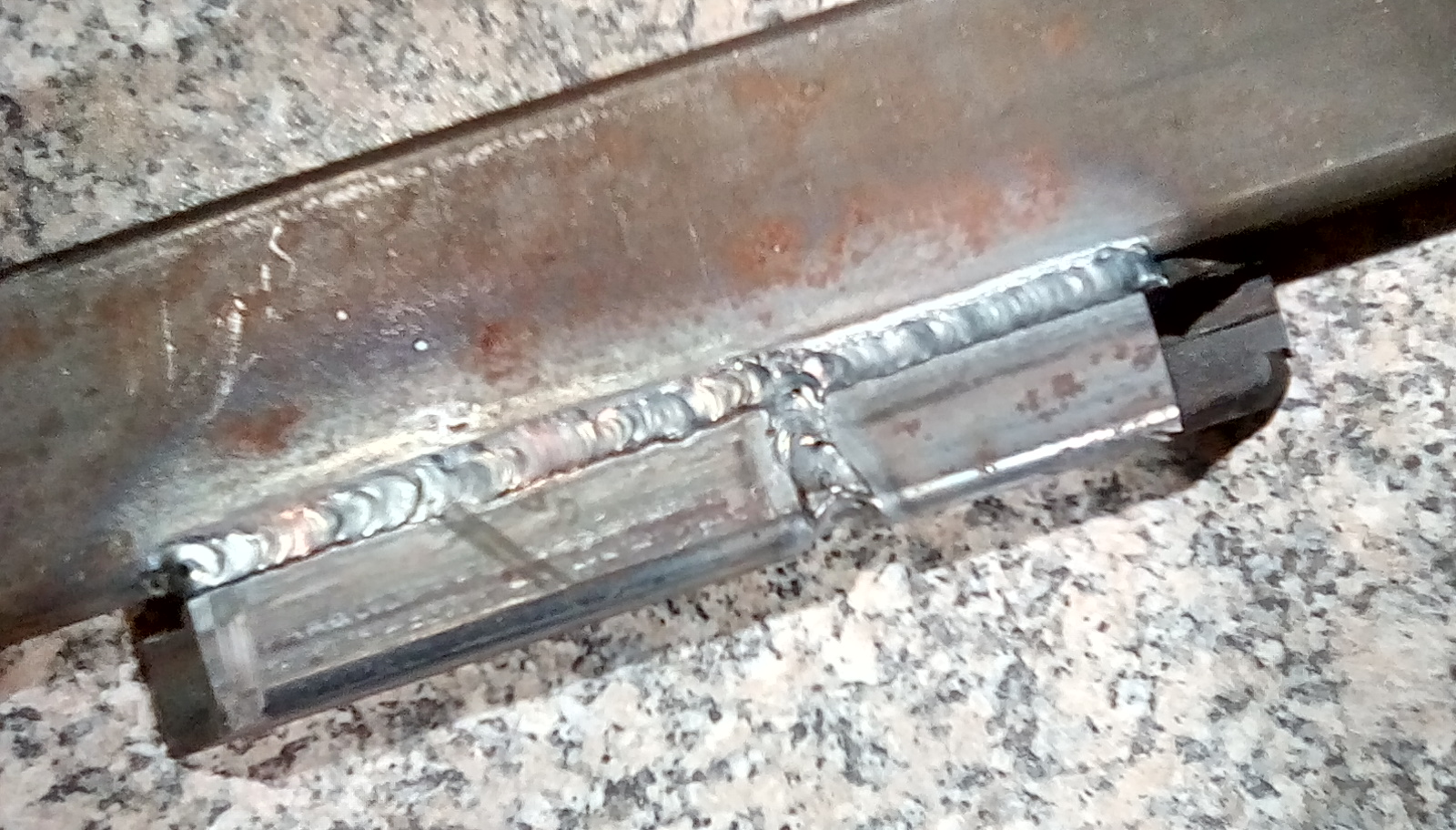

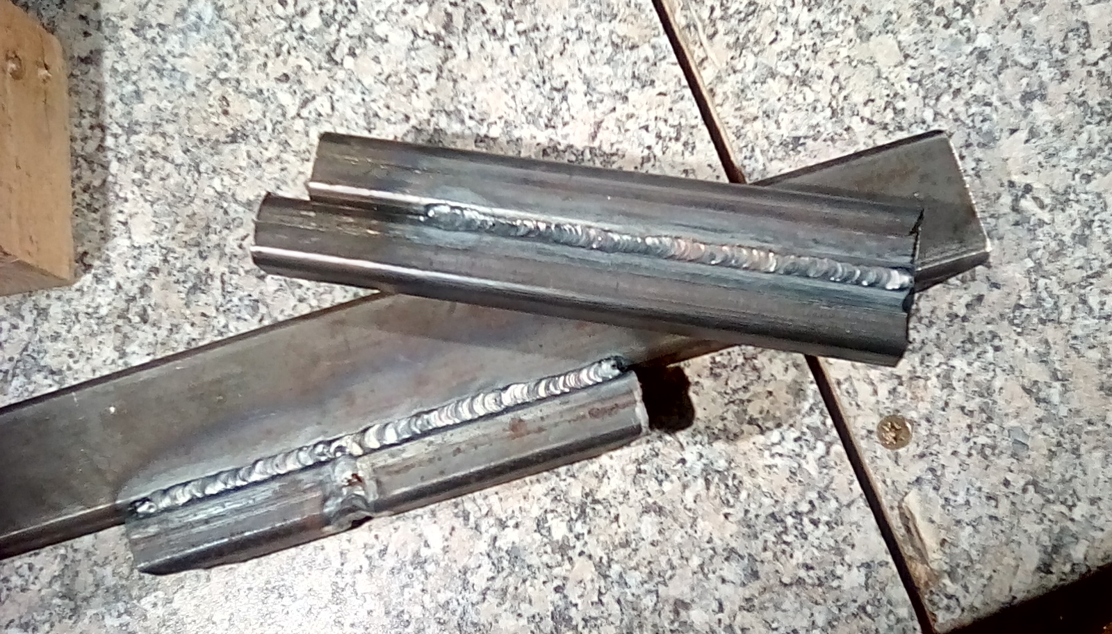

Exactly.prep is still the most important part

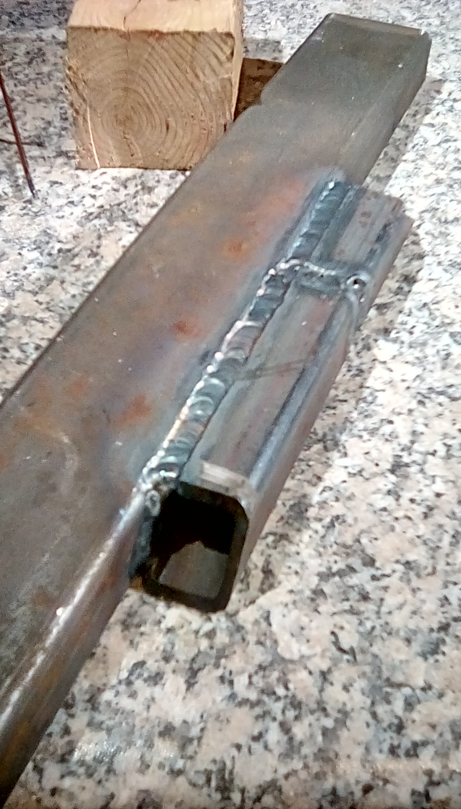

The box section needs cleaning up back to bright metal alsoI see clearly now,

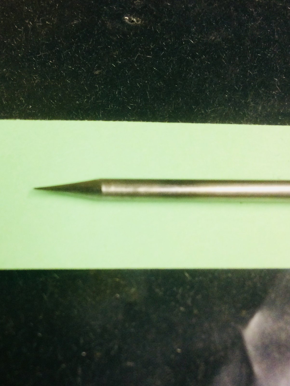

(The top was a lot worse than that prior to sharpening!)
Well will give it another go this week and try again with some different material,
The box section I'm using has quite rounded corners and welding it always is looking undercut.
