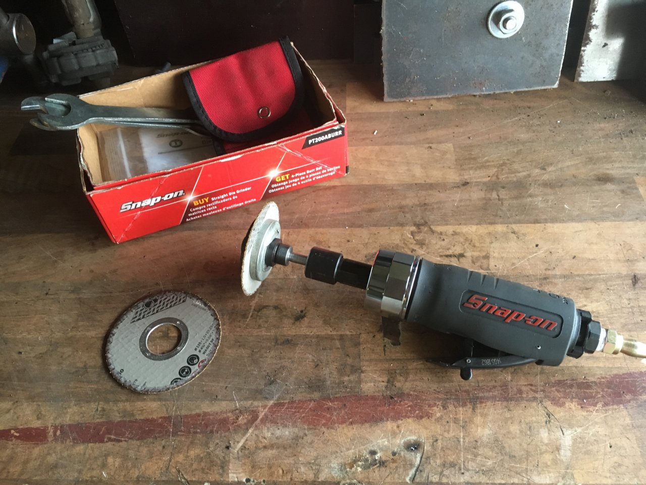

When you say die grinder have you got a speed control on it? Mine spins pretty quick and I'm not sure of the maximum speed on the 115mm discs.

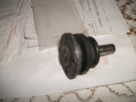

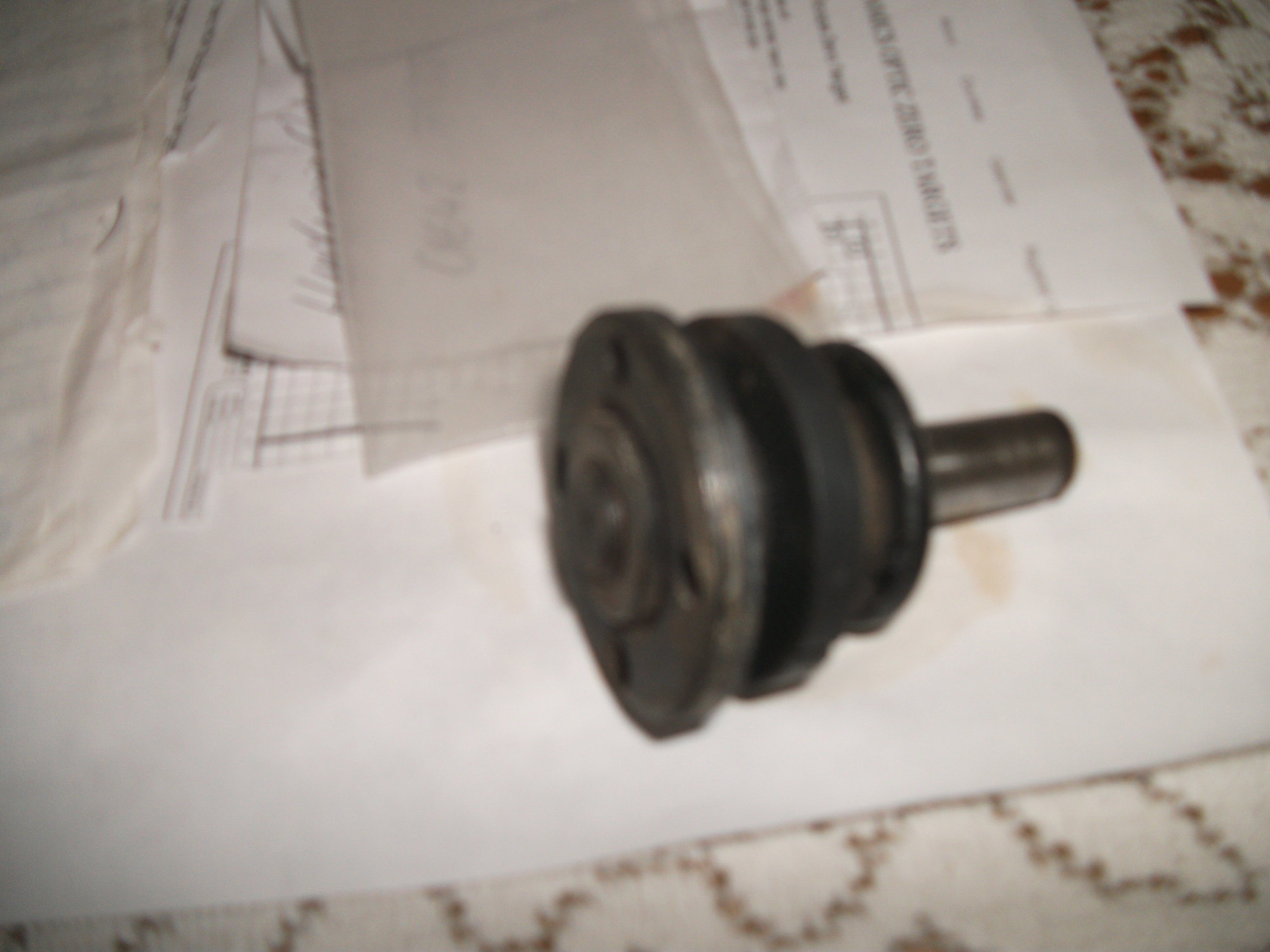

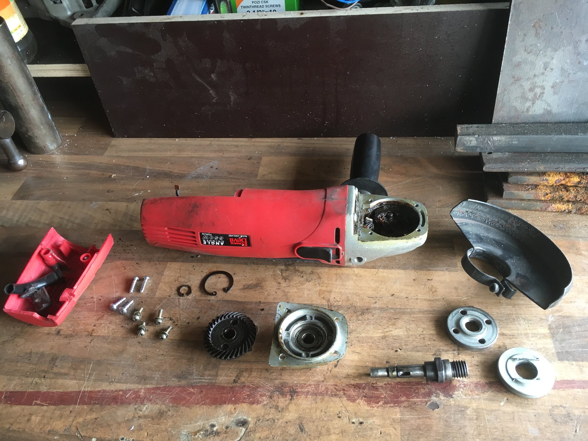

post 7I have one out of a broken angle grinder and I use it in the pillar drill with a grinding disc for shaping.
get a knacked grinder and take the head of it remove the bevel gear and u have one ready made for nothing and it will fit in your drill
