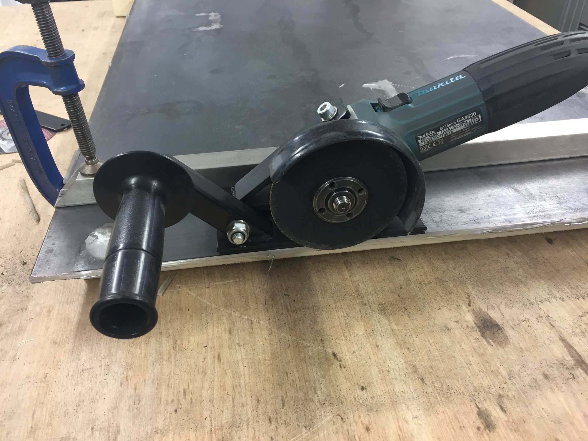

I bought one of these a while ago, does the trick. just clamp down a straight piece of anything and run it along it.Was thinking, would be pretty sweet to be able to make straight, long cuts with a grinder.

Where and how much?I bought one of these a while ago, does the trick. just clamp down a straight piece of anything and run it along it.
I got mine a few years back, I think it was american ebay and was about £20 all in with postage, used it a couple of times for doing steady plunge cuts, or just taking a light pass along some steel i want to bend, nice for when your trying to do really accurate work.Where and how much?

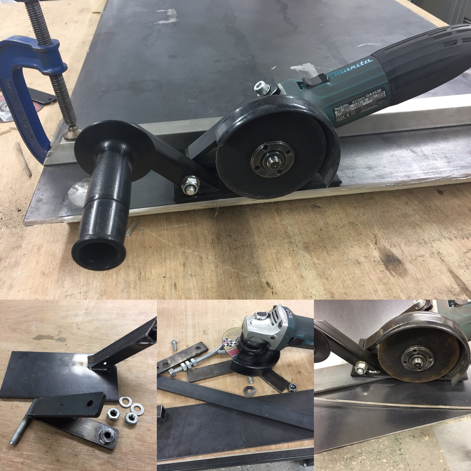

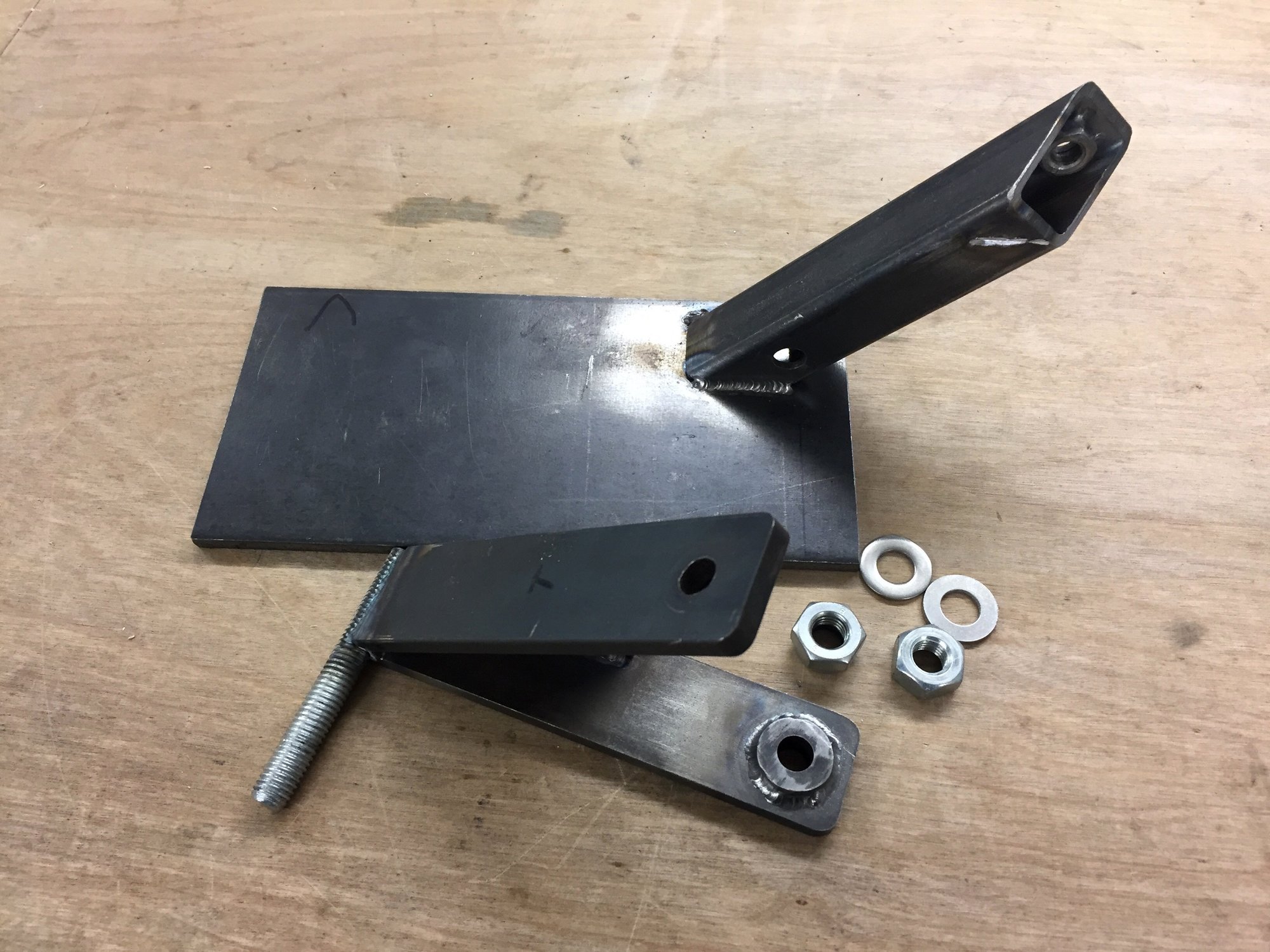

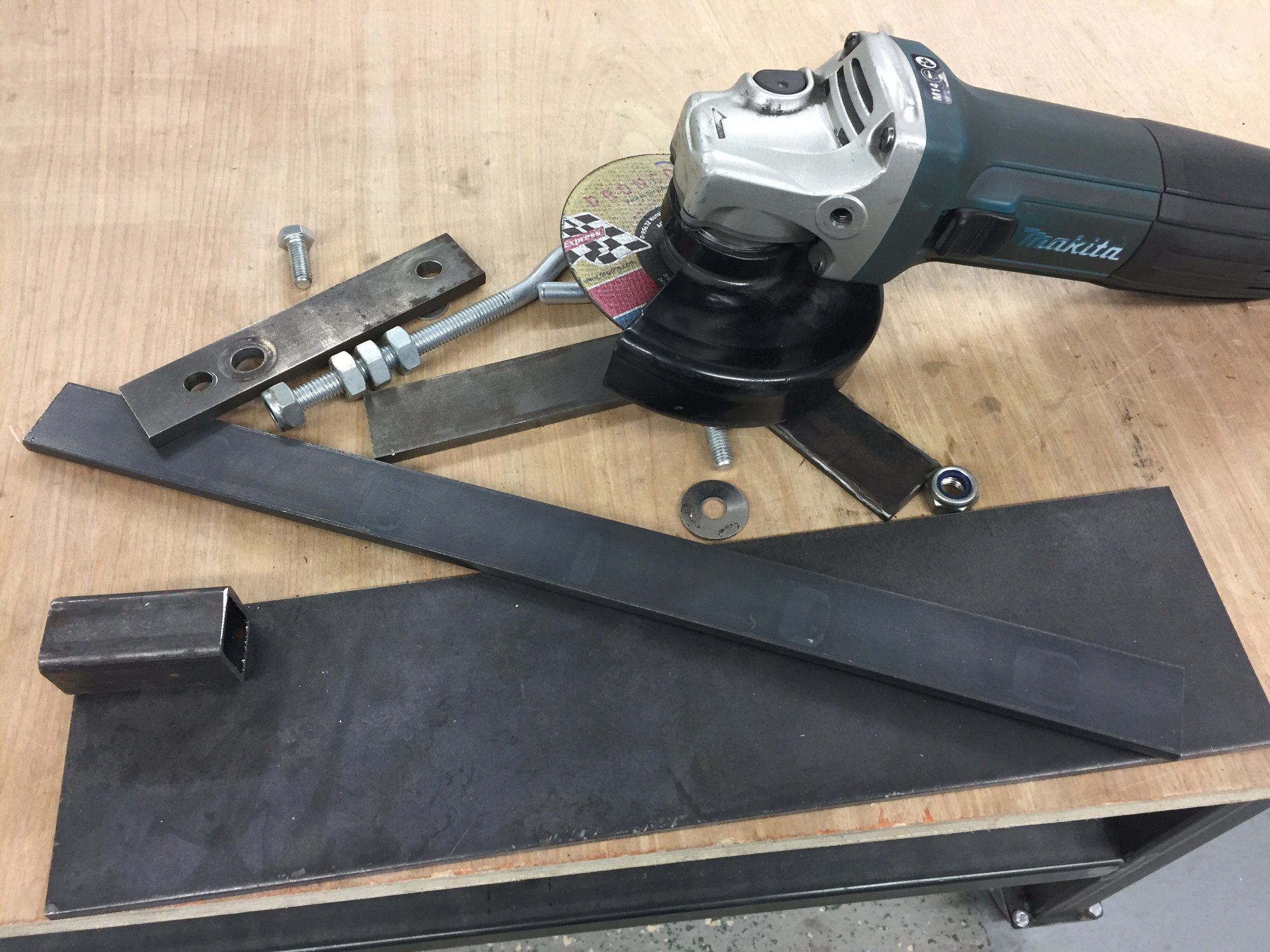

I feel a batch group buy coming onMaking your own ain’t too tricky. Bit of scrap and a couple of hours.

Just run the grinder disc along a flat bar to get it started.
