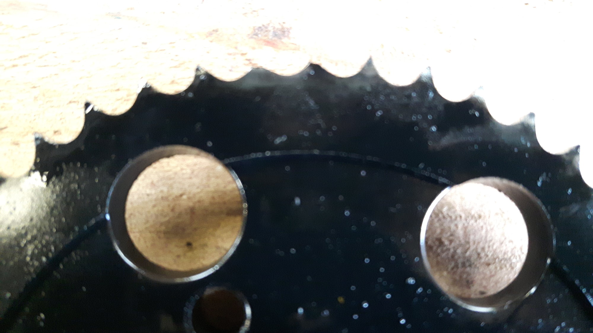

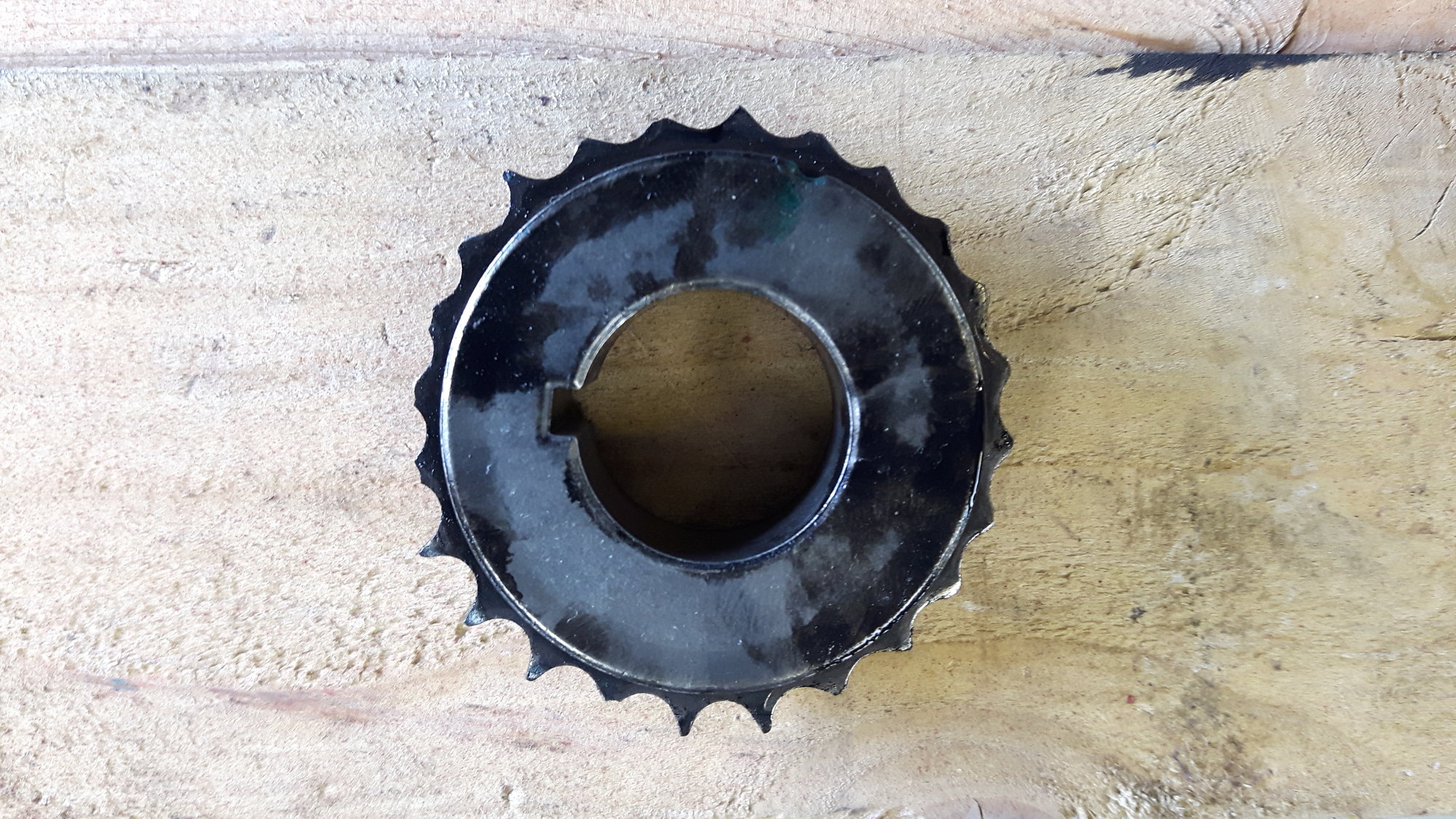

    If you can hear the chain rattle it is worn causing correlation issues, it would normally give either crank or cam sensor fault also, if it was a sensor that was the issue, but as it is just p0016 my guess is chain and the rattle could be pistons shutting the valves 20170813_144701.jpg 20170813_144714.jpg
    Here are some pic from a nissan navara with a p0016 dtc, there was only 5 full...ish teeth left on bottom drive pulley, and the others well you can see, it was not rattling too much the customer didnt listen and went to the ferry 150 mls round trip at 90mph in it the night time before I stripped it and took these pics that were taken when stripped . I said he should have put the lottery tickets on he was that lucky.
    that is the idea of p0016 it usually means both crank and cam sensors are working ok BUt they are not timed within specs
    i did a ford focus a few days ago there are three different dia timing pins for the crank stop one 5mm and one 8mm long and short and ford cant tell you which is required I used the 5mm as usual but it threw p0016 after 10mls, I had to retime with the short 8mm so the difference was 1.5mm !!
