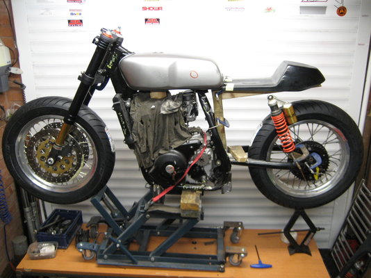

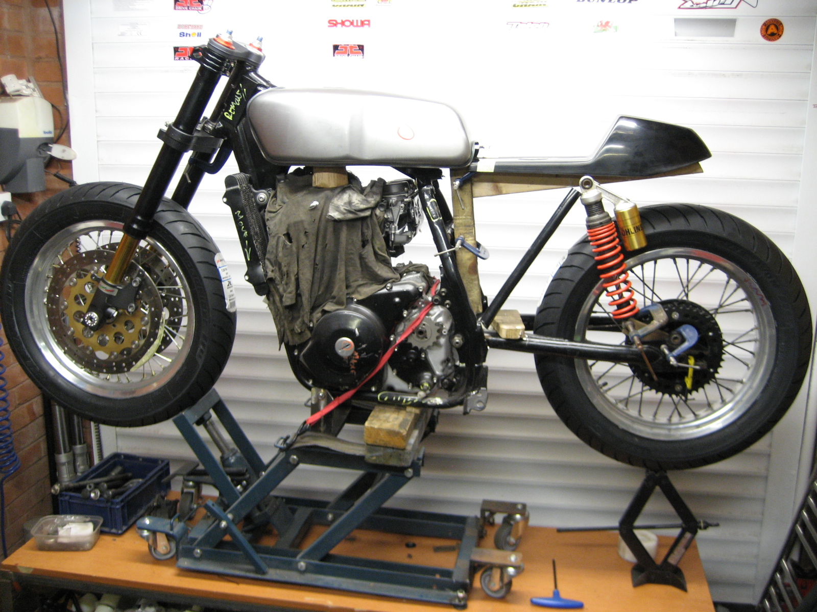

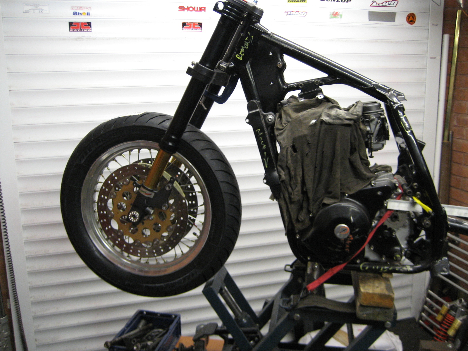

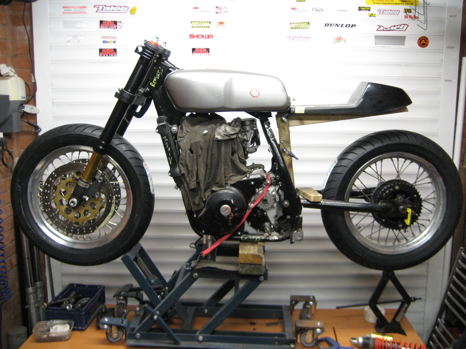

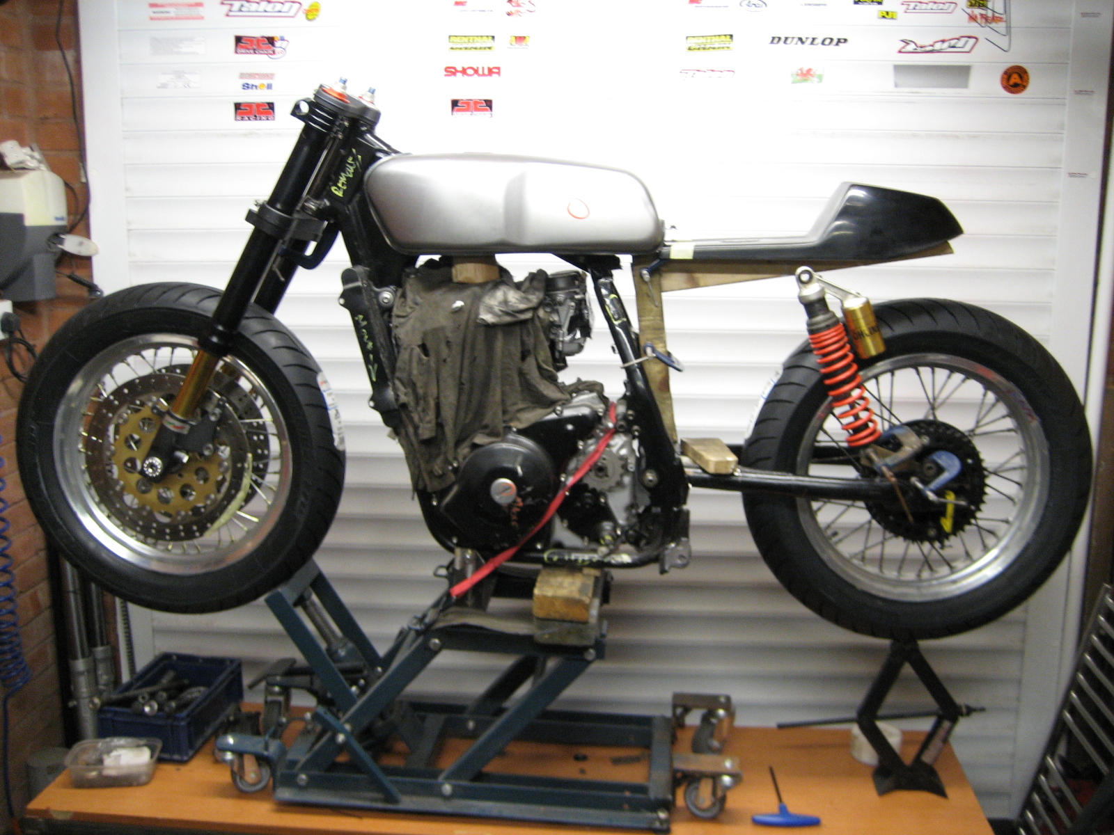

Stepped plates for the calipers?
Do those Nissins have a separate system for the linked brakes?
Ill be making some solid brackets out of 15mm aluminium.
The brakes do indeed have separate ABS chambers but can be easily sorted with some strategic drilling ......ive used them in a past project (post#127 here): http://www.mig-welding.co.uk/forum/...g-wreck-rescued-from-the-spiders.44354/page-7
