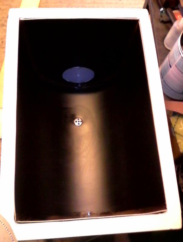

Had more of a play today, fitted a door on the unit to stop it all falling out and filled with 10mm gravel. I had to see if the action works and here we have it:-
It needs guards on the motor section, could well just sheet it up and leave a door in one side.
Tempted to leave it running for an hour to see what falls apart?

The gravel is also sandy or very bitty, it could do with washing the stone bits down to remove the sticky stuff from it.

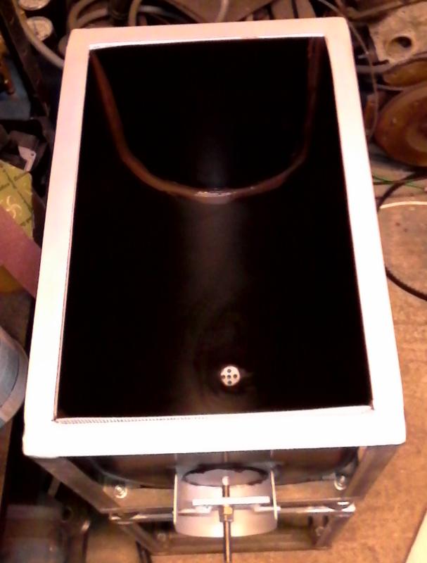

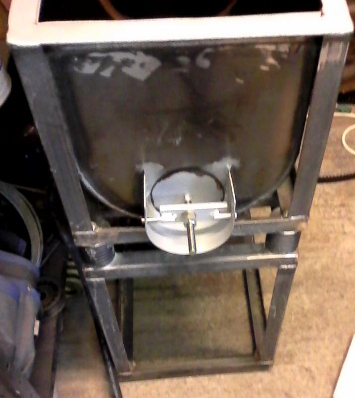

I need to add the water drain to the bottom, in mine I think it will be in the middle due to the weights at each end. Even the few minutes I had it running showed how it cleaned the sheet in the tub.

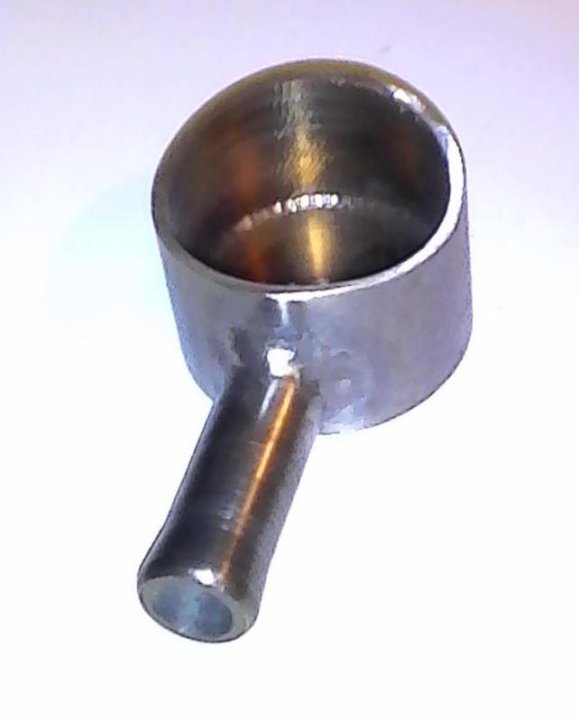

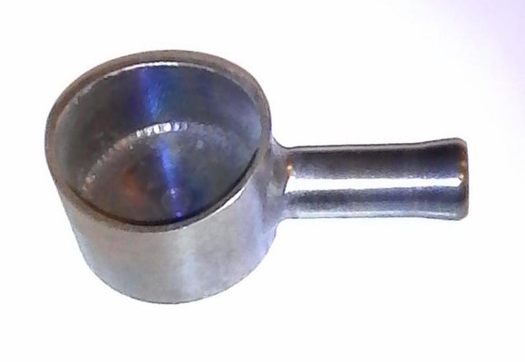

Here is the drain ready for the bottom of the tub, it has just under 10mm bore, so if I drill 5 or 6 mm holes in the tub, I should be OK to get the slurry through. It will go onto some 1/2 inch tube to drain, all I have at present is some either very large fuel, but suspect heater hose, if I can get some 12mm or 1/2" clear tubing I would be happier as it would allow be to see any build-ups in the pipe before it gets blocked. The drain is also shaped a bit so I can TIG it to the round bottom of the tub.
A bit of an under cut there, must be more careful, more filler!

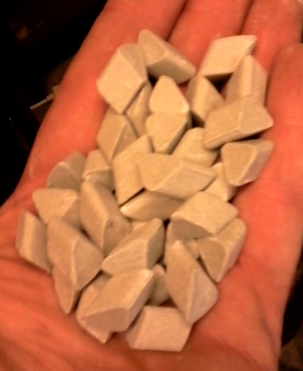

Little bit more today. Managed to get the 25Kg of ceramic media 10 x 10mm off-cut triangle and some PVC conveyor belting for the inside.
Could not get any media compound as they only sell it in 25 Litre tubs and I think that would last me out so need to either come up with a DIY solution or initially just use water.
Anyway here are a few more pics. This showing the water outlet, it is tie rapped to the top frame.
End hole is sealed to stop the liquid coming out of the plate until I can find a thin 100mm O ring. The media, hope it is worth it?

I was surprised how quick they clean stuff up. I had read that i might have to run the one i have for a couple of days to get any sort of result.
A couple of hours seems to do the job fine.
What i have been doing is using a pretty rough ceramic to get most of the rubbish off then swapping over to a different ceramic to get a better finish.
With the side door it only takes a minute or two for it to empty, then put in the other ceramic.
25kg of ceramic fits nicely in a 25l drum with the top cut off.

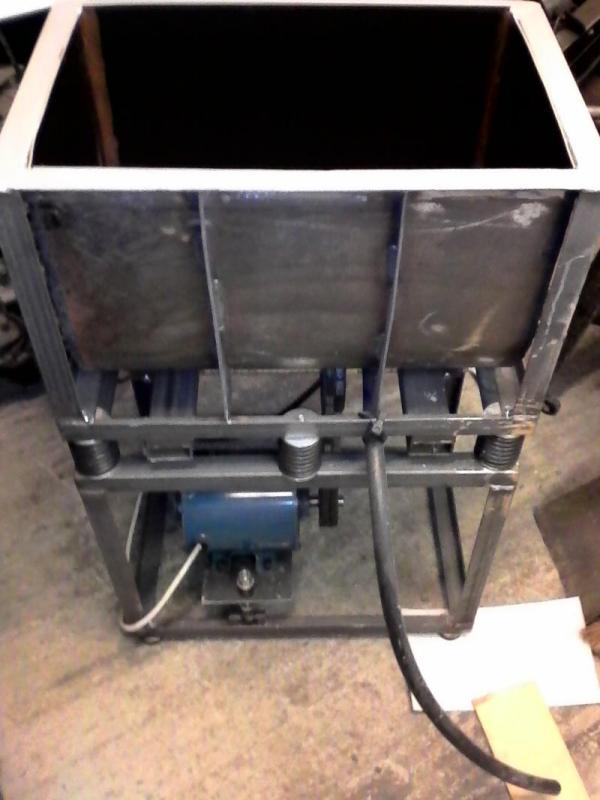

It is big enough but sometimes not always big enough. I guess I could have used a shot blasting cabinet for finishing of the bits but, I do not have a big enough compressor or space for the blast cabinet and the rest of the gear. So using it in anger now, have welded up some 1.6mm sheet to the base on the sides and back, the front side is still open until I get some hinges and catch.
Need some anti-vibration pads, the tar style, stick on variety similar to the type used in vans of old.

It has been running for an hour and I went back in the workshop to see how it is going and I have had to power it down as the motor is getting hot.
It is only a fractional horsepower motor, so when cooled after tea with try again through a watt meter to see what the draw is, but guess an upgrade is required.
Nope, one could build a hood or box for it to live in and include some sound deadening like foam around it, my plan is to move in into my small room in the garage and set it going on a timer when I am not there.
I have replaced the fractional horse power motor with the 2 HP 3 phase motor I purchased off eSCHen. I already had the pulley adaptors for it when I got the pulleys, I had an idea I might need to do this. I also bought myself another VFD from Ebay. The units at under £80 for 1.5KWh. I have two now one on the mill and one for the tub. Watch out for the type you get, some are just VFD's some are VFD and PLC built in.
The latter is now on the tub and means that I can set the unit going and after a set time it shuts down, so I can set for 30 mins, 60 mins, 2 hours etc. It also has a relay output that I think can drive the liquid pump so I think I can have that on a timer as well. The downside is the manual is not that easy to follow.
The motor is taking just over 400 watts from the mains so around 1.7 Amps, measured it with one of the small Maplin meters one can buy.

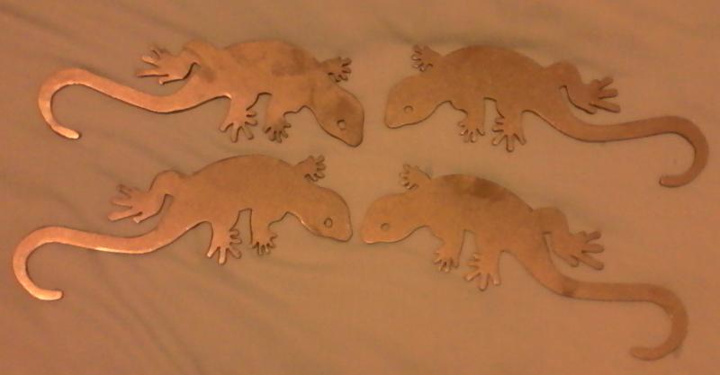

Last bit of Plasma cutting was 4 Lizards, used the flap disc on them to remove the kerf then a soak in acid to remove the mill-scale then a tumble in the tub, just had 30 mins but the edges are being de-burred or becoming less sharp, needs more time but not tonight.
