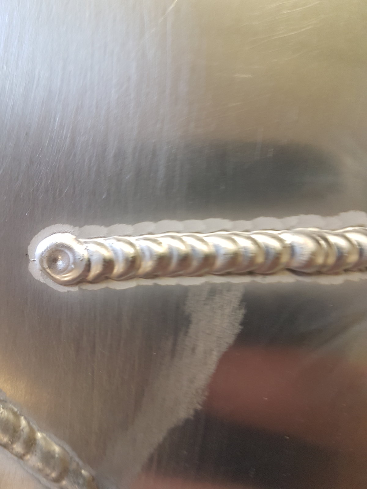

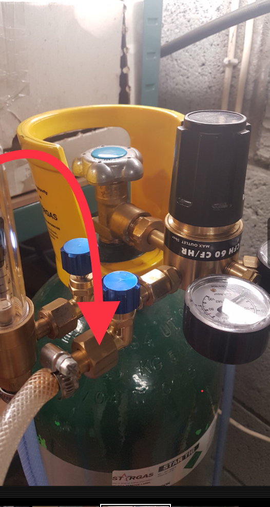

Just eliminate the possibility mate. Less joints, less places for suspected leaks and stick your flow meter straight on the reg out let.It's a back purge line that's not in use
Ha ha. World of difference.Got a new bottle today and this is the first weld think we found the problemView attachment 139115
no gas splitter im gonna put it on and see if it changes anythingIs that with or without the gas splitter ?
Looks nice now!
One of the connections may have been leaky,
Bang the old bottle back onto your new set up to eliminate the gas
as you changed two things
That’s very unlucky, starting out with AC tig and getting a bad bottle of gas.
Glad you’ve got it sorted.
Now show us your fillet!
