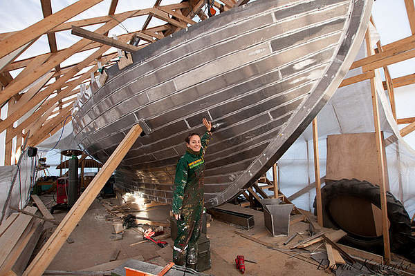

If you go over to the US WeldingWeb forum you can see the whole write up from the start on this sail boat! It is fantastic - fully seam welded with Tig!

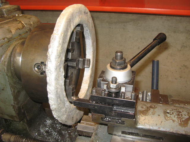

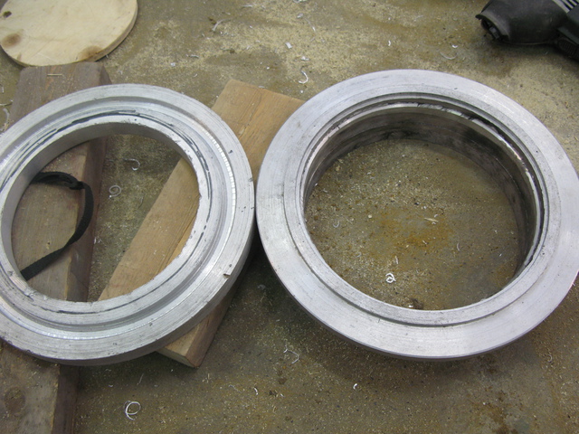

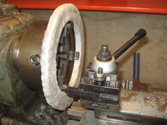

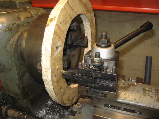

Last two months have been spent doing foundry work (melting
aluminium). We are now making our own portholes and all small bits and
pieces out of the all the scrap alloy we have floating around. Next
would be to make a few dolphins for decoration :-)

a. making a sand-cast for a small porthole.

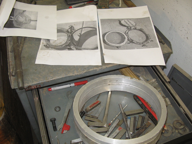

c. a cake? Nope. Its called cores and used for foundry work! Its a
miks of sand and linseed oil. Taste awful, but works good.

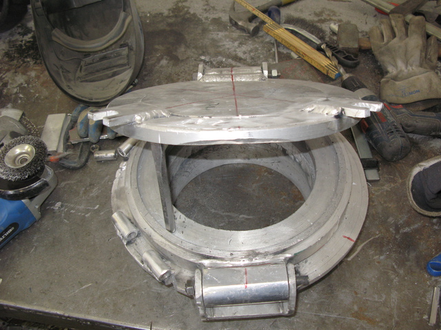

d. welding small boxes and stuff together.

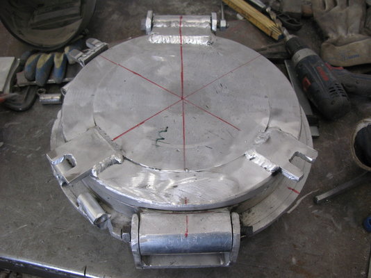

e. Porthole production.
